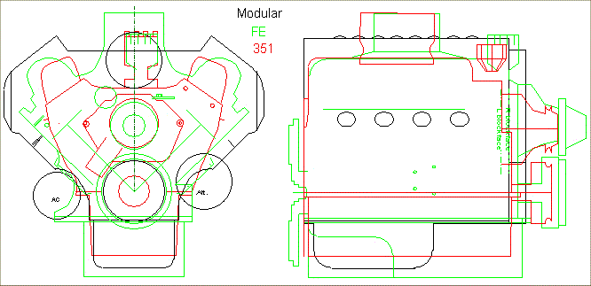

    Do you plan to notch/modify shock towers? I've seen one
    Comet/Maverick w/ FE motor; as I recall he did not have any mod's to the towers. If I hadn't seen that car -- would not have thought that motor fit in these cars w/o tower mods. The car was at the MCCI Roundup a few years ago in Dayton, OH. and was bought new by owner.
  8. mn67
    mn67 Member
    Feb 24, 2017
    80
    30
    Great white north
    Not sure what they did but those towers have been moved. I am finishing up my FE/Maverick build and the valve covers are 2 inches wider that the towers. I have seen pics of that car before and it is very well executed. I started mine thinking it would shoe horn in like that.

  10. Krazy Comet
    7,574
    2,337
    A 460 is even wider than 428.
    That's the reason the '70 Mustang Cobra Jet was a 428, while '70 Torino CJ used 429. No I ain't talking 'bout Boss motors.

    Wish I could see it in person, looking at dimensions it just doesn't seem possible. Now saying it isn't, just seems too big to fit.
    Hotrock and Krazy Comet like this.
  14. Hotrock
    Oct 27, 2012
    1,467
    713
    313
    Munroe Falls, Ohio
    Those are great diagrams!!! Of course the 302 is narrower and lower than the 351W and considering the angle of the exhaust ports on the FE facing more downward it just might fit in a Maverick or Comet without shock tower modifications.
    BTW I've seen the FE Comet in question twice and have talked to the owner twice. As Everett states according to the owner/builder no shock tower modification were performed.
