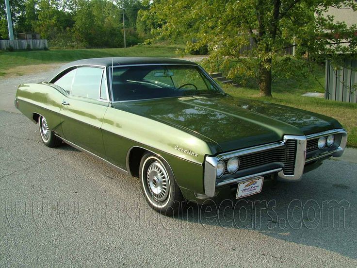

    Not dogging on anyone who likes them etc Honestly. I just dislike them because of the large over hang, they look like Pontiacs
    just 'gaudy' in my opinion in this aspect. My neighbor has a Grand Prix like this body style. I know some Fords had the same kind of look too. Something like this
    which isn't bad IMHO as I owned a 400 (not a 351M) that looked just like this car for $400 and tightened the starter bolts up on an original 11,500 mile 1 owner car. Would burn the tires off the ugly beast from straight to sideways up hill. I think if someone was to shorten the over hang 'nose' on a Comet and sucked the bumpers in tight they would look a world different !!! I hate they got sooo much more in options then Mavericks ( trim, cooler looking tail lights, and etc.
