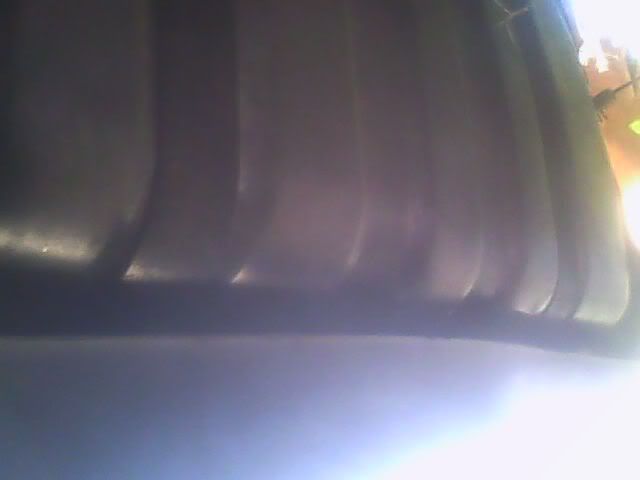

    I couldnt get my camera working, but i got some cellphone pics. When i get the camera working ill post close up pics with a ruler. Anyways there is 3/4" of clearance between the tank and the valance. And 1/2" between the straps and the valance. [​IMG]

    I went to the junkyard and got the valance off a 71. I came home, sanded all the paint off and primed it. It bolted up just fine and cleared the gas tank. In this pic where the valance bends is where its stamped for the plate. Like all of them are. Last time i checked Ford never changed the body dimensions during 71-77, so my 75 shouldnt be different then any other year. [​IMG]
  9. Jamie Miles
    12,099
    Alto, GA
    I've had a few
    Yours looks fine. I've seen some that didn't.
