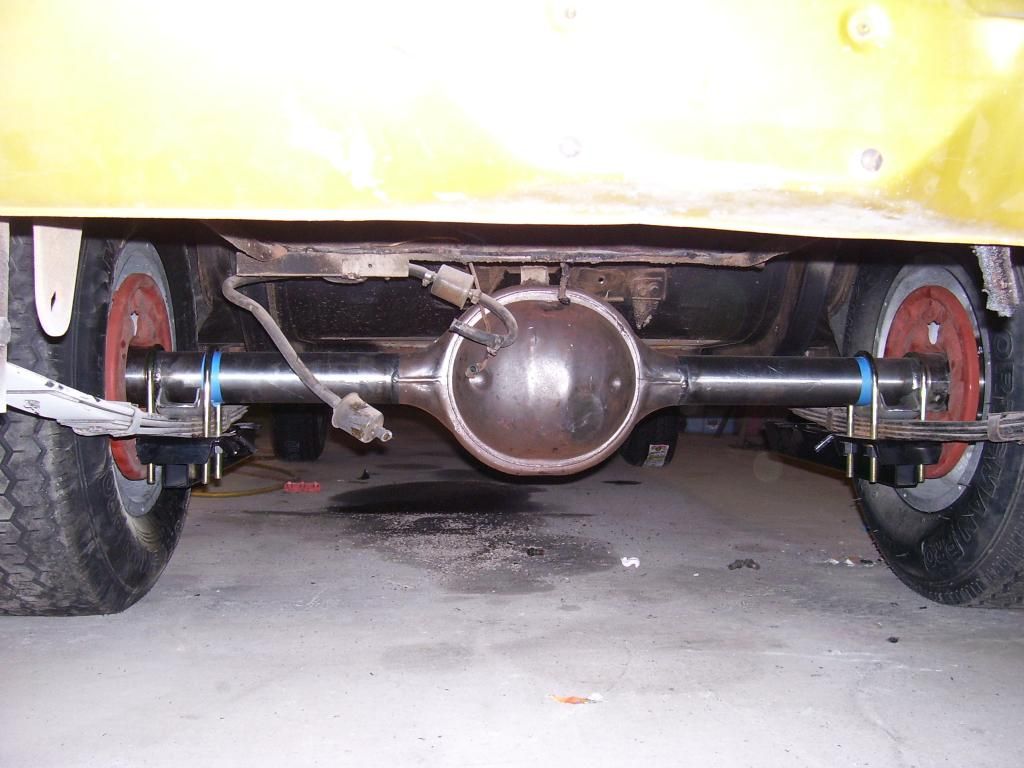

    You can get a 29x12.50/15 on a 15x11" wheel on a Maverick and meet the 1970 Pro Stock rules. No mini-tub, no relocated leaf springs. Here's mine with a stock rear suspension with a custom made 9" to fit the wheel offset.
