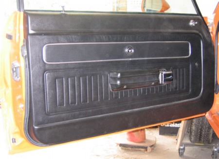

    71 73 mustang armrest
    but keep in mind that the 71 73 mustang armrests are compatible with deluxe door panels. (not normal because there are also other armrest that is shorter and is about equal
    in the following images you will see that the armrest is the deluxe longer than normal. if you have deluxe panels so if you take the 71-73 Mustang
    deluxe door panel
    normal door panel

    OK. thanks, looks like I have the normal door panel. I guess I'll have to keep looking
