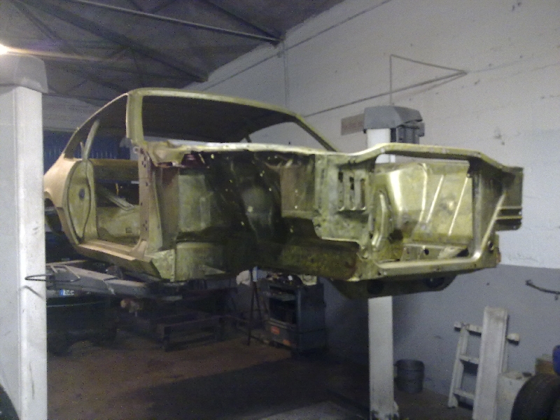

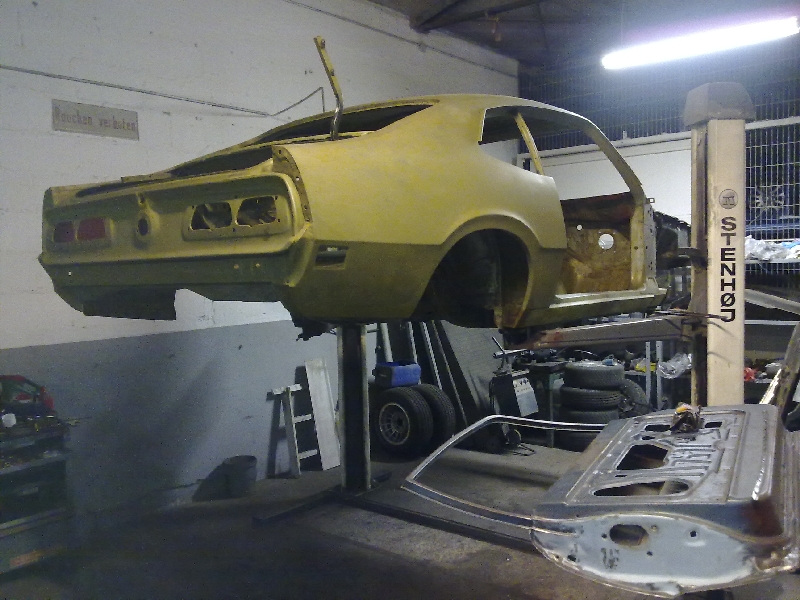

    the body is nearly done. here's some pics of it waiting for paint, covered in a zinc primer:

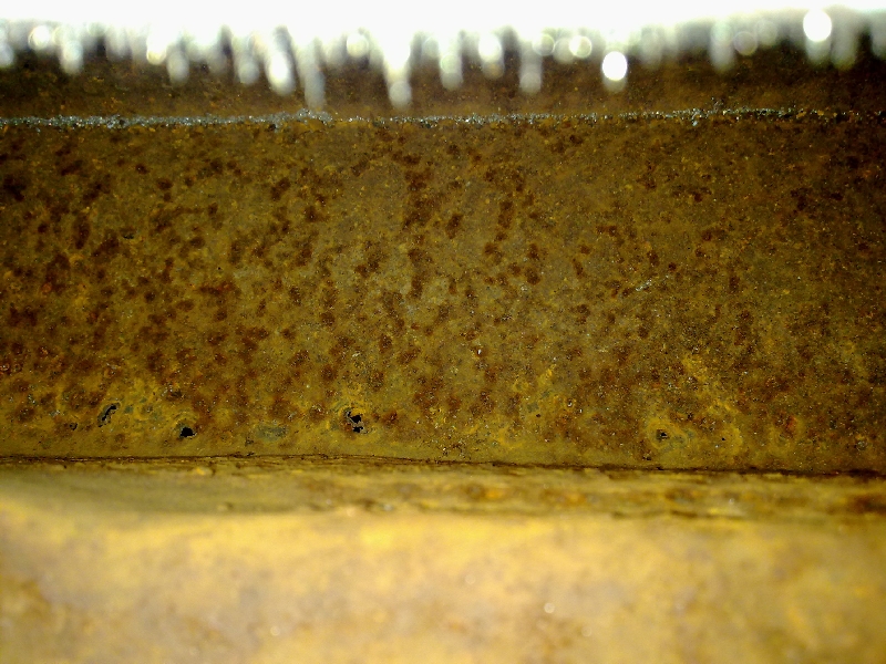

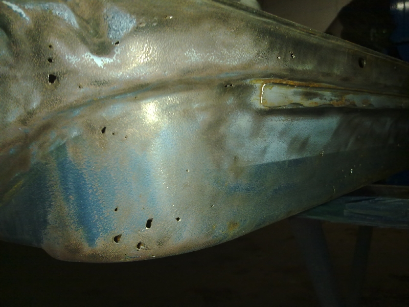

    i also had a very rude awakening. that was when we inspected the new doors more closely. the bottom is very thin with lots of tiny holes. impossible to weld, as that would only rip up new ones. back to the drawing board, i guess... :(

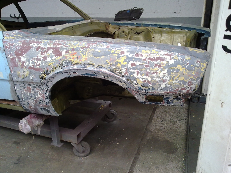

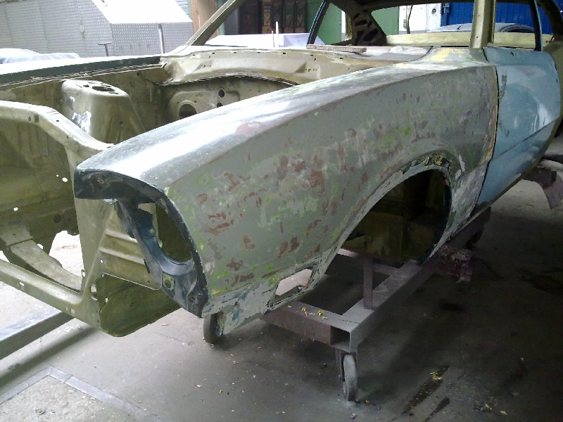

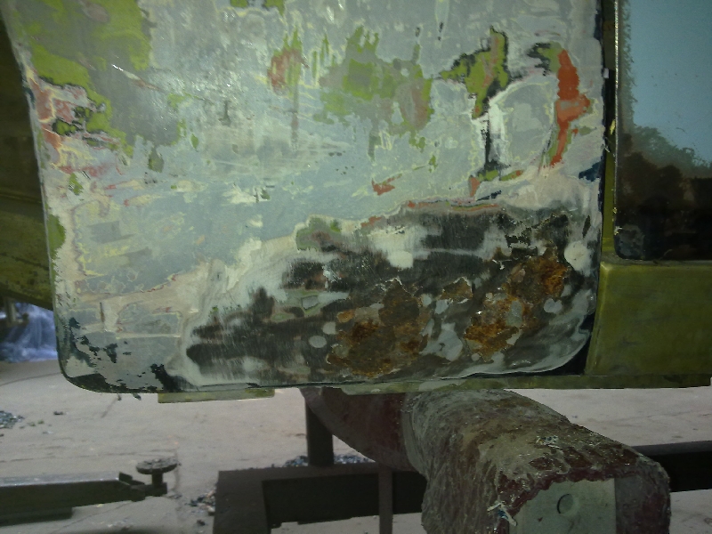

    still no paint...
    some more things had to be prepared, especially fenders. found another rust hole on the bottom of the driver's side. passenger side is already a later year replacement part. i haven't got a clue what somebody tried to do to the hood scoop - cut a hole in it?
    i'll strip down the hood next weekend...

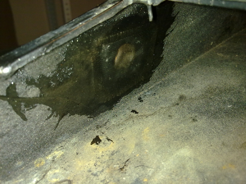

  9. blugene
    10,776
    I see what looks like a crack. I have the same thing on both sides. Is this common? What do we do to fix it?

    not a crack, it's the metal brace that is welded to the cowl vent area. here you can see it completely taken apart:

  11. blugene
    10,776
    Hmmm, I guess I will look at mine a little closer. Maybe mine is cracked but not yours. Now you got me hopeing that it's not as bad as I thought :)

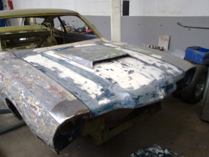

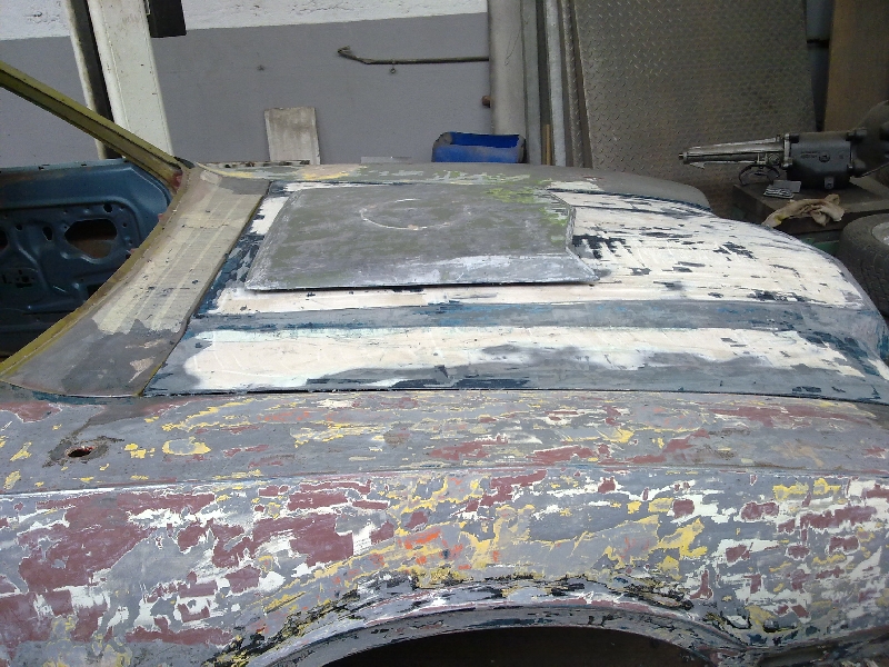

    started stripping the hood this weekend. only found minor rust spots on the lip, i guess it's an easy fix.

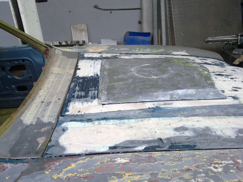

    i found no green under all the bondo - it must be a replacement hood, just like the pass side fender. scoop placement is an issue - here's what it looks like in the current location:
    shouldn't it be more like this?
  14. CaptainComet
    5,018
    458
    I agree on the scoop placement needing to be further back. Maybe someone here has the right specs for it.
    You got lucky on the hood ... a lot of rotten ones out there.

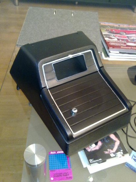

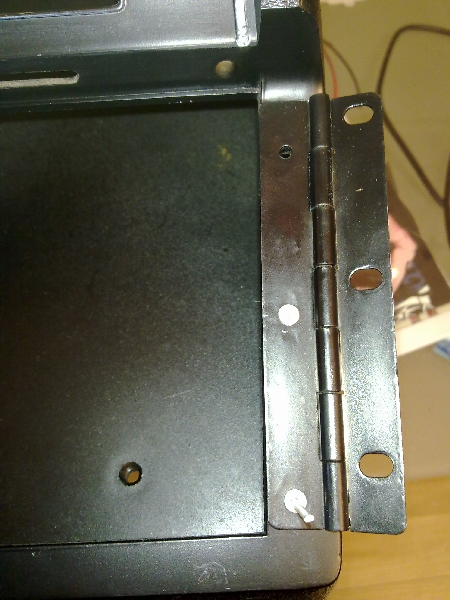

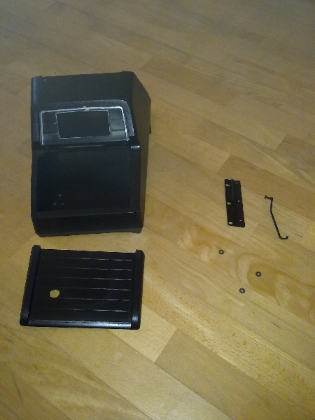

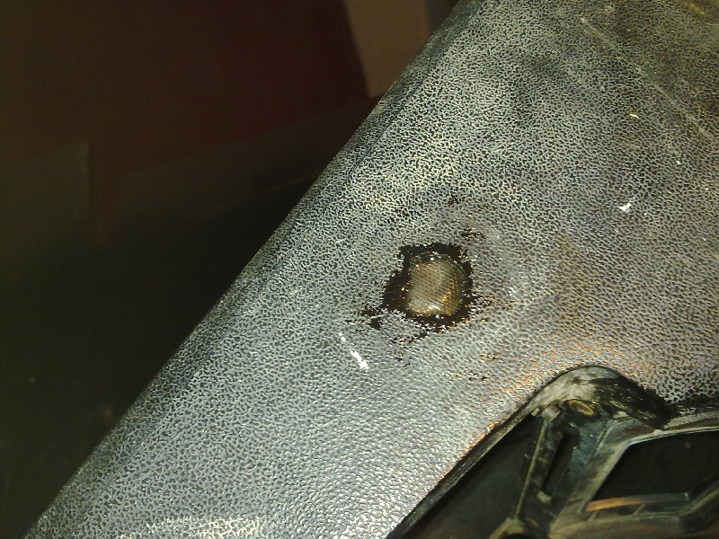

    in the meantime, i touched up my consolette a little. it had a hole in the side, suffered from a sloppy lid and was in a bad shape in general.
    filled the hole with fiberglass:
    took it apart completely, even cut off the hinge, and painted it:
    riveted the hinge back on:
    and now the only thing i need is a clock!
