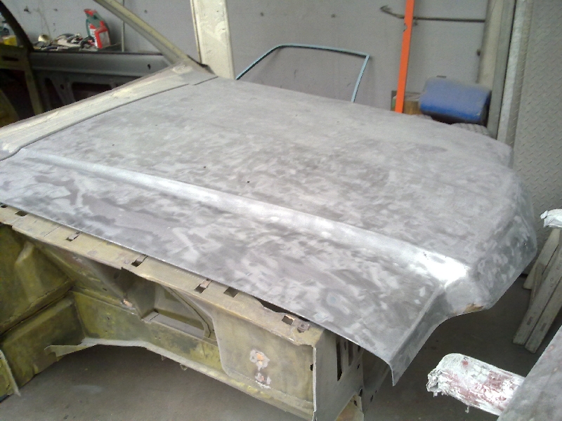

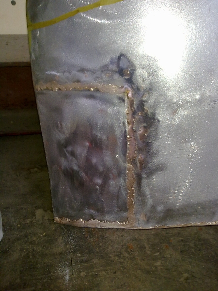

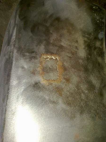

    hole in the fender fixed, antenna deleted:
    hood completely stripped:

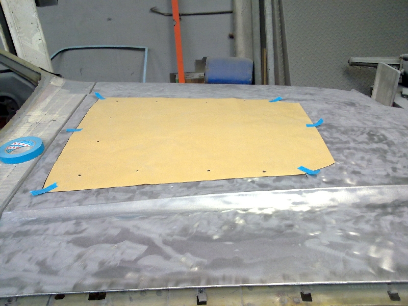

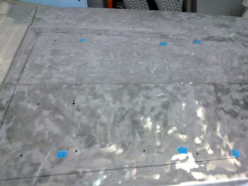

    I can give you ball park on the scoop location. These are the measurements taken off of my original 71 GT hood before I replaced it using the original scoop.
    Rear Outside Hole: From side of hood measure in 13 1/2" and will be located 3 3/8" from back edge.
    Front Outside Hole: From side of hood measure in 12 15/16" and about 24 1/8" from rear of hood.
    I made a template of the hood scoop out of card board with the holes in it and positioned it to do the actual marking on the hood. It's easier to work with than trying to do it with the scoop. Laid the scoop on the card board with the studs and used some of the wife's lipstick to help mark it (Caught all kind of crap for that).
    I would recommend getting a step bit to drill the sheet metal if you don't have one. They work great and don't tear the hood like a regular drill bit would.
    - Matt

    the cardboard template worked out really well:

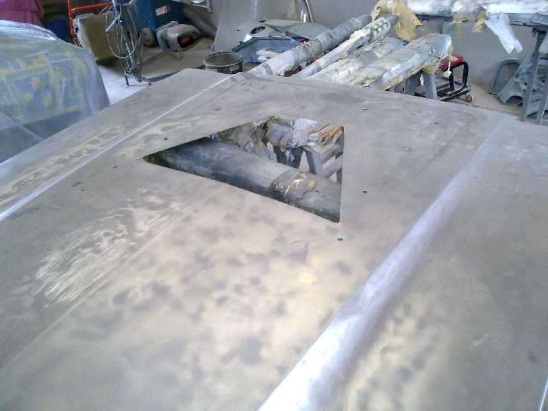

    i also marked the area which i'll cut to make the scoop functional:

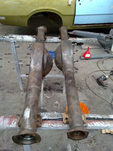

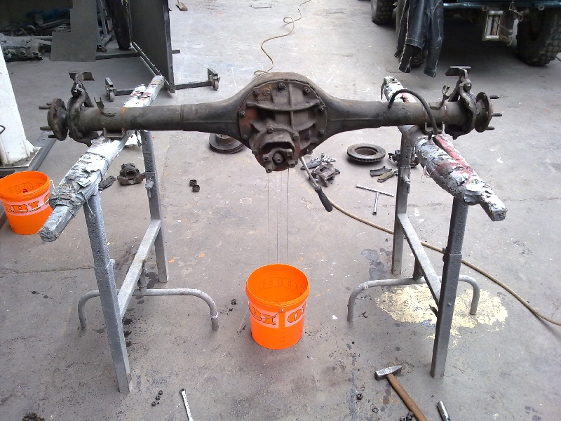

    tore the rearend down today. it seems that the axle still has the low versailles gears - 2.75:1. i'll try to figure which ratio will be the best for both the 347 and the fairly high german highway speeds of usually 80-90 mp/h.
    i got rid of the custom made parking brake brackets welded on the axle tubes, the whole setup will be done properly this time. right next to it is a 4-lug 8" rear i got from chandler years ago. funny how small it looks in comparison. it will finally go under my mustang this spring!
  6. mav1970
    Looks good, Thomas.
    Just remember when you say "low gears" in reference to the 2.75 ratio, you really mean high gears. The lower the ratio the higher the gear number will be. I think my Versailles rear had even higher gears than yours. Something like 2.55 or something.
    I had 3.50's in my 9 inch but just bought a set of 3.89's to better suit the Comp cam and dual quads now in the Cleveland :yahoo:
  7. tody
    tody Member
    Apr 12, 2008
    1,843
    230
    cologne, germany
    yes, you're right on that - high gears, low ratio :thumbs2:
    i ran the numbers on a web calculator - at 3000 rpm with 235/60R14 in the back, i will be running 80 mph with the 2.75 and 75 mph with the 3.00. not much of a difference, but the car will see the autobahn quite often. one of the teeth of the ring gear is broken, so i guess i'll have to change the gears anyway...

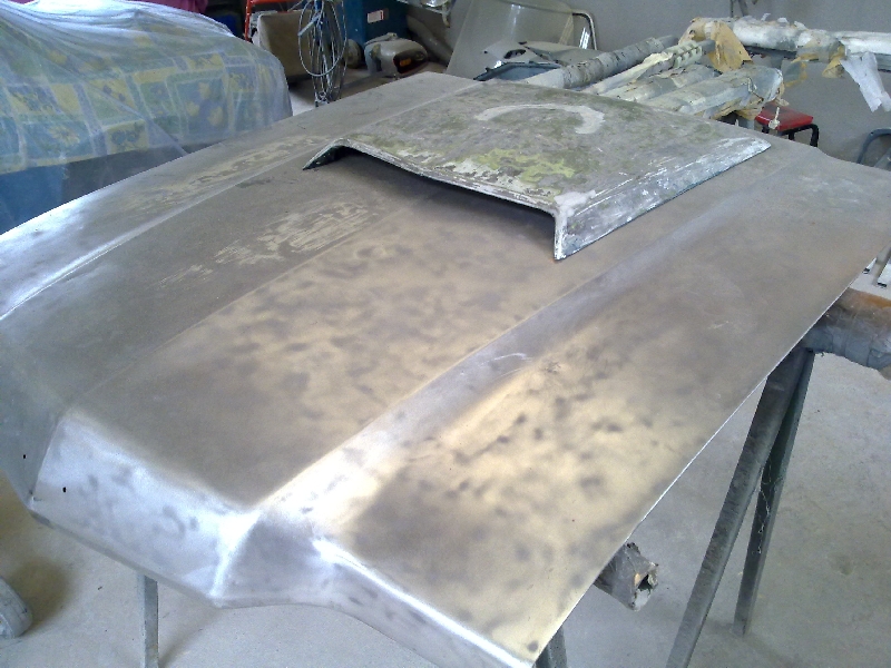

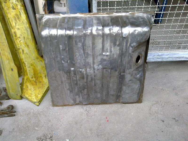

    hood scoop is now functional and sitting where it belongs:

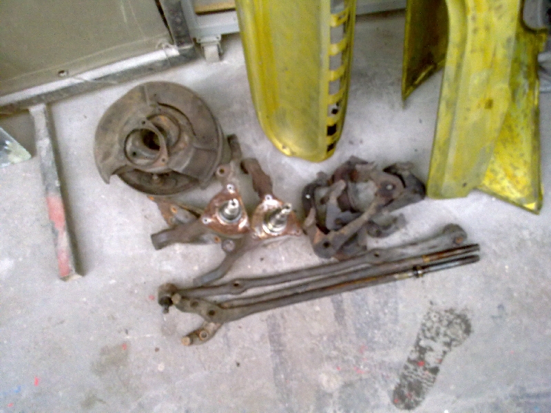

    front steering and brakes are now completely disassembled. tank was cleaned up and is rust free!
    two questions: what about the gaskets between dust shield and spindle - are they available new? the rubber bushing between center link and pitman arm - is there a replacement?

    I made my own gaskets for between the dust shield and the spindle.
