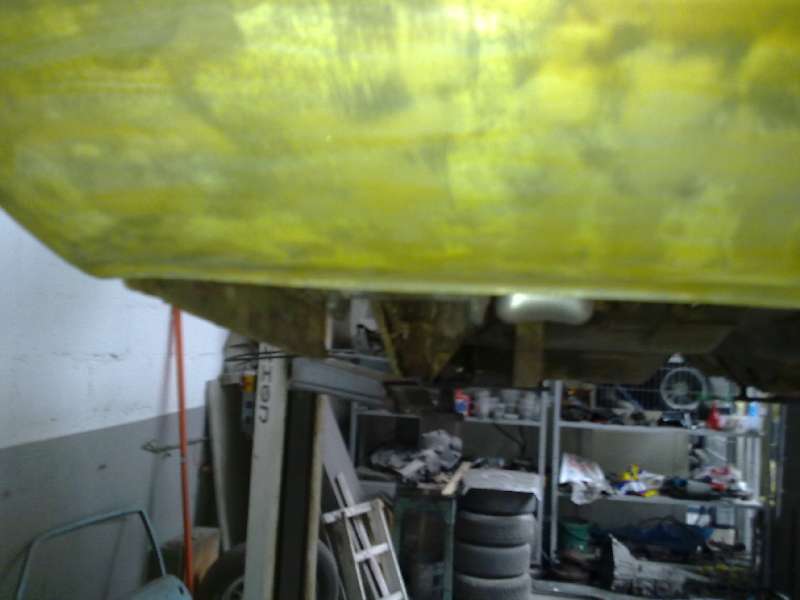

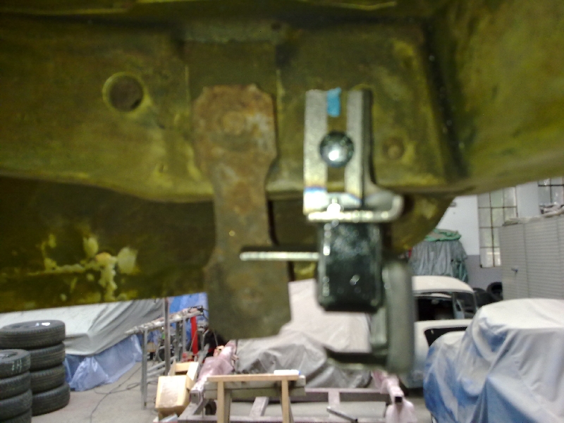

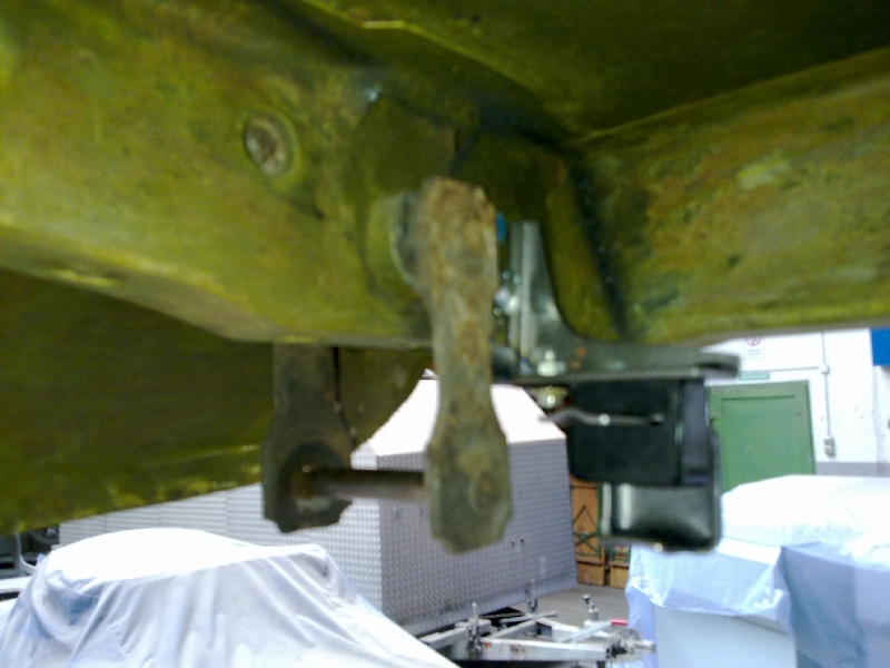

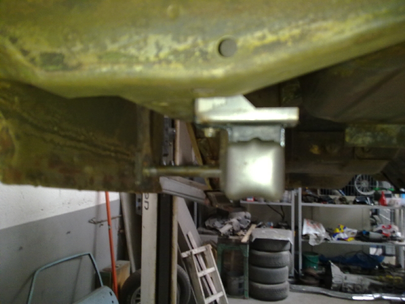

    started preparing the dual exhaust system today. i got some 67-70 mustang exhaust hangers from a friend, guessing they shouldn't be too far off. they consist of an l-shaped bracket which is mounted to the rear frame rail. on the mustang, it is mounted in front of the shackles - but there's no room on the comet.
    the package stated that the left hand bracket is shorter than RH - but i still had to cut it down and drill new holes in it to clear the tank. put them a little further down so it will clear the rear valance.
    here's some pictures:

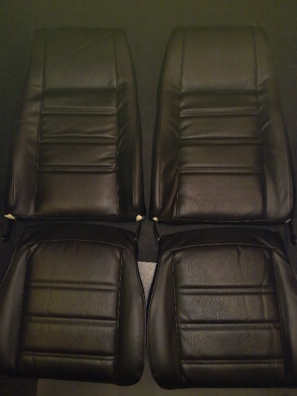

    there's something i have to declare: I HATE HOG RINGS! :banghead:
    the front seats did turn out quite nice. my fingers still hurt, though.
    before
    after
    i gave the backseat to an upholstery shop as the mustang seat covers need some alteration.

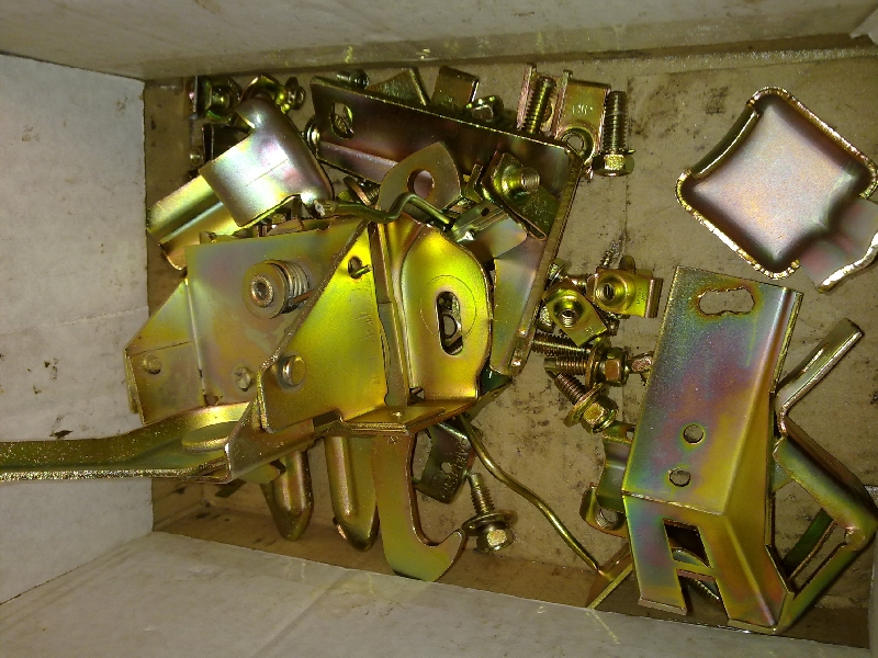

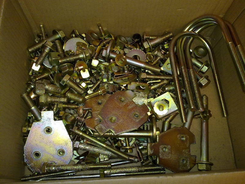

    got some more eye candy for you! i had about 20 lbs of screws and small parts cleaned and zinc plated.

    How do you know where they all go?:D
    i bag and tag every bolt...and i still have a hard time putting them back in the right place.

    made some pictures before ;)
    i also have the shop manual and the car master parts catalog, that'll help me. and all in all, there aren't too many different bolts on the car! the car was literally screwed up before anyway, so i'll try to get it all sorted out.
