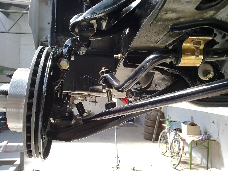

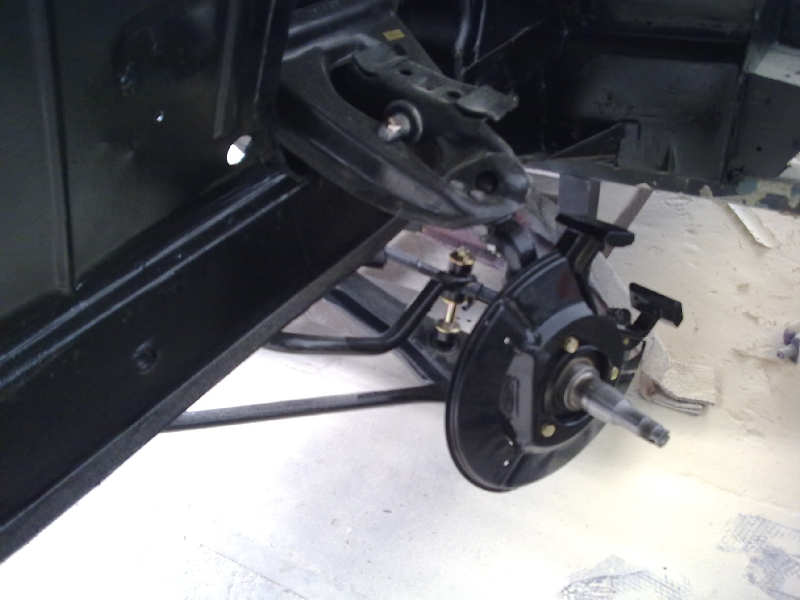

    front suspension and steering:
    with disc brakes:

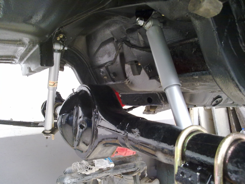

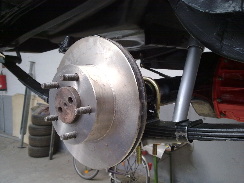

    rear axle:
    again, disc brakes:

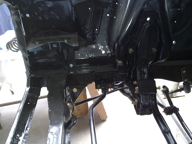

    battery tray and motor mounts in place:

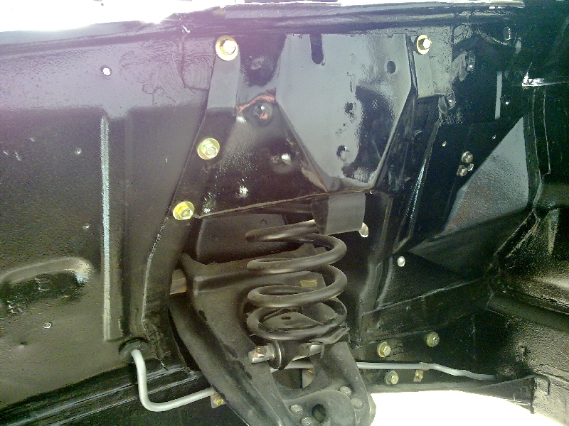

    more work done. i'm definitely not working full time on the car, but whenever i get into the flow, i get quite a lot accomplished ;)
    front springs are in now:

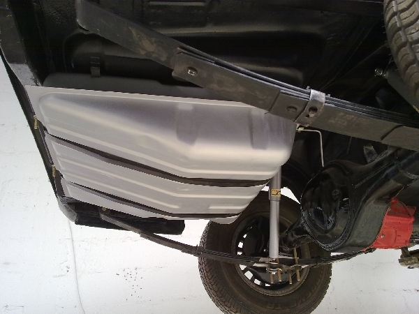

    cleaned up the tank vent line - looks pretty good with all the zinc plated parts:
    gas tank is also in place:

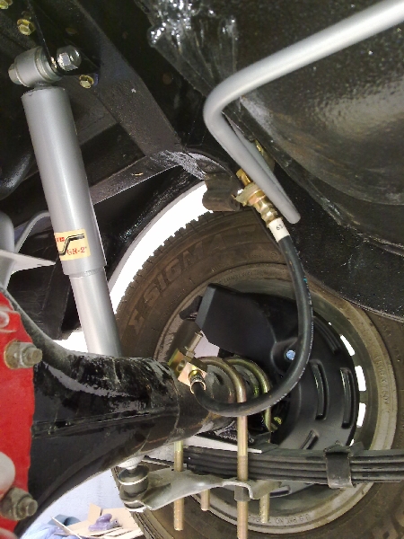

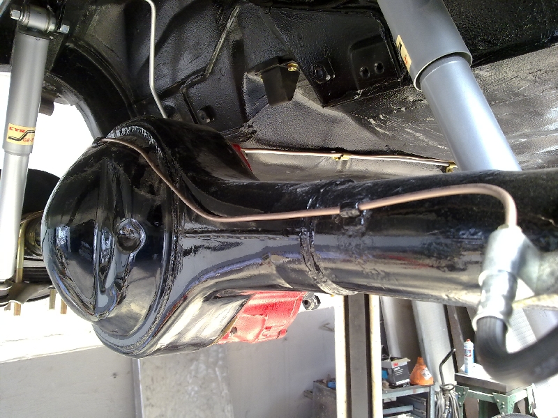

    rear brake hose and more parts from the versailles brake, the dust shields are in:

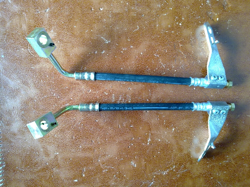

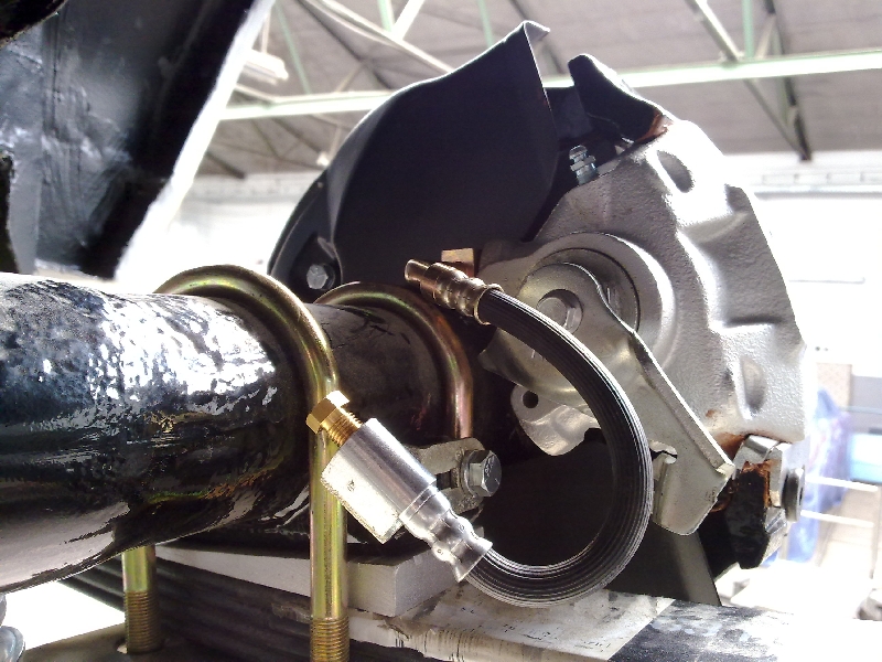

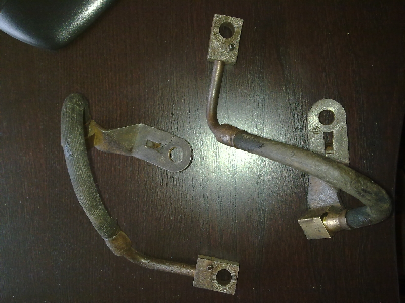

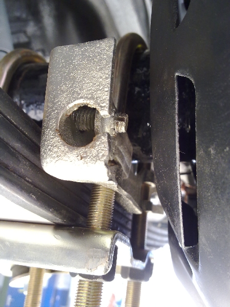

    talking of the versailles rear brake - the hoses are out of production, and i was stuck with this:

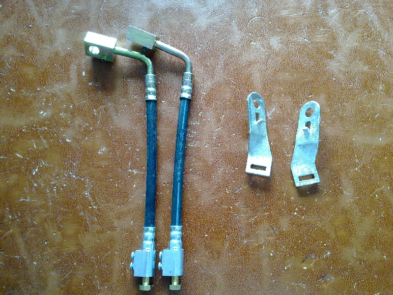

    luckily i found a seller on ebay - brake hoses unlimited - who will build you any brake hose you want. but beware - the rear brake hose bracket is unique and you will need to reuse it. so i cut it off, opened up the mounting hole a little and had them zinc plated. here they are together with the new hoses:
    the fittings are not pressed but screwed in - looks fantastic!
    more to come, maybe i'll start with the brake lines on monday!

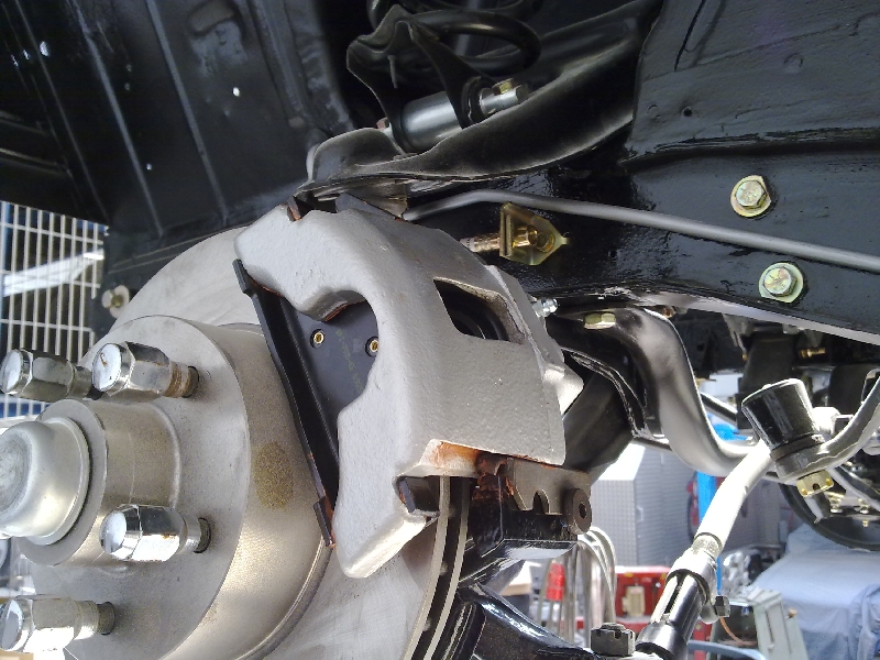

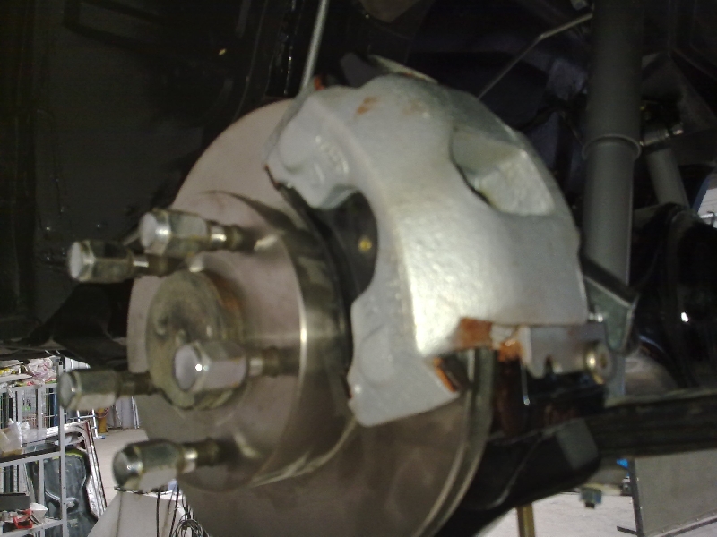

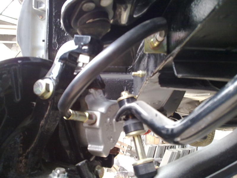

    spent a couple of hours on the brakes today. calipers are mounted:

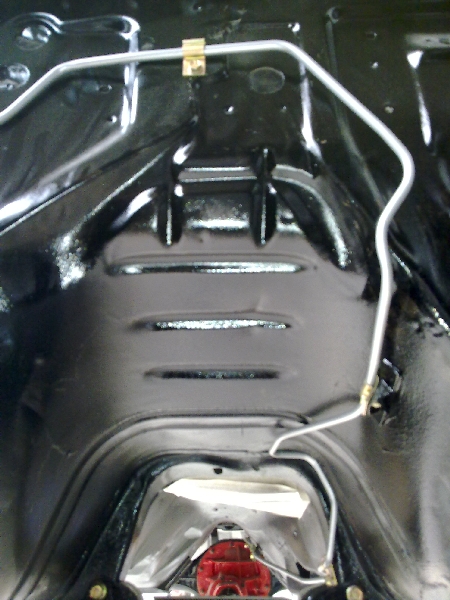

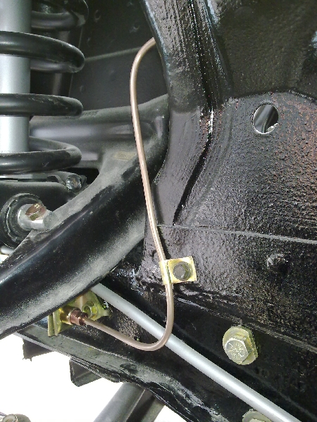

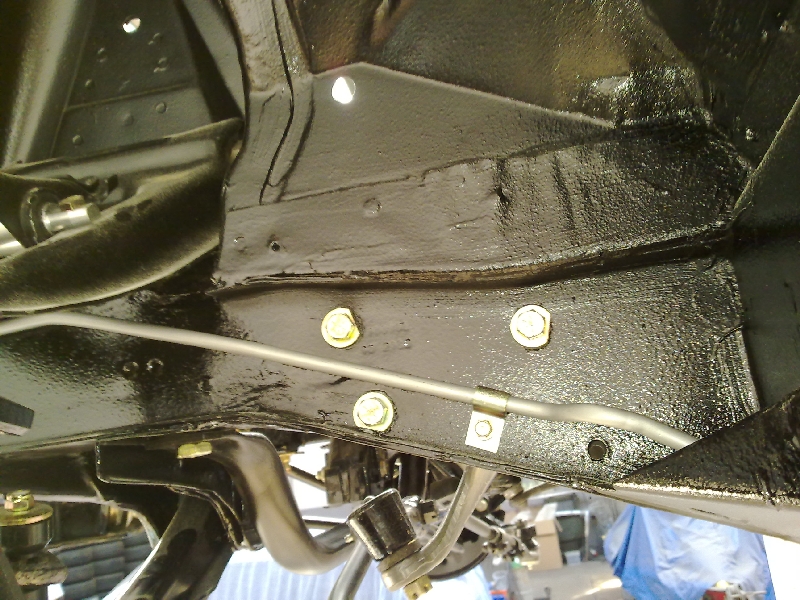

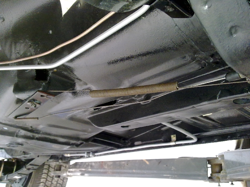

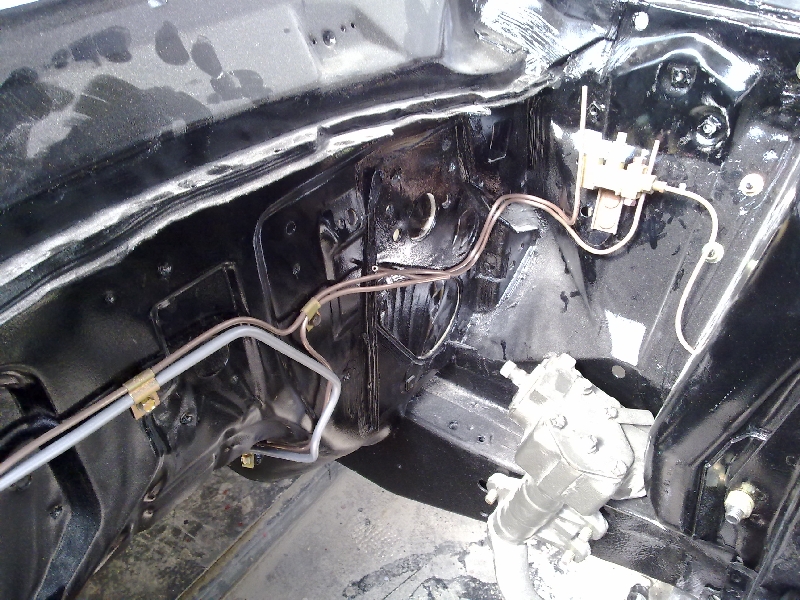

    and today i was able to bend and flare the brake lines. i used a really good flaring tool which made the job pretty easy. this is what i used for the brake lines, pretty good stuff and easy to bend: http://www.cunifer.com/
    i'm not completely done yet. i need to fab a bracket for an adjustable prop valve and also i need some more fittings...
    but i installed the versailles parking brake brackets, which i got from mean_maverick:
    more to come next weekend!

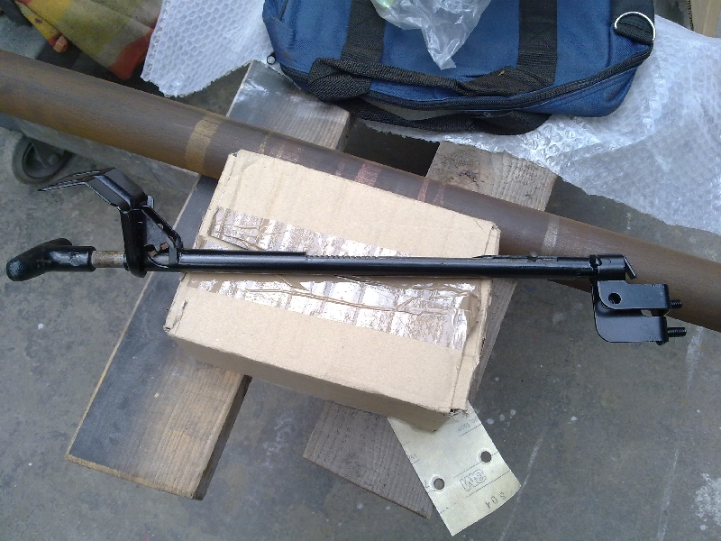

    the brakes are still keeping me busy...
    put the front parking brake cable back in:
    i also cleaned and repainted the handle:

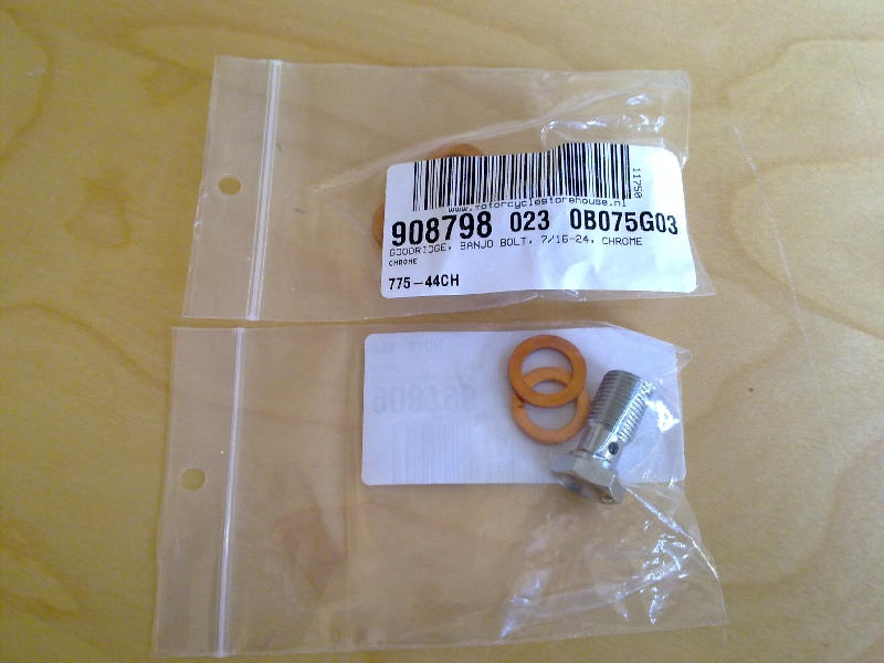

    the previous owner screwed up the versailles brakes big time. he used the wrong sized banjo bolts on the calipers. i have new calipers, but still had to find new banjo bolts. they have an odd sized thread, 7/16-24, opposed to the 7/16-20 UNF. but i got lucky at a harley shop:

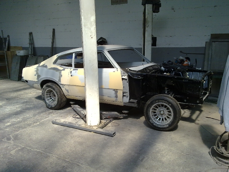

    oh, and i have a rolling chassis now :yahoo:
