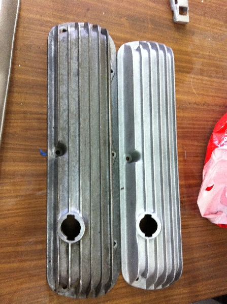

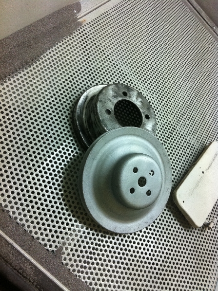

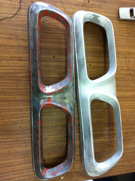

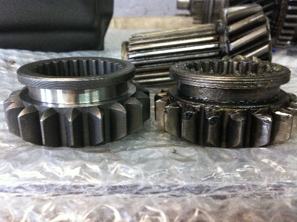

    but here's some more detailing, a friend of mine just bought a sandblasting cabinet:
  3. mav1970
    Nice Thomas :thumbs2:
    I worked for a locomotive rebuilder years ago and the one thing I really miss, from my days working at that company, is the Pangborn glass bead booth. I ran a lot of parts through that booth.

    bob, we did not use glass beads, but a mineral - 'corundum', does that make sense? i will have a hard time polishing the valve covers again, but i'll have them painted black and will just polish the fins...

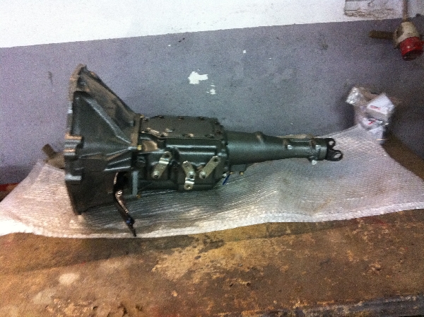

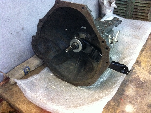

    in the meantime, i decided to open up the toploader again - to change out the reverse idler gear:

    What color did you use on the transmission? It looks great!

    i used VHT engine enamel, cast iron - SP997
    i also used that on my steering gear box.

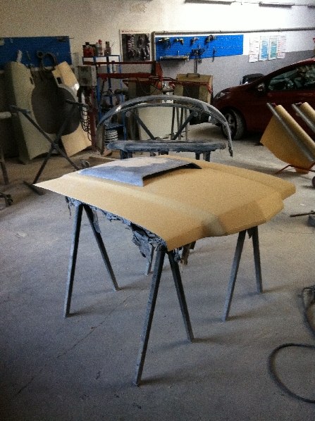

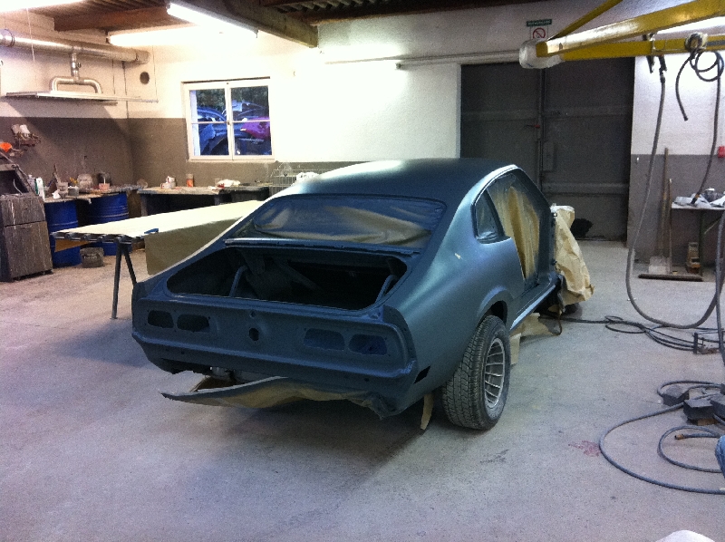

    preparation for paint is advancing in big steps:

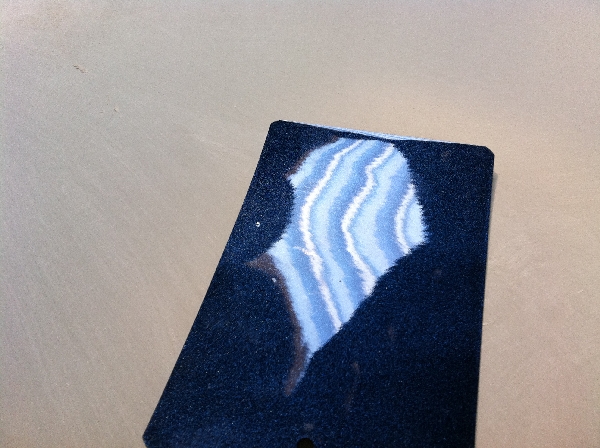

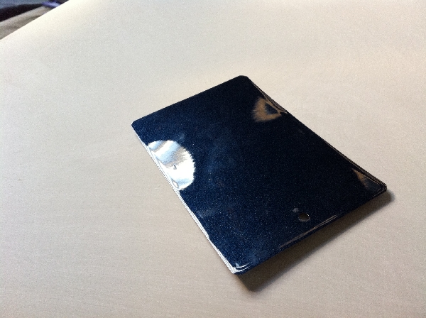

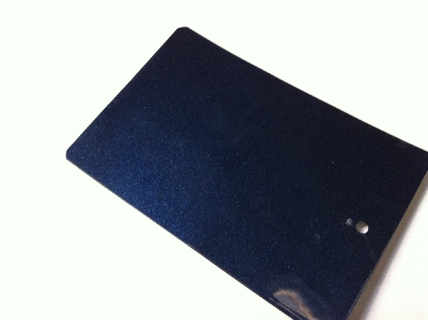

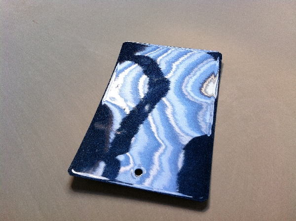

    paint samples are here! dark ford blue metallic, mixed after the original ford paint samples and codes:

    I like that color, it will look good!
  11. CaptainComet
    5,018
    458
    I had a 71 Torino painted a very similar color ... I couldn't help but look at it as much as possible if I was anywhere near that car ... you'll really like it. It is like painting a car black, but even more interesting because, it is just as shiny, but the blue highlights make for another dimension for you to study the lines of the car with.
    Like black .... it looks fabulous clean .... and you will know immediately if it ever gets dirty. With the level of detail that you are exerting on this car, I doubt that will ever be a problem.
    Are you striping the car? ... if so, what color?
    As always, I am thoroughly enjoying following your progress on the Comet. :thumbs2:

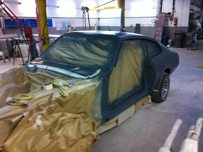

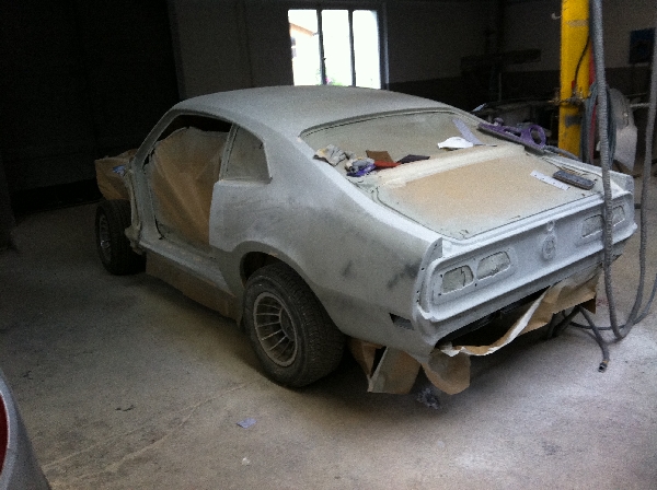

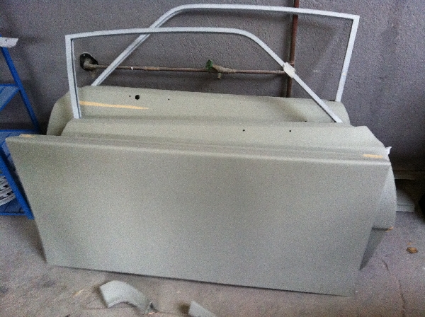

    here's more pics, body sanded and primered. don't know if i'll get stripes, don't know also whether to black out the taillight panel...

    Wow you taped the heck out of that.

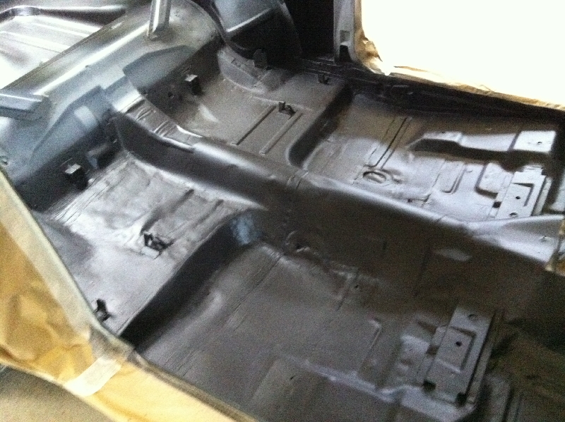

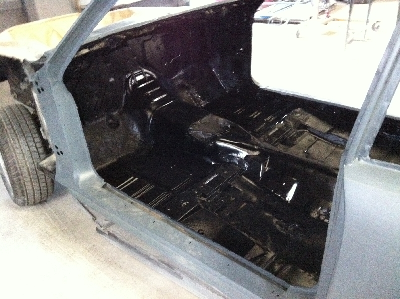

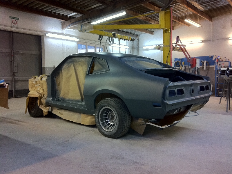

    a little step further on the paint job.
    inside covered with bed liner first, then painted black.
    i'll start to assemble the first parts tomorrow.
