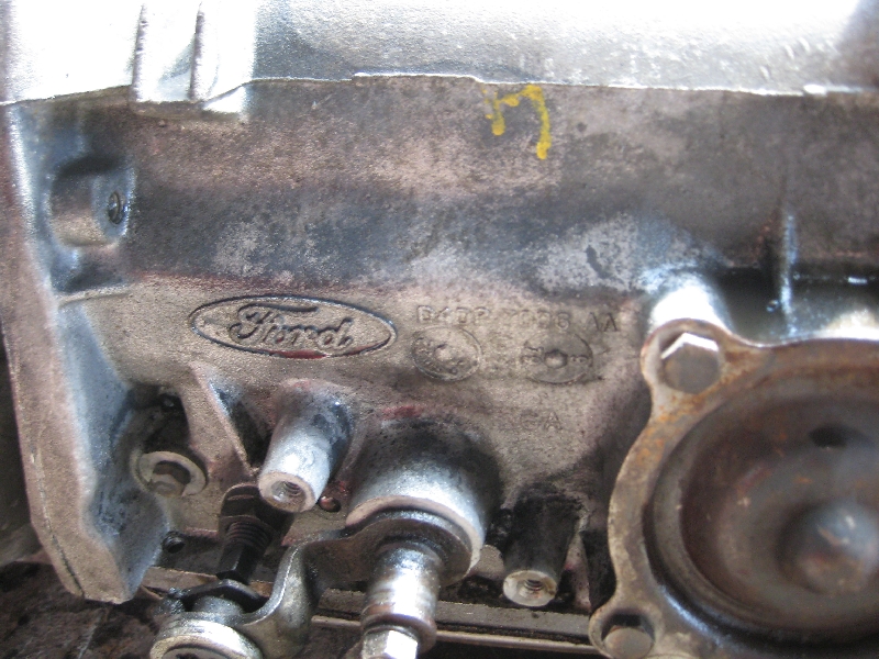

    here's a pic of the tranny:
    the shift lever seems to be one sided only. from what i've seen on the board, i need a two sided one. but the tranny will be taken apart completely as well - so i'll address this issue later!

  9. PaulS
    PaulS Member extrordiare
    May 3, 2004
    4,858
    Seattle area
    Flipping the lever only works with some of the shifters. With others the lever is too close to a direct push through the centerline to get it to move out of Park. The angles are all wrong to make the shifter detents line up with the transmission detents. You can almost always make a cable shifter work but the manual shifters are not as flexible.

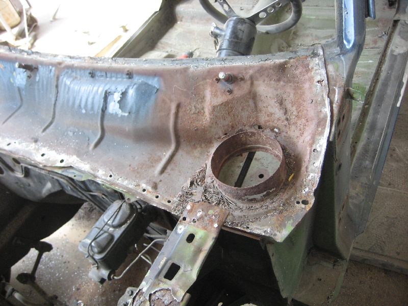

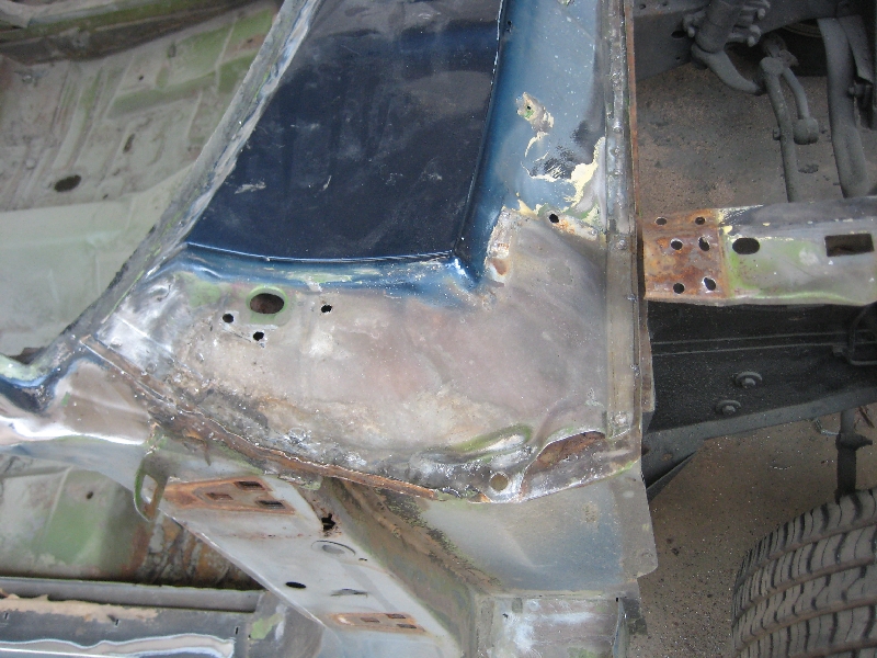

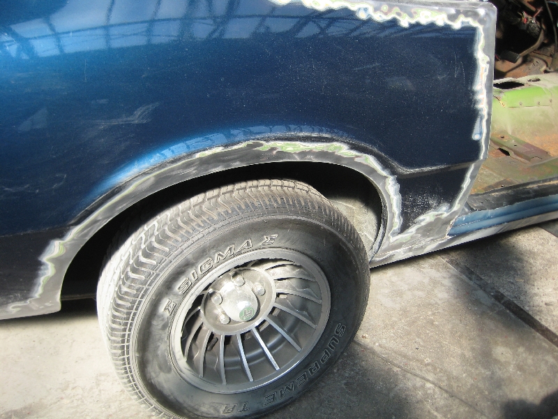

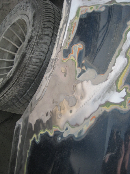

    progress, progress, progress...

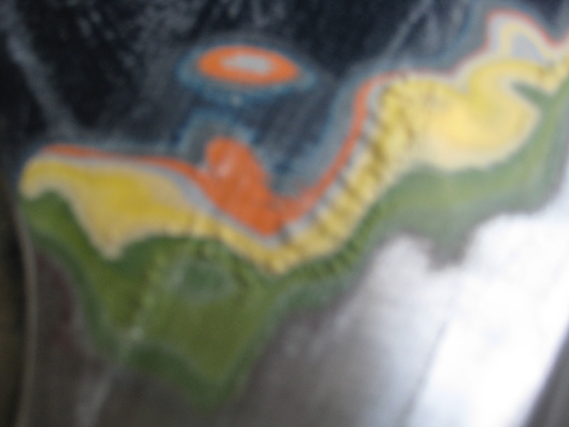

    started removing paint today. i discovered it's only four layers! :hmmm:
    first i started scraping it off manually in the corners. but for tomorrow i try to remove the big areas chemically.
    i also found a bad spot on the driver's side. looks like the car has been severly hit - and badly repaired. removed bondo about an inch thick.
    quarter panel skin is already ordered - are the rocker panels from autokrafters any good?
    here's the pics:
    more pics here:
    http://www.72comet.de/gt/index.php?id=25
    tomorrow i'll try to get rid of more paint and maybe open the cowl vent panel!

    Wow, not only was it four colors, but four COMPLETELY DIFFERENT colors! I'm looking forward to watching this project.

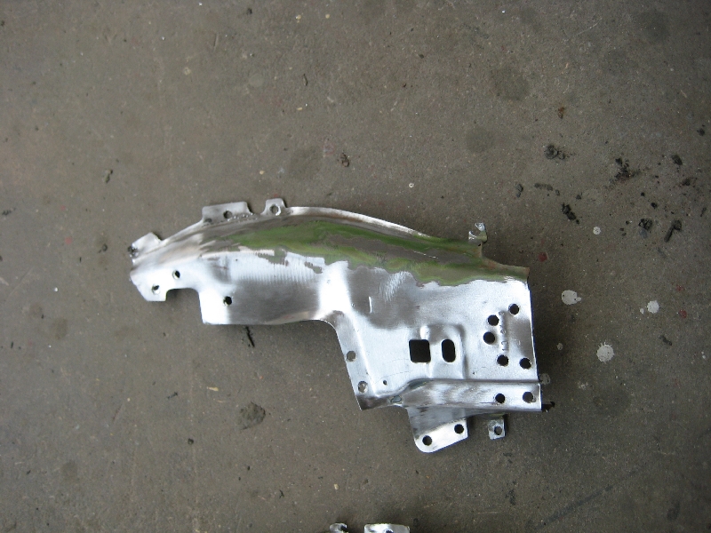

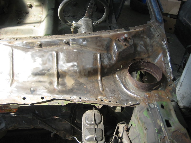

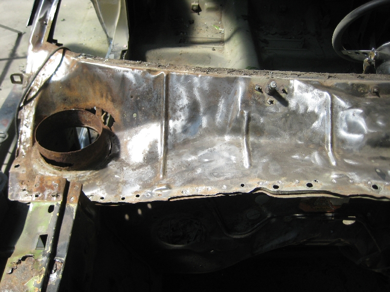

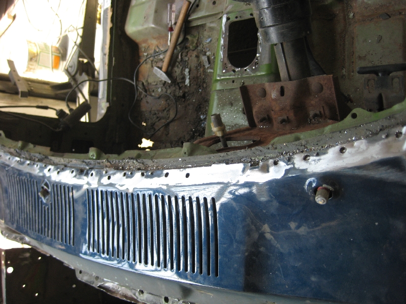

    i attacked the cowl vent panel today. during the process of drilling out the spot welds - a work i'm terrible at - i was cursing myself quite a lot. turned out that the thing can be done in two hours time - even by a first-timer like me.
    after grinding the whole area down with a wire wheel, it doesn't seem terribly bad:
    http://www.72comet.de/gt/index.php?id=26
  15. Columbus Comet
    Columbus Comet Member
    Aug 9, 2006
    1,132
    Columbus, OH
    wow, you are not wasting anytime. that's some fine work.
