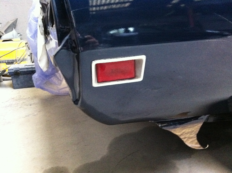

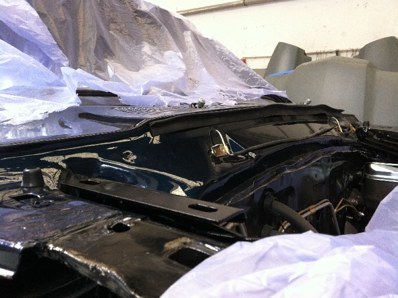

    well, my back still hurts like hell. but i went to work last week, so i needed to get my mind off things this weekend. only fitted some small and trim parts, but the visual effects mad me happy ;)

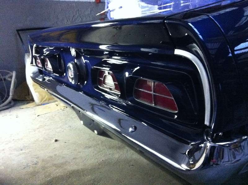

    craig, the car has been wet sanded after painting and will get polished when it is all together. the pictures just don't do the pint job justice - i really should take a decent camera instead of my cell phone.

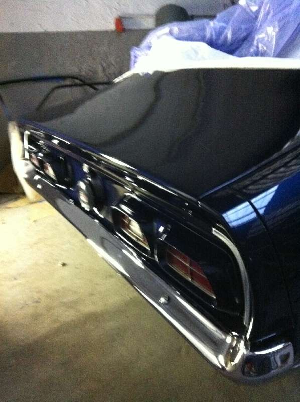

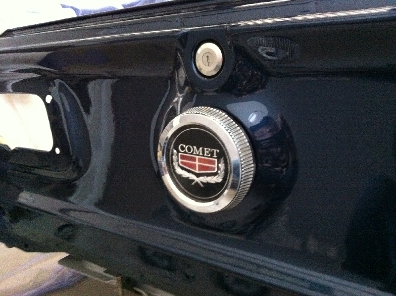

    my back is just a little bit better, but not much. couldn't resist working on the car though. taillight panel and trunk are now nearly complete:

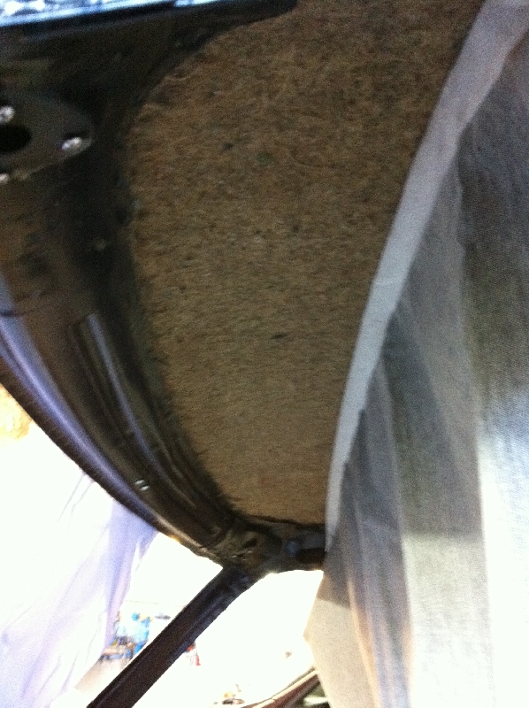

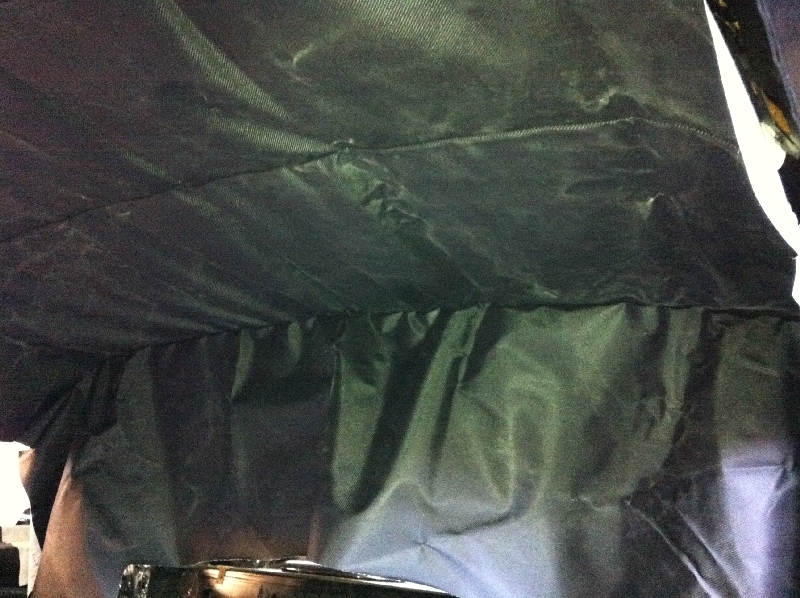

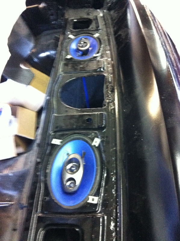

    i put insulation in the roof and the headliner on the bows so it can hang for a week - it was rather crinkled from sitting in a box for a year:

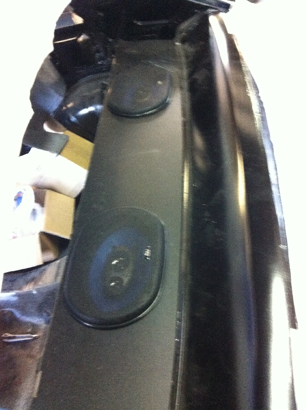

    i also put in the back speakers and the rear package tray:
    after putting in the wiring harness i had difficulties mating main and rear harness - plugs didn't fit. i had gotten the main harness off ebay and now have run into the little differences between 71 and 72. seems like 71 had the turn signal lights in the rear side markers which 72 had not. so there are two extra wires hence two different plugs. i have thoroughly gone through the wiring diagrams and it looks like an easy fix...
