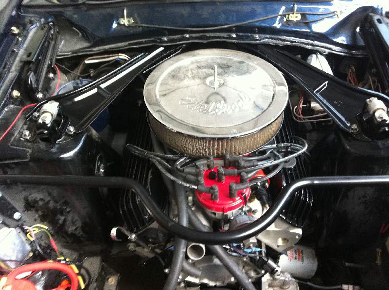

    Motor looks good. Thinking about finned valve covers myself.
    It is so nice to hit that milestone where the motor goes in the car again. That has to be a good feeling. Makes it seem that the time to be driving it will be sooner now.

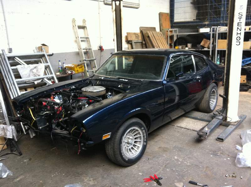

    another busy day today...

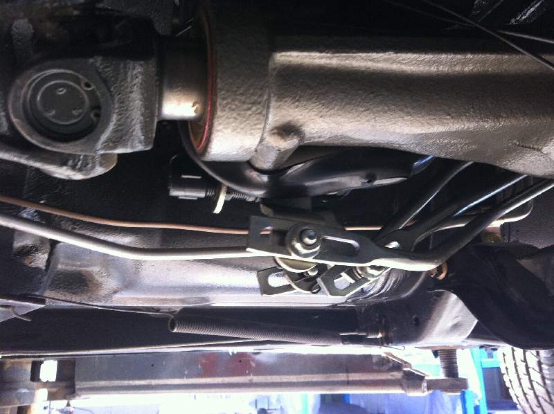

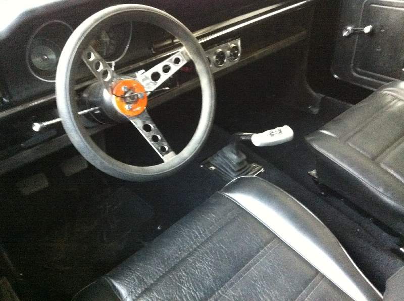

    look how nice the hurst shifter on the 4 speed fits the trans tunnel! and the shifter looks great in the car!

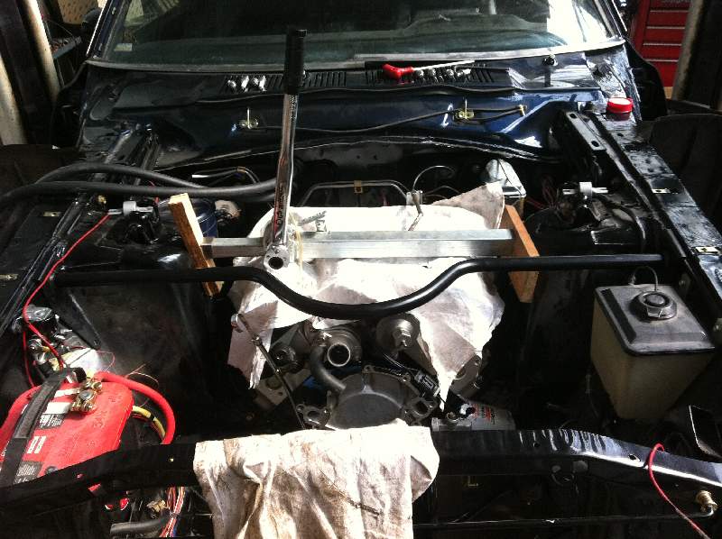

    i used brute force to make the monte carlo bar fit:
    i also put quite a bit of the front end back on:

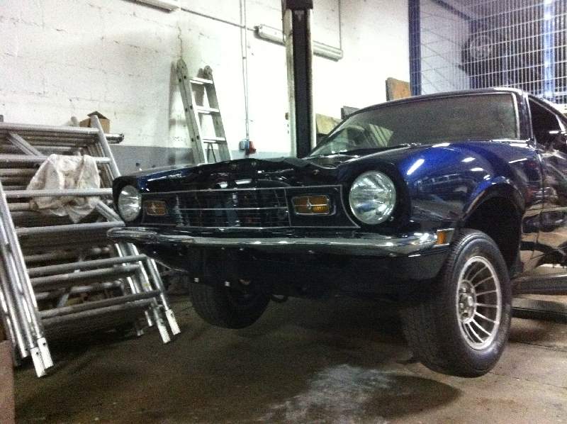

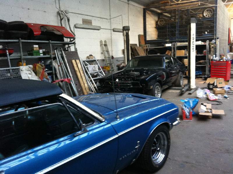

    here's the car waiting for more progress on monday!

    Looks awsome! I like it without that consolette.

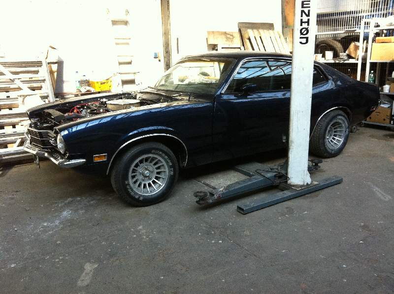

    assembled the front end completely today. the car looks great with the wheelhouse trim.

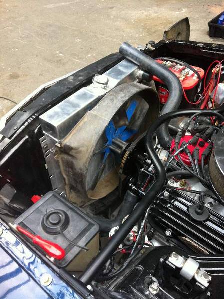

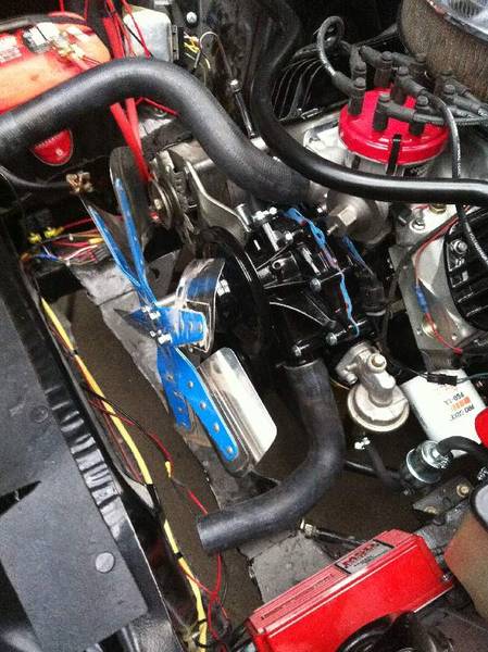

    made a quick trip to the garage today.
    arp had the wrong length bolt in their - expensive - aluminum water pump bolt kit. so i had to measure and order the correct ones. quite a task to hunt down 5" long unc sized bolts in metric europe!
    installed the water pump, pulley and fan. i found the felpro gaskets between pump and plate and also between plate and block not very well fitting, so i used liberal amounts of sealant...
    i guess the aluminum radiator will be next. let's hope it clears the crossmember and provides mounting options for both the shroud and a universal overflow tank.

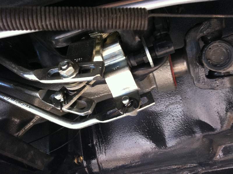

    some more info others might find helpful:

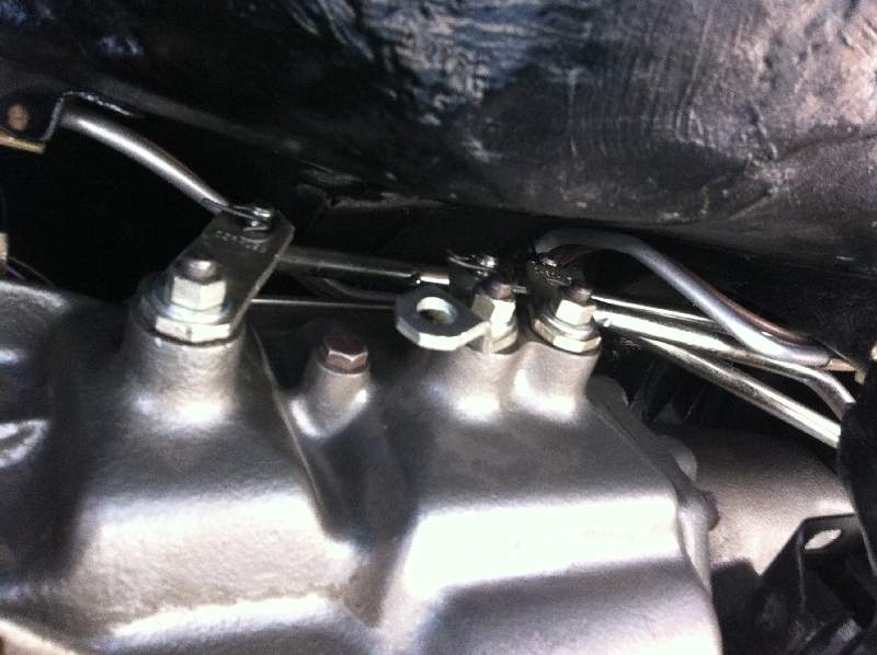

    when installing the toploader i used a 72 mustang rug-av1 wide ratio version with a 164 bell. it fit the c4 crossmember perfectly. the shifter - a hurst competition plus - came up exactly in the stock shifter location. i used the auto trans hump. the shifter boot mustangsunlimited sells - both upper and lower part - bolted right up to the existing holes of the c4 hump.

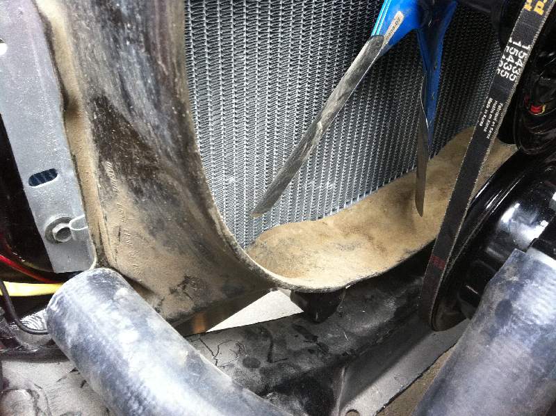

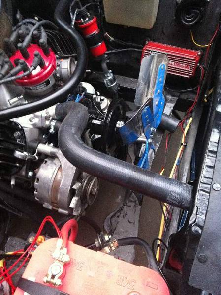

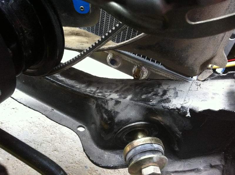

    test fitted the radiator today. rad itself fits fine. of course, there are some issues ;)
    i obviously have the wrong lower hose. ordered gates part no 20609 today, should be right for 70 mustang.
    as mentioned above, the petcock does hit the crossmember. i found a thread that actually a metric bolt is needed to plug it. finally something which is easy to get over here ;)
    looking at the pictures i saw that one mounting tab of the shroud is broken. will fix that with fibreglass and clean up an repaint the whole shroud.
