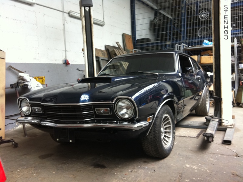

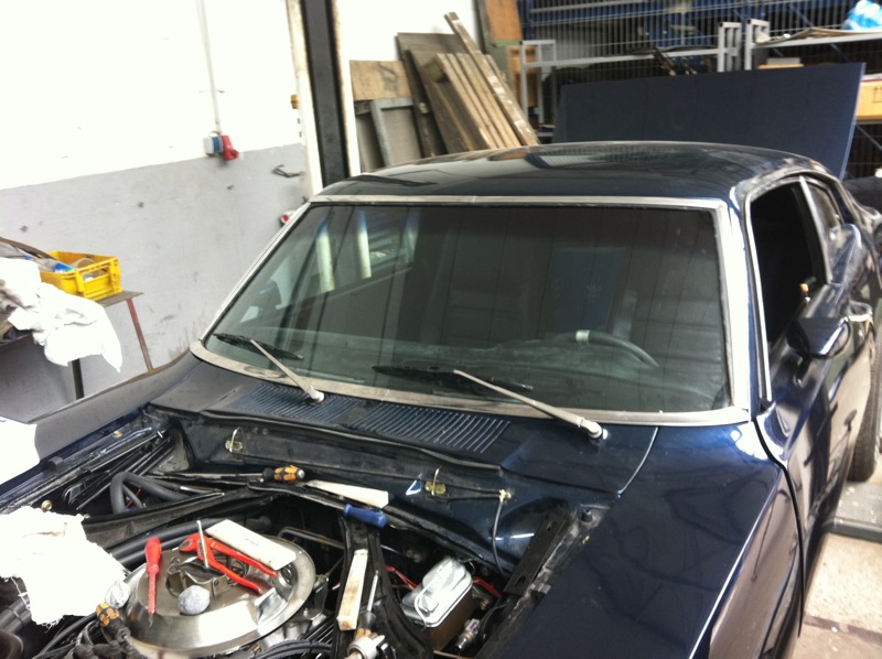

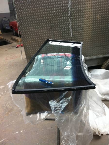

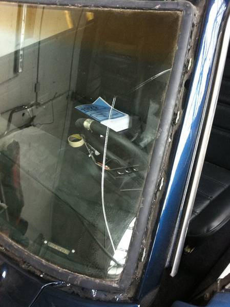

    worked some more on the car.
    my windshield had a nasty crack:
    it appeared a week after the install - maybe it was pushed to hard, maybe it was not the best idea to reuse the 38 year old chipped and scratched windshield anyway. found a new one in sweden. there's a company who custom makes them (factory is in finland from what i've heard.
    ready to install:
    chrome and wipers on:
    hood back on and headlight trim, too:
    it's not that far anymore!

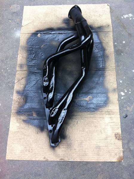

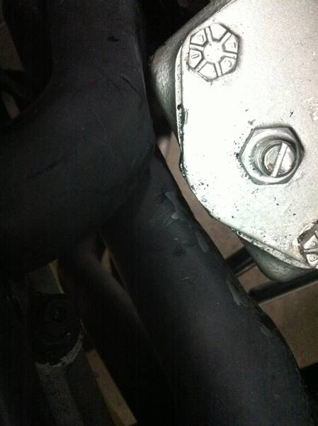

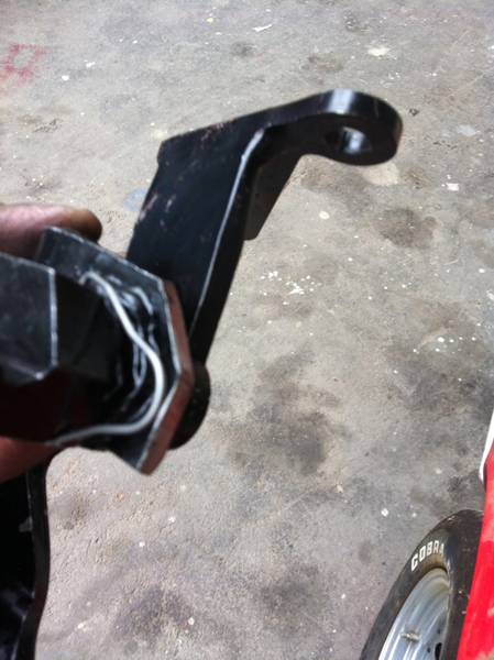

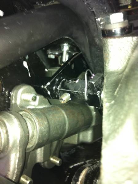

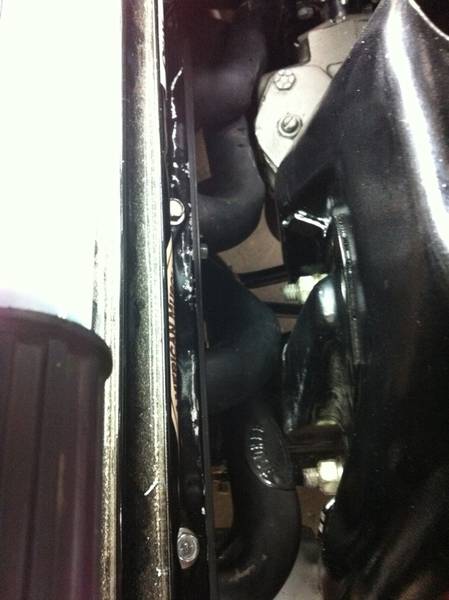

    in the meantime, it seems that i have solved my header problem on the driver side. would you call this "clearance"?
    just about right, i'd say!
    here you can see how much i had to modify on the header:
    makes you scratch your head if some people say it fit their car without problems...
    i trimmed down the zbar a little:
    and slotted the middle bolt as i had no chance to fit a wrench in there. mounted it with a screwdriver from below:
    clutch operation seems to work - zbar is scratching a little in some areas, but i hope that's not too bad.

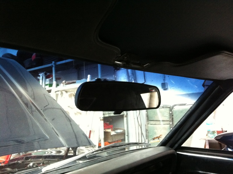

    apart from that, i mounted the rearview mirror and put on a nice windshield decal:
    if all goes well, i might have a little video for you guys tomorrow!

    Wow, that's a lot of "clearancing" I used long tube Headmans years ago, they didn't need any of that....
  12. chirt
    chirt Carlos Hirt
    Oct 1, 2007
    1,098
    Massachusetts
    X2, and I still use them.
  13. tody
    tody Member
    Apr 12, 2008
    1,840
    221
    cologne, germany
    yeah, had some issues with the hooker 6901. but they're the only one that work with a manual transmission...
