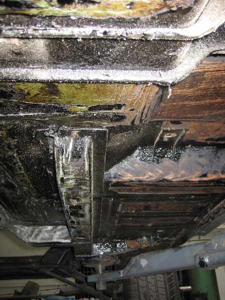

    today was a public holiday in germany, so more work done to the car. cleaned up the underside, and tried to figure out the brake system.
    the master cylinder was held by a custom made adapter, the proportioning valve carried a chrysler logo. at least front and rear disc brakes are branded fomoco, although i haven't got a clue which car they came off. i started a seperate thread about that.
    the system must have been really set up by a pro - starting with the non ford master cylinder up to custom made brackets for the parking brake in the rear which were actually not holding anything. i guess this will need thorough planning to get set up properly.

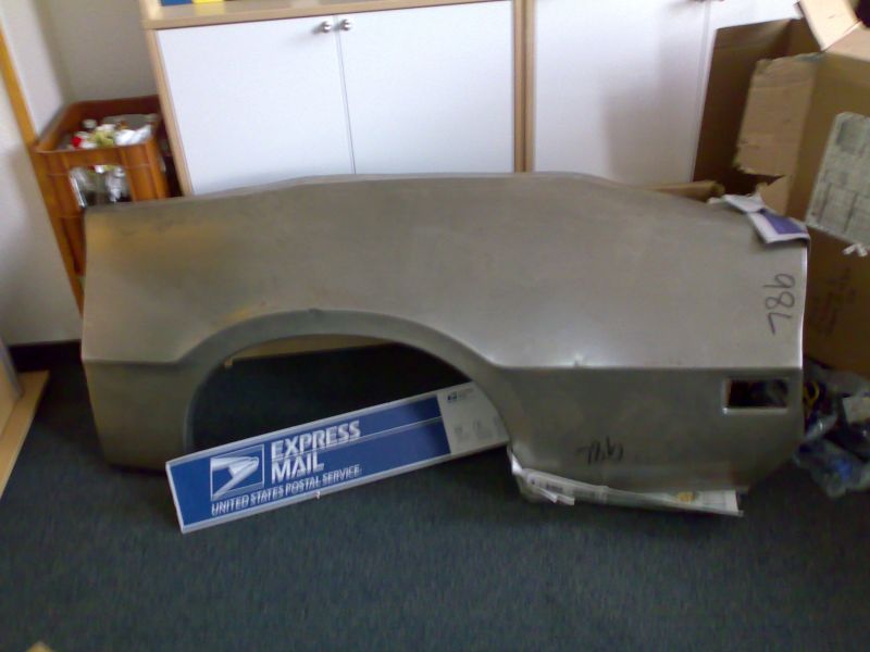

    shipping is fairly easy. usps for the smaller parts, as you mentioned. rates vary, but you do not have to use their boxes, you can use your own as well. it's all air freight though, and i have spent rates up to 90$ for a complete front grille.
    it's ups for the big parts. if you use their "air freight consolidated", the rate was around 200$ for the quarter panel and about the same for the front suspension kit. i shipped a complete set of rims for my mustang for less than that.

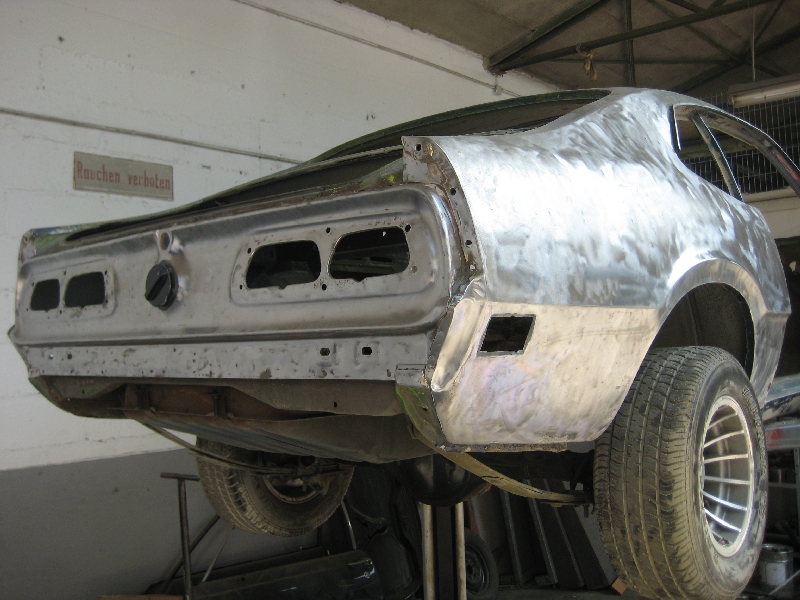

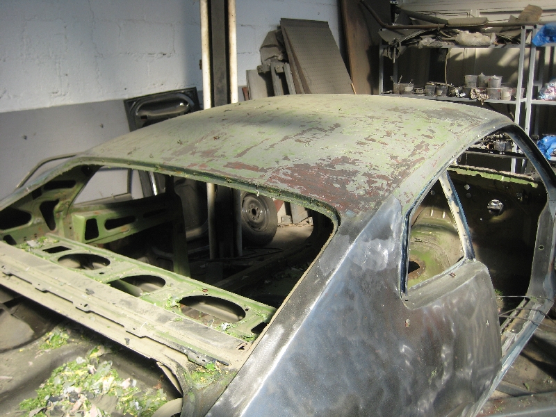

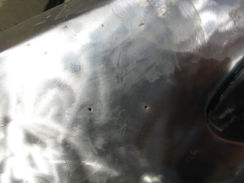

    help me out with some vocabulary, please. i continued to remove paint today, with a chemical. the dictionary comes up with "etchant", "pickle" or "stain" as a noun or the verb "acid cleaning". what would be the correct term?
    anyway, results look like this, the roof is completely cleaned, tomorrow i'll continue in the engine bay.
    all pics here:
    http://www.72comet.de/gt/index.php?id=29
    oh, and why would a 72 car built in late 71 have the mounting holes for the emblems on the rear quarters? am i correct that the comet gt's never came with any side emblems at all?

    ok, if etching is "ätzen", it's not quite correct.
    the german term is Beize (noun) or beizen (verb). it's a slimy white-ish looking mass you apply on the paint with a brush. it reacts with the moisture in the air and loosens up the paint which starts to peel and can now be scraped off easily.
    so let's stick with stripping, that does it for me.
    whatever the translation is - it worked quite well. it had to apply it a couple of times though, as it had to go through 4 layers of paint.
    the factory primer stays intact, so the raw metal is still protected.

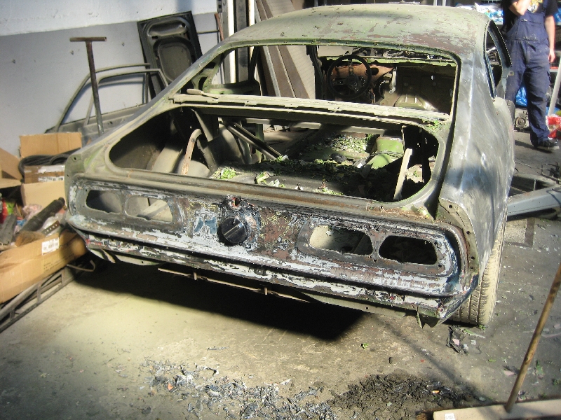

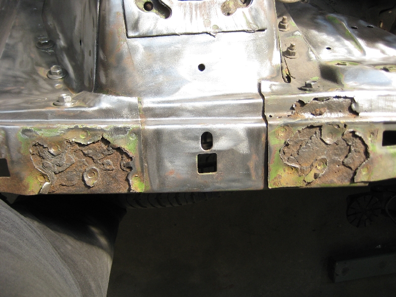

    third day of work in a row. the taillight panel is completely stripped.
    i removed the badly fitting piece on the rear passenger floorpan and found an attempt to repair a rear torquebox about which i could only laugh out loud.
    next the passenger side rocker panel - that's when i stopped laughing and thought of getting rid of this project for the first time. luckily, this thought only lasted for ten seconds. played "the meteors - you ain't gonna bring me down" a couple of times on the stereo to cheer myself up. this worked quite well.
    then onto the engine bay, which needs more cleaning next weekend. out of sheer interest i put the wire wheel onto the tank and found pretty solid metal under the rust. at least something...
    the pictures are here: http://www.72comet.de/gt/index.php?id=30
    i started a new thread on the replacement rocker panels i found at autokrafters to see wether they are any good. something definitely needs to be done about that!

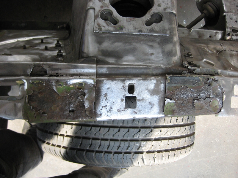

    yesterday's work included stripping the engine bay (still not finished, way too many small corners) and the a-pillars where the doors are mounted. i also cleaned up the radiator support. found lots of corners which need fixing...
    http://www.72comet.de/gt/index.php?id=31
