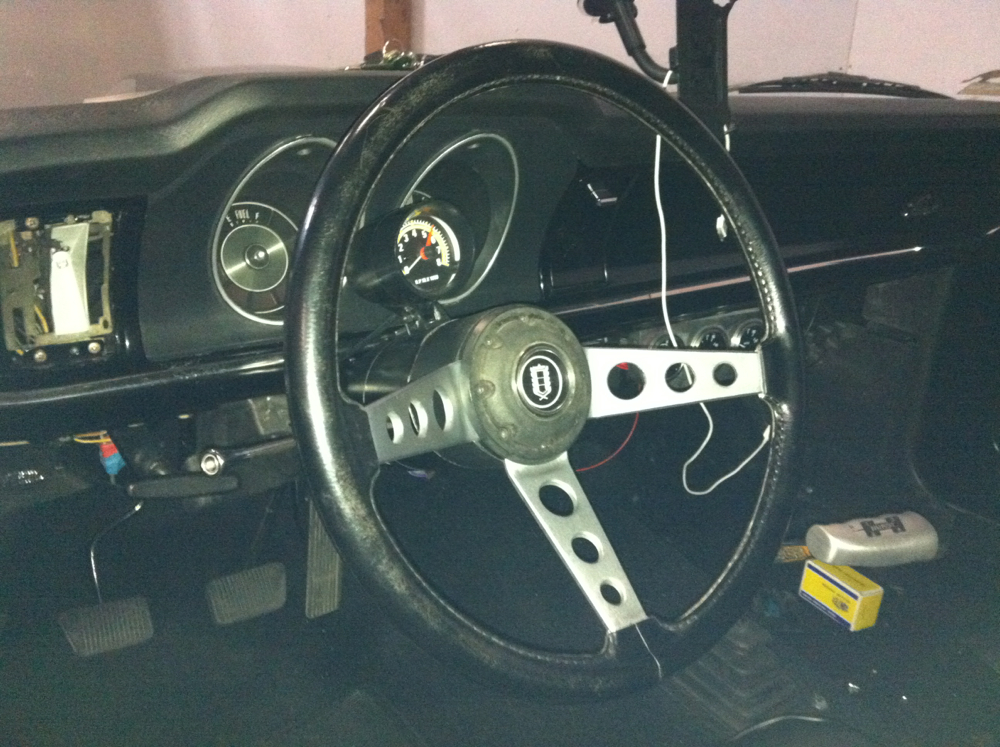

    today, i ditched the cheap grant steering wheel and mounted the ford sport steering wheel i got off ebay. anybody know what kind of center emblem that is? anybody know where to get a mercury decal with the right diameter?
  8. CaptainComet
    5,017
    457
    Nice score on the wheel.
    That emblem looks like it might be a generic Ford item.
    They put these wheels in a lot of different vehicles, and I would expect that if it came out of a Mustang, you would get a running horse emblem or something Mustang-specific like that.
    Someone here had Comet wheel centers, Seth Roberts, I think. Maybe one of those would work with some trimming.
    EDIT ... just found this old post .... maybe he still has some or can get some ... http://mmb.maverick.to/showthread.php?t=19581&highlight=comet+wheel+center+emblems&page=3

  9. blugene
    10,776
    If not I may have one or two around here somewhere..

    thanks guys, i'll keep that in mind! i'm not sure whether i like what i have...

  14. 75 Vomet
    75 Vomet Member
    Aug 21, 2008
    226
    52
    Shickshinny, PA
    75 Comet GT, 03 Ranger, '11 Fusion,'13 Escape S
    :character0182:1980 Granada. I believe the Ghia models had that wheel. Almost a Maverick steering wheel. :chirp::burnout:
  15. tody
    tody Member
    Apr 12, 2008
    1,843
    229
    cologne, germany
    thanks, that's good to know! i guess i'll just keep that center emblem...
