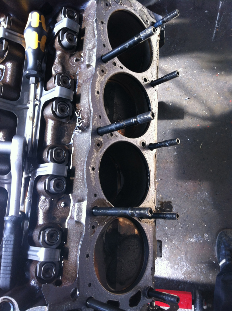

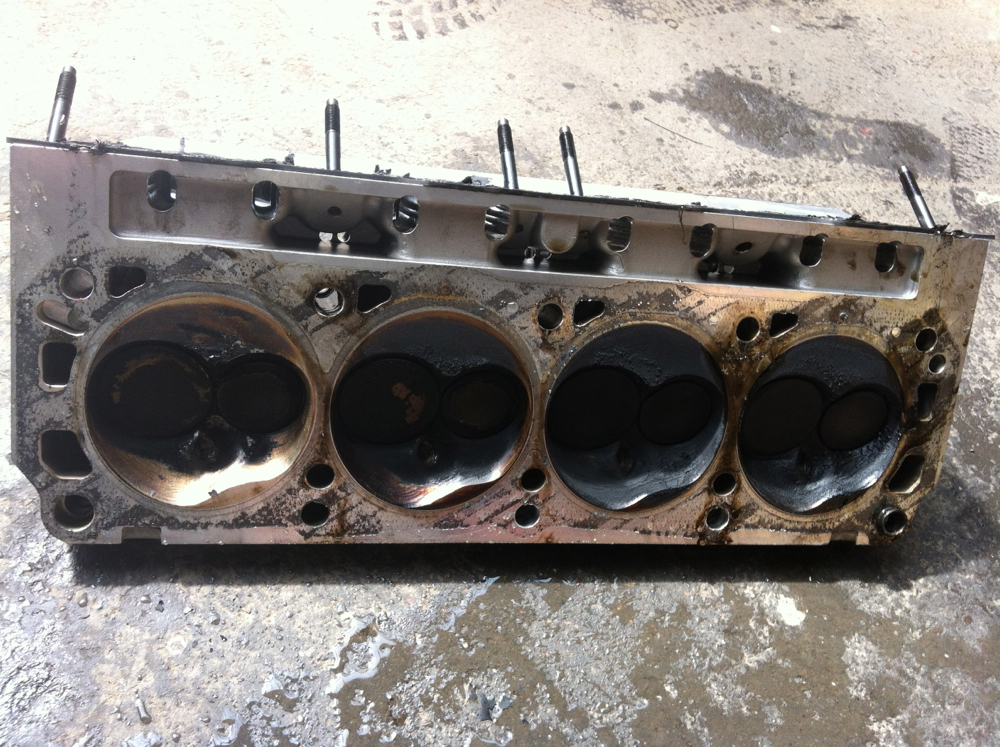

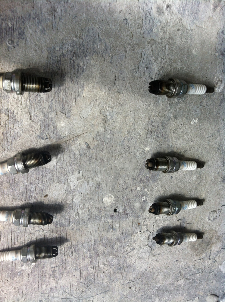

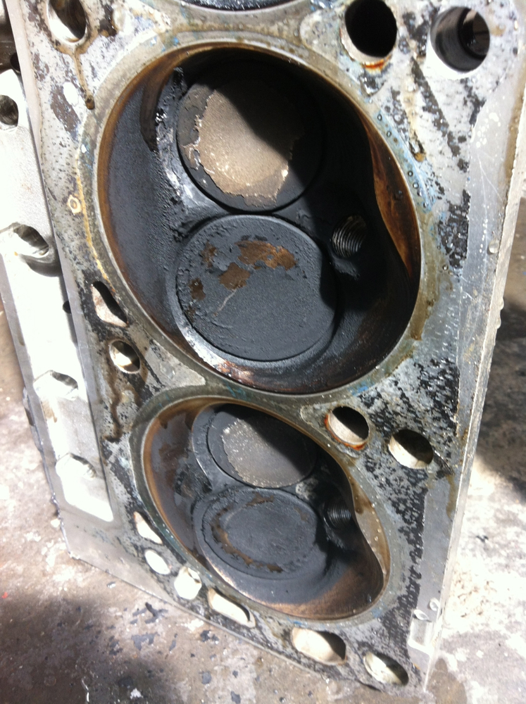

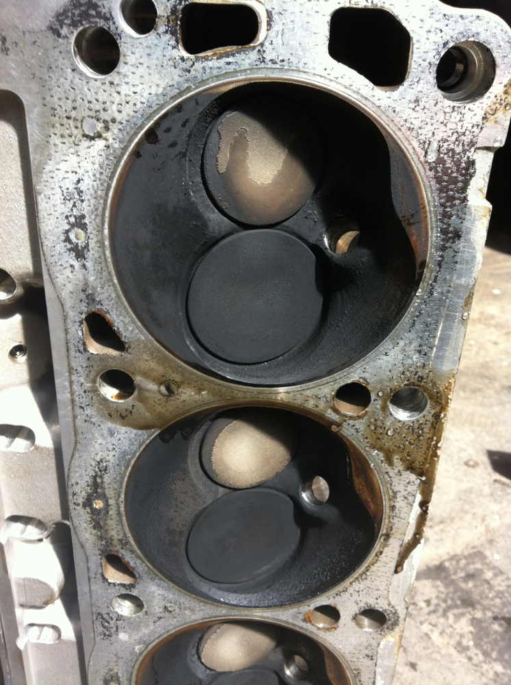

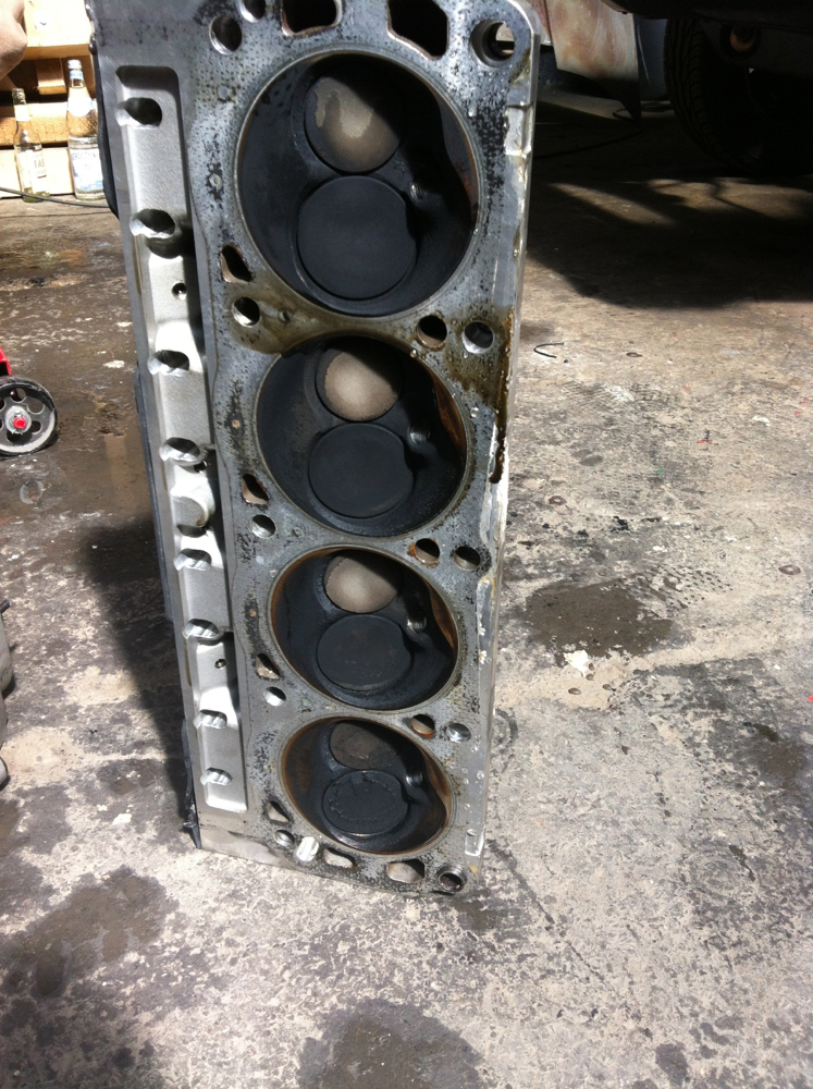

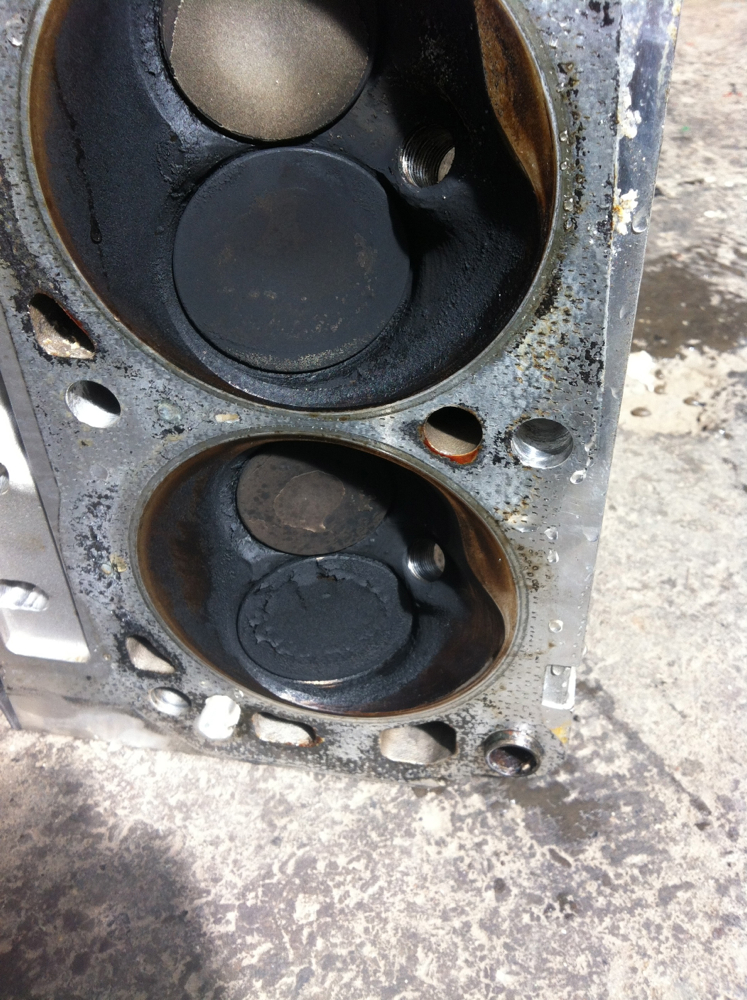

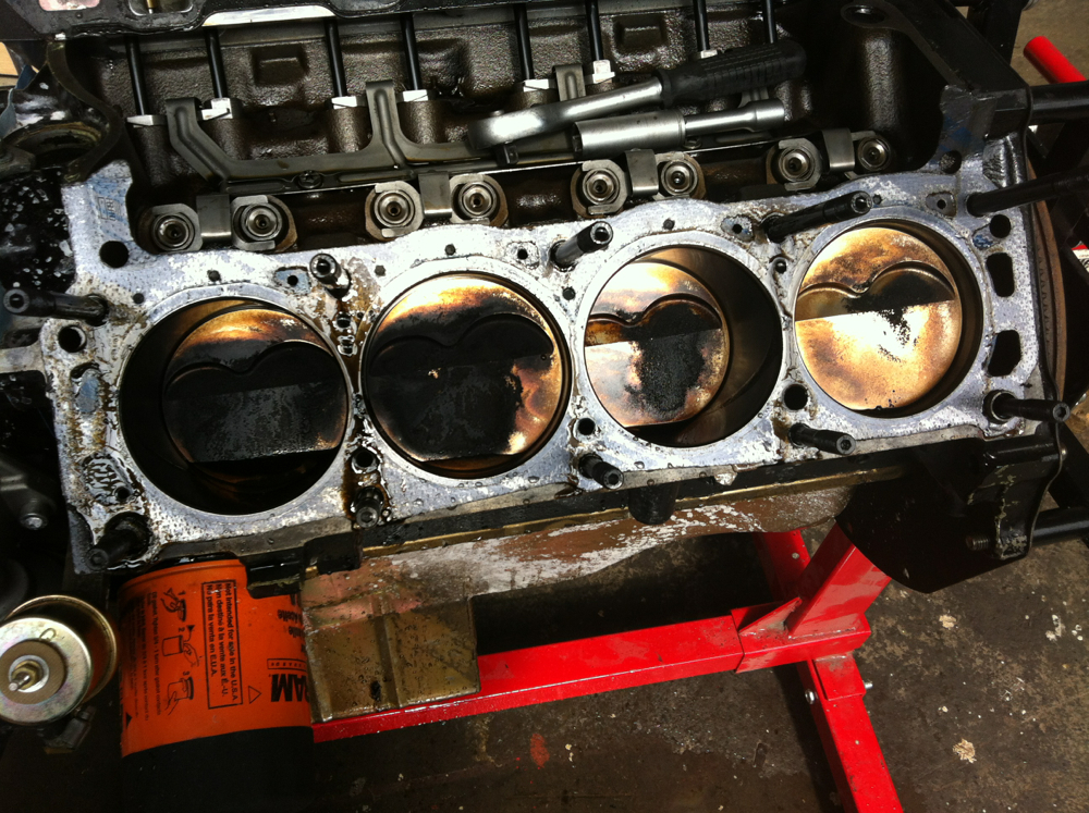

    but i think he won't be able to resurrect this engine. fresh 347 stroker, only 3500 miles on the rebuild. couldn't believe my eyes when we pulled the engine and the heads today. cell phone photos only, will take better ones tomorrow:
    pulled the plugs first, all dark and sooty. cylinder 1 on top right:
    passenger side head:
    matches the block:
    pretty much the same on the other side:

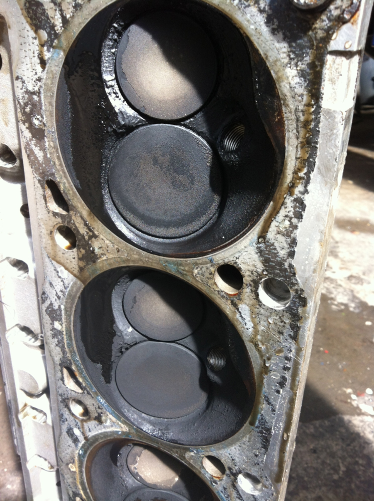

    closeup of the combustion chambers:
    1-2:
    3-4:
    5-6:
    7-8:

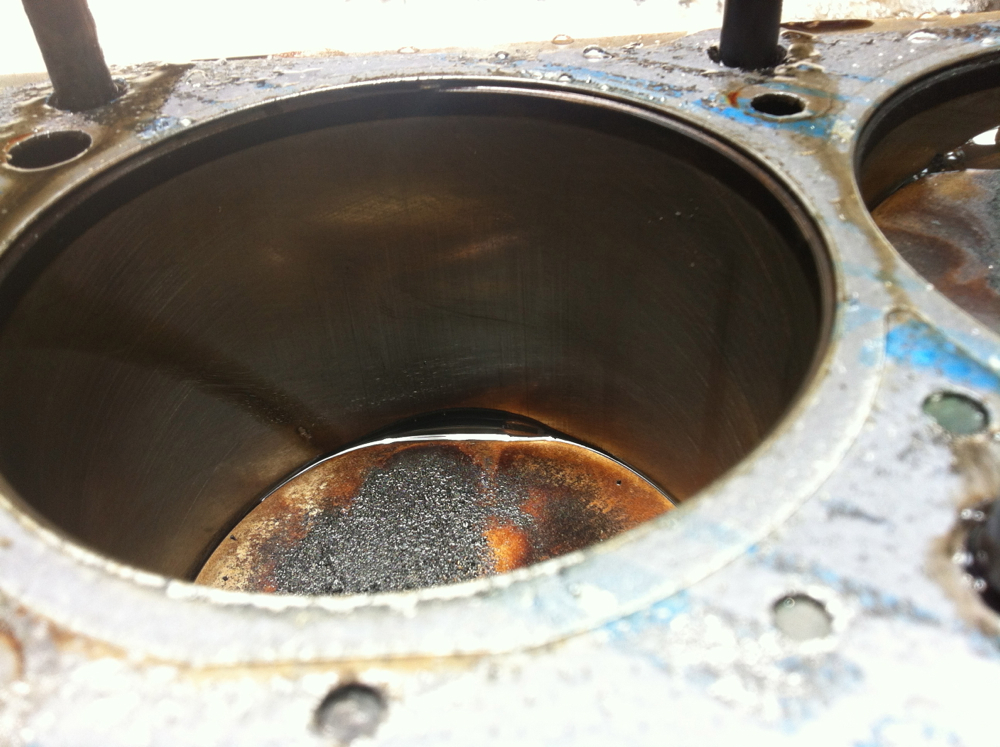

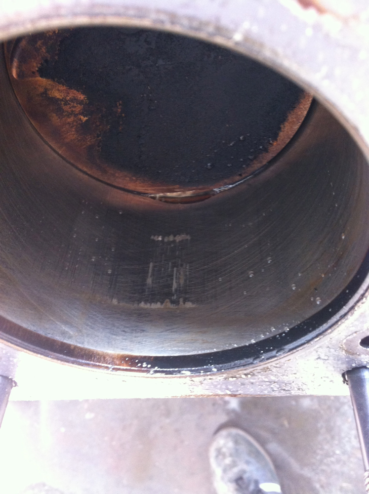

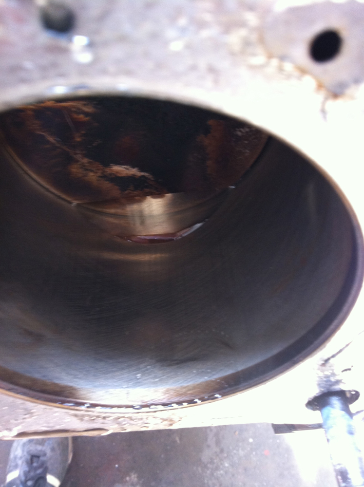

    i stared in disbelief at the cylinder walls. rough wear on each and every one of them, doesn't come out too well on the pictures:
    let me state that i kept an eye on oil level and oil pressure. the engine never ran dry or too hot. if you read through this thread you see that i complained about an oil burning problem right from the beginning when i noticed this the first long drive. i'm at my wit's end, and i guess i will have to start with a fresh block. if the cylinder walls look like this, i guess i'm in for a set of new pistons as well. i fear they won't look any better than this.
