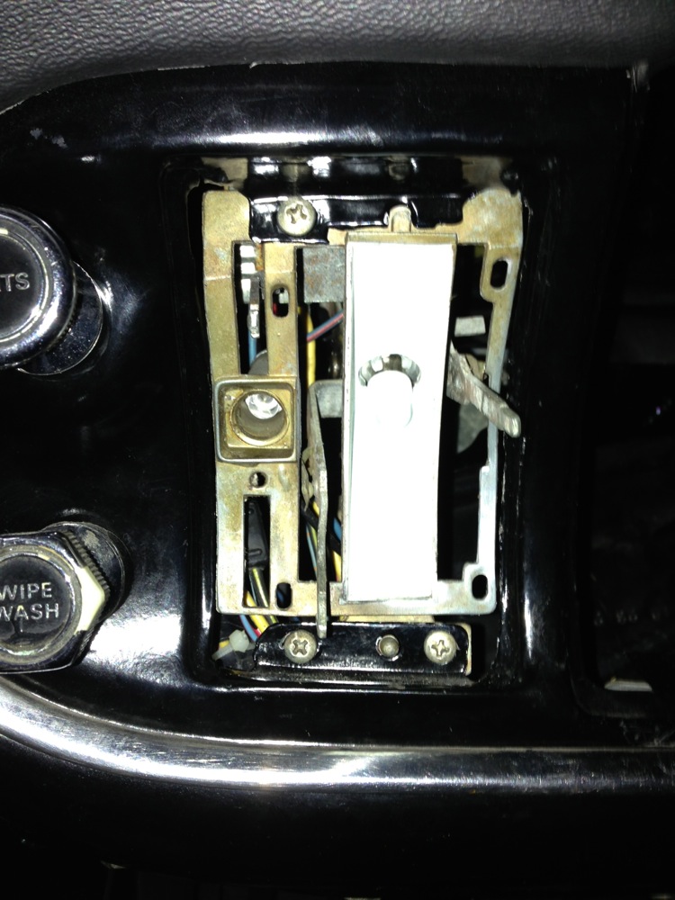

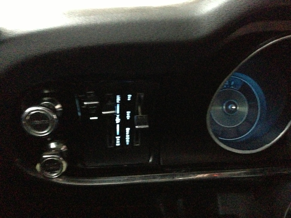

    mean_maverick sent me the correct heater controls. they're in, together with the NOS face plate:

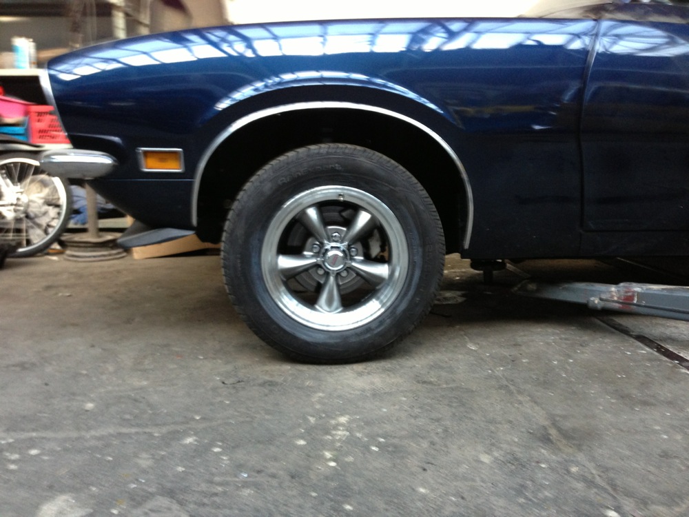

    and i was lucky on german ebay and scored a set of TT wheels. they're the reproductions from REV Wheels, the Classic 100 wheel Scott Drake sells. 15x7 with 4" backspacing. well, they're new, so the old cragars with peeling chrome had to go:

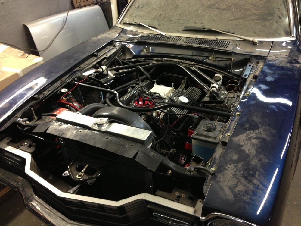

    today's task:
    accomplished:
    getting the engine in was easy, the headers went in in no time. even the z-bar is in. all the parts which gave me a headache last time were not so difficult this time.
    the engine was running out of the car this morning, but the carb is leaking. hopefully i'll get that fixed tomorrow so i can get the car on the road again. finally!

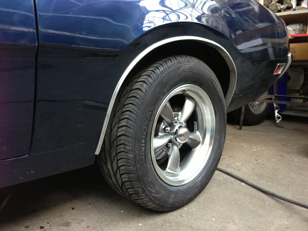

    front end is aligned, had to work with shims on the driver's side.
    camber is 0°, caster at +0.6°. couldn't get more caster, as the lower control arm started to flex and the wheel came way off center in the wheel housing.
    rides pretty smooth, only on sharp right turns the tire rubs against the wheel molding on the driver side. i hope i can fix that by trimming down the molding a little as it sticks into the wheel housing over the edge of the fender.
