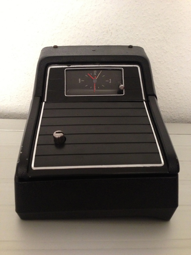

    thanks to John Holden, I was able to finish my consolette. i had the console itself as well as the clock, but the inner metal frame was missing. now everything is together!
