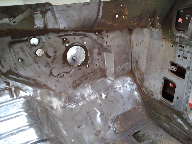

    i took this week off from work - so i could get some more work done on the car. i cleaned up the floor pans. it might happen that the driver's side needs only minor patches while the passenger side is gone...
    all pics can be found here:
    http://www.72comet.de/gt/index.php?id=32

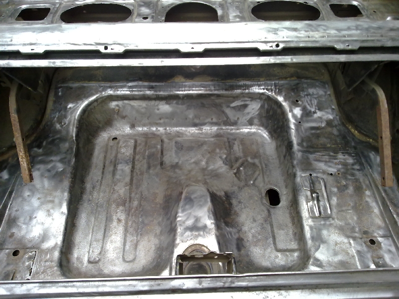

    found more monkey repairs in the trunk - it was completely covered in a layer of bondo. took me the whole day to clean it. only minor rust spots in the trunk area...
    http://www.72comet.de/gt/index.php?id=35

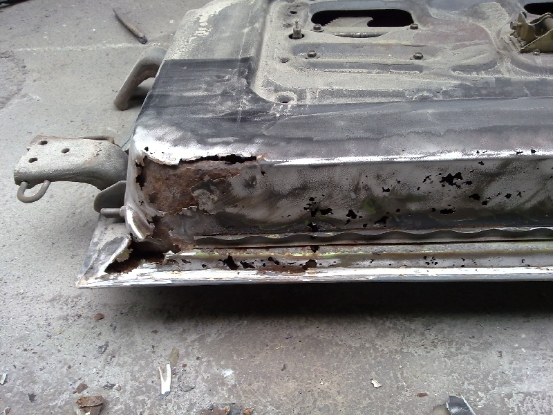

    if you are looking for rust on your car, be sure that you can handle it. today, i nearly couldn't.
    is the picture showing
    a) swiss cheese
    b) more bondo than metal
    c) my passenger side door?
    the driver's side door seems not to be original to the car, as i couldn't find any green underneath. and the trunk lid has lot's of dents and rust spots too...
    that's not going to be easy...
    http://www.72comet.de/gt/index.php?id=36
