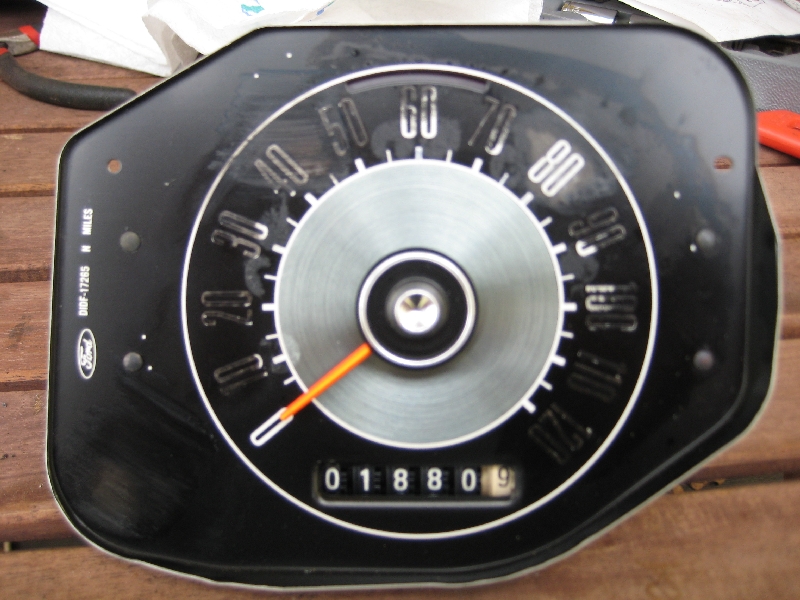

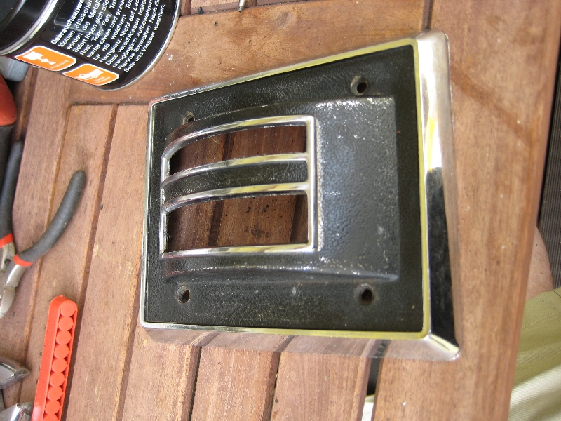

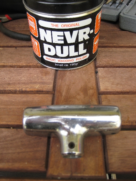

    more small repairs done today. i figured i had a fairly good dash pad and wanted to put a new cap over it. after closely inspecting it, i discovered that there was already a cap on it!
    after removing it, i found a nice 37 year old cracked dash :rolleyes:
    glued the cap on, it's now drying in the afternoon sun:
    i also took apart the shifter - from the part number it looks like i have a pinto part. nevr dull is simply the best polish in the world :cool:

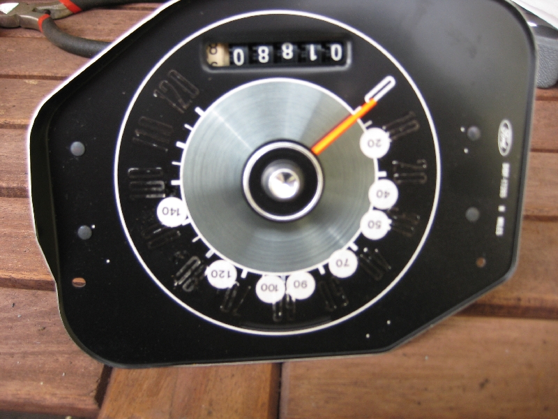

    and now to the bad parts: the previous ownder in sweden tried to manually convert the speedo to kph. by putting little badges on and blacking out the mph numbers with a magic marker... no way to remove it without also removing the black paint underneath. so i guess i'm in for a new speedo. that or white overlays, which i personally can't stand.
  8. rwbrooks50
    rwbrooks50 Member
    Aug 13, 2006
    1,066
    33
    158
    Forney Texas
    71 Maverick & 63 Ranchero
    Tody,
    I have a speedo out. I can send it to you for shipping cost. Maybe it's not too late for the container.
    Rick
  9. CaptainComet
    5,012
    453
    Might be a little late for this ....
    Try using rubbing alcohol to remove permanent marker. Usually works very well, but I don't know if it will hurt the speedo face. I believe those are silk-screened on.
  10. tody
    tody Member
    Apr 12, 2008
    1,843
    229
    cologne, germany
    thanks for the advice...
    but i tried this as well, didn't work. also tried some stuff to remove nail polish, didn't work either. but i posted a "wanted" ad for a kph speedo and was already offered a spare mph one :)

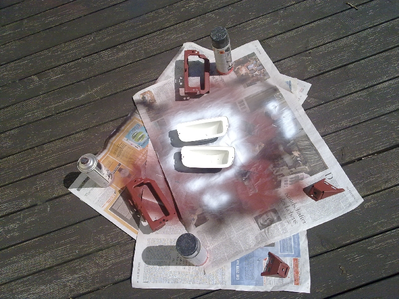

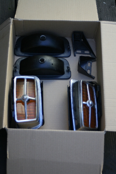

    today, i prepped my grille lights. cleaned everything up, painted the inside bright white for better reflection.
    there's one thing i need to find out. which bulb sockets can i use? the ones i had weren't any good any more. as i will have headlights with parking lights included - a requirement in germany - i will only use the grille lights as turn signals. so i won't need a 1157 dual filament bulb, but a single filament 1156 bulb. anyone know where i can get matching sockets?

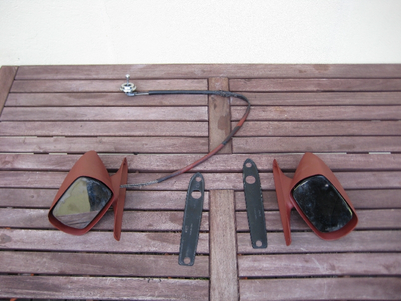

    earlier in the thread i mentioned that i got a pair of sport mirrors off ebay - the deal fell through, though. but i found another driver side sports mirror, with a working remote - complete with mounting nut and washer. only $25 via ebay!
    i even got a wasps nest included for free :clap:

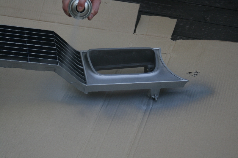

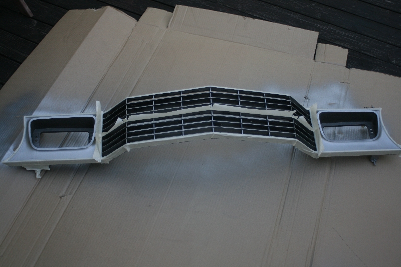

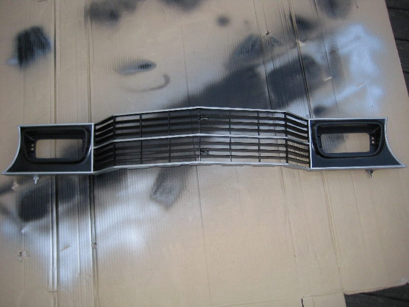

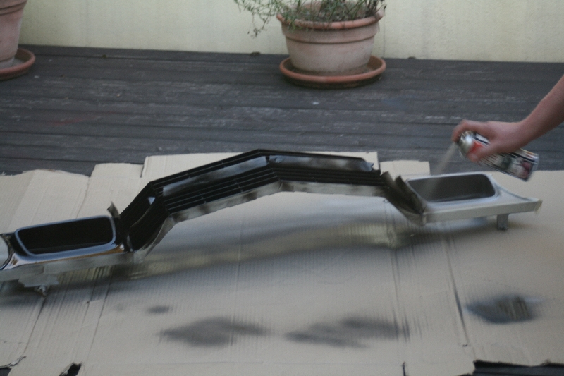

    finished prepping the grille. as the old one was busted and the only one i could find was a regular 73 grille, i decided to at least paint it like a gt grille. a layer of aluminum grey first, masking everything after and then painting it in black...
    does look quite nice...
  14. Rando76
    Rando76 Member
    Apr 17, 2002
    2,659
    Claremore, OK
    Wow - that looks great!
