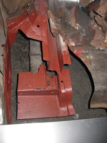

  12. blugene
    10,776
    Looks great! All this progress... do you sleep? :cool:
  13. mvw66gt
    mvw66gt Member
    Jan 3, 2005
    722
    Arthurdale, West Virginia
    71 Comet GT
    Your making great progress. Nice to see this one coming back together.

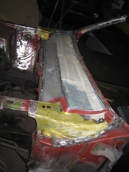

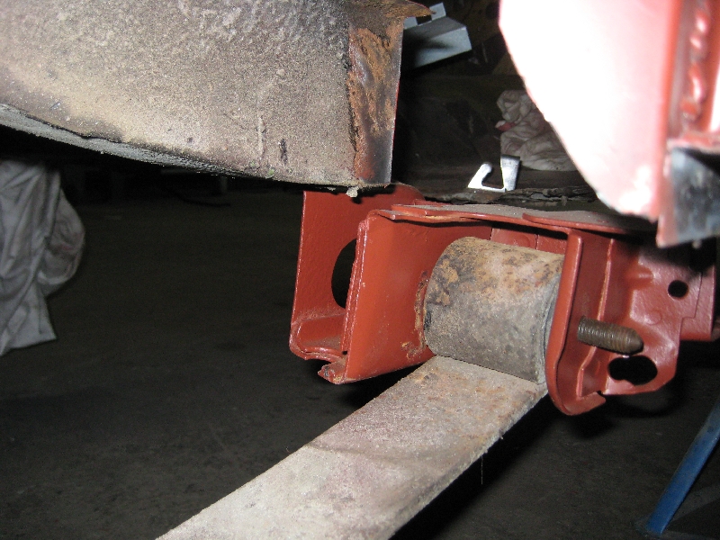

  14. tody
    tody Member
    Apr 12, 2008
    1,843
    229
    cologne, germany
    well, i thought the sleepless nights would start when i get the bill from the bodyshop - but apparently i'm getting nightmares right now :yikes:

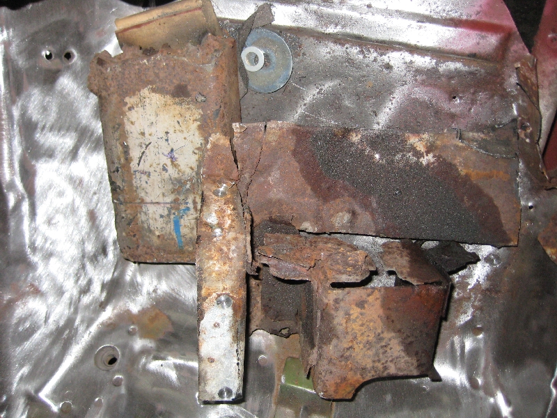

    the cowl vent area now looks like this - i'm very pleased with the result:
    but the i saw how they are fixing the passenger rear torque box - it was nonexistent in the first place, and i'm eternally thankful that mean_maverick had a parts car to cut up. but this is a repair which i guess should only be attempted by a highly trained professional:
    apparently, they *really* know what they are doing there, i'm very happy with that (y)
