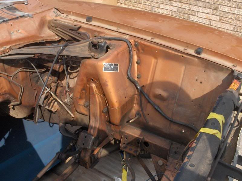

    I found the sticker, and took pictures of that the dashboard and engine numbers. I'm just looking for the camera that's been misplaced. Pics to follow shortly.

    Stickers vin number and engine number

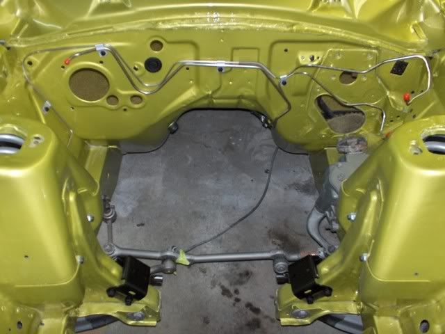

    I was wondering if somebody had a picture for where the engine mounts, mount. I cant seem to find it, I must be blind. They were not in place when i bought the vehicle either. :coco:
  10. Dave B
    Here's a picture of one side, I'll see what else I can find:
  11. Dave B
    Here, I knew I had one:
  12. Dave B
    This shows the location on the engine:

    Okay that's perfect thanks a lot. I'll have more pictures tomorrow. Gettin ready to head out now :D
