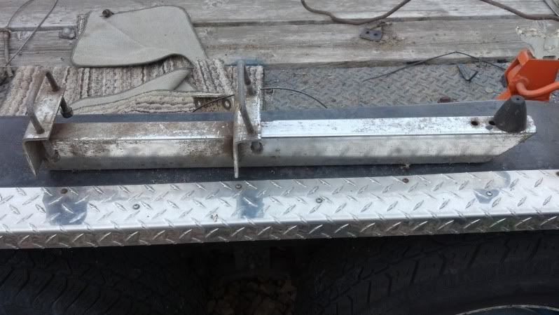

    My CalTracs are set up for staggered shocks....:hmmm:

    CalTrac's replace the lower plate.

    Here is the lakewood traction bar that I bought in 84........when I raced the car the snubber was set 1/2" from the leaf spring.....no wheel hop....

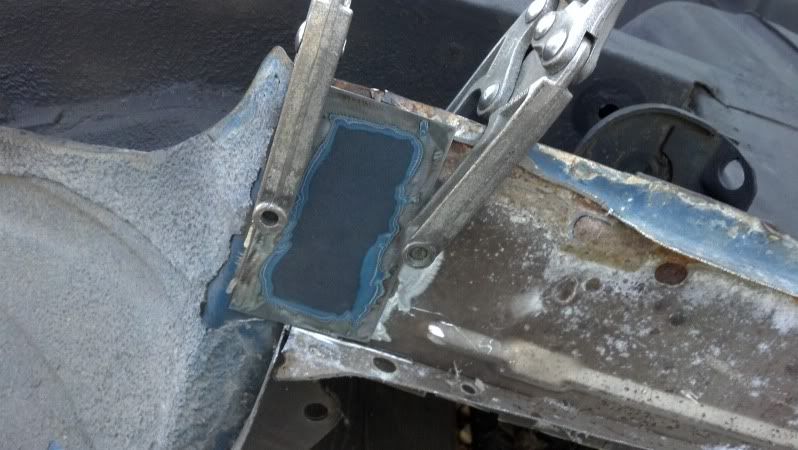

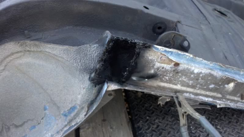

    There are 2 places to patch on the donor floor before its put in....its the same on the other side...
    my little patch........
    the patch welded in and sprayed with anti rust coating....I must practice welding sheetmetal...lots of welding left........:cry:

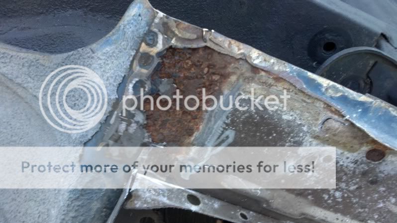

    cut out the rusty stuff.....I left enough metal to do a lap joint.....placed and welded in a piece from behind(not shown)...........ended up with two layers again......its strong........still learning about metal patching.....
