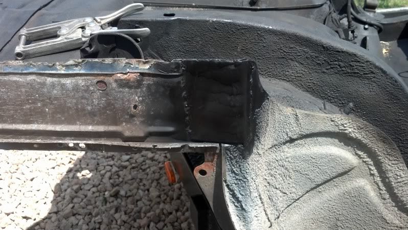

    Got the second wheelwell fixed....cut out the rusty stuff ,welded in 2 layers of new metal.......
    I want to say after looking at the builds on this site the craftsmanship and cool factor of the members on here is top drawer.........:thumbs2:
    At least I got to practice welding on a place that wont be seen.......:rofl2:

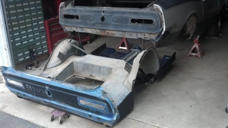

    Well.we are at the point of the project in which things become fun......I will retain the donor back tail light facia.........less welding.....this makes or breaks it.......................:cry:

    So this hole in the wheelwell is the same position on the donor floor and my 76.............
    I am going to use this hole to locate the new floor in the 76 chassis....if both holes are lined up on each side it should be square...I did some very careful measurements and this should work....:hmmm: the pic of the hole on the 76 looks off but it was my picture position...

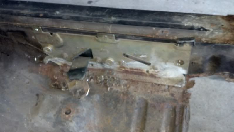

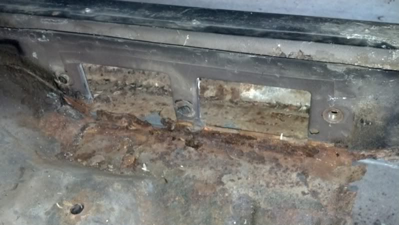

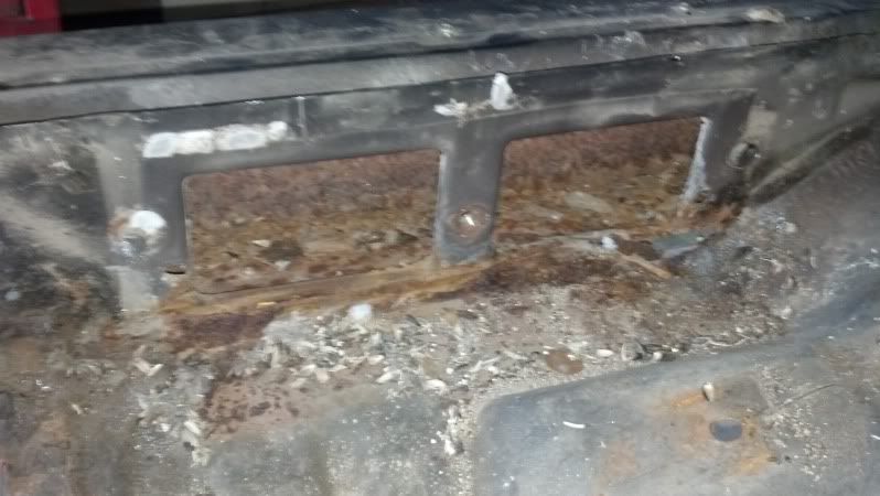

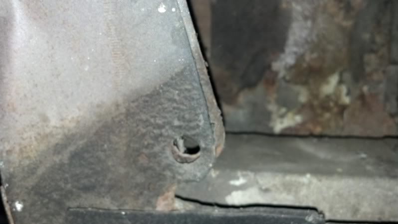

    So the goal of tonight was to get the seatbelt brackets out......all 3 bolts were rusted in....I was able to get 2 out of 6 out...the rest had to be cut....
    What I found after they came out made me sad........:huh:
    this is the pass. side....
    the drivers side...........more rot............sad.......:huh:this will have to be attended to after the floor is in....have to get the car sitting on good metal.......I am surprised its stayed on the stands this long.....

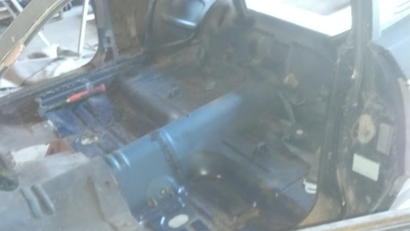

    Tonight the floor goes in for a test fit.....

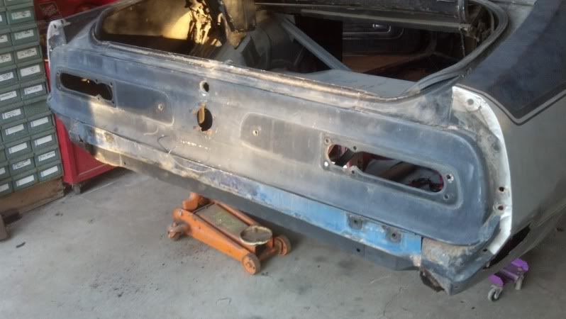

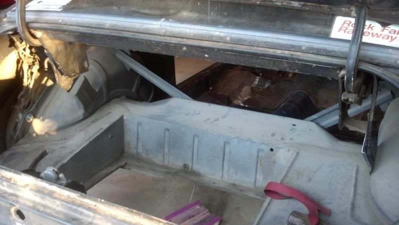

    well...let the fun begin..........I did a ton of measuring and trimming in order for the floor to just slide between the 76's rocker rails.....there was just a 1/16"+ to play with...
    straps got used to help hold the trunk area in....
    the floor slid in with very little additional trim work...
    the trunk......
    at the back tail light panel......everything is clamped in place...I have bolts in the factory locating holes on the wheelwells..from what I can see and measure we are good to go for some welding and blending from the 70 floor to the 76 floor.......Tonight was fun....Now the car can be Built....:)
