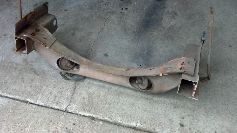

    Got myself a good front crossmember....it came off a clean 76 in the local parts yard......the car went right to the crusher after this piece was cut off....the back half was smashed up pretty bad.....this was a great score ... have gotten lucky on finding frame parts lately...

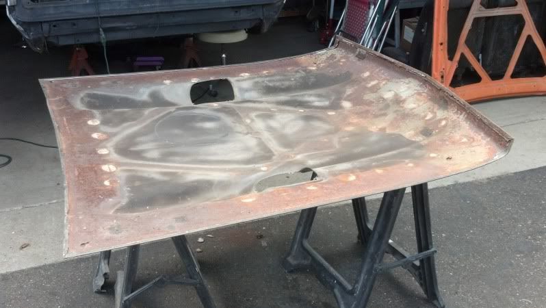

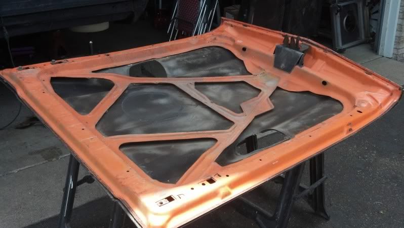

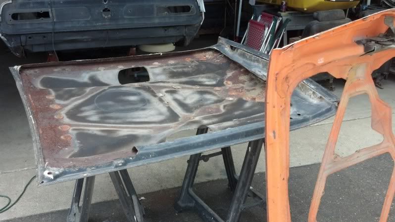

    Side project # 3.........as a stupid youth I cut the support webbing out of a perfectly good grabber hood........ little did I know it would come to bite in the butt 23 years later...........:cry:
    got the old stuff removed...........rusty......rusty.....:rofl2:
    got some new webbing off a donor hood................I am going to trim to fit after a ton of rust removal...................:clap:

  10. CaptainComet
    5,008
    447
    The way that hood was getting crusty inside the supports, over the long haul, you might have just done it a big favor.

    You are right...................didnt look at it that way........would have never tore it down otherwise.......
  12. 71gold
    that's why i steam clean in there and then pour a can of...Rust bulit...in the seam and roll the hood around to get it in all the cracks...:yup:
    with all that rust, that looks like it will be a boy dog to weld back up...:yup:

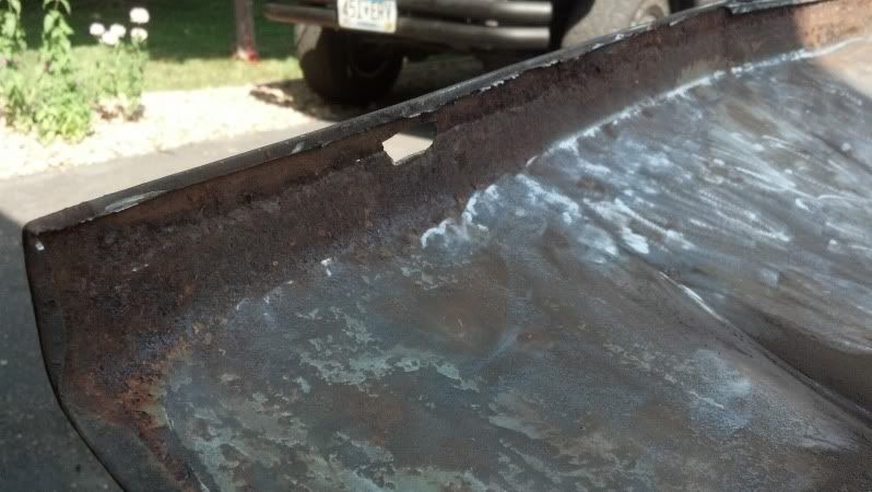

    Ran into some more fun while sanding the rust off.........in the middle of the front facet of the hood its almost rusted thru and its got a cute hole also....:mad: so here's the plan....I am going to attach the inner webbing to the good metal then cut and patch after.....:cry:
