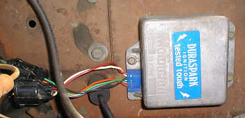

    Where is the duraspark box located ?? Never heard of that !!

    Also called the ignition module - looks like this - you will see it under the hood attached to the distributor and coil wiring.
