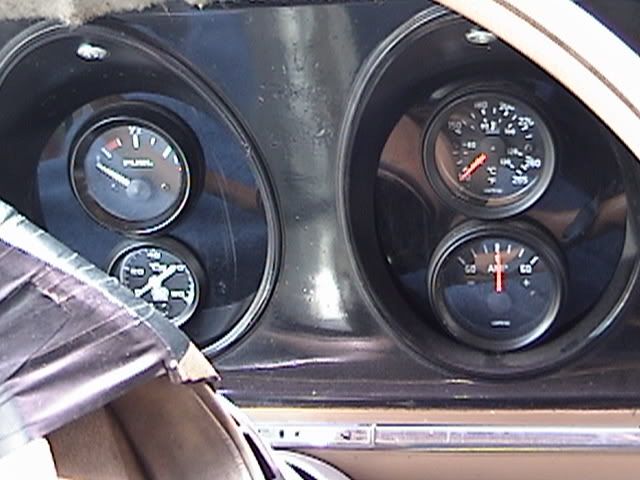

  8. craigs mav
    craigs mav Member
    Jun 19, 2006
    193
    arizona , avondale
    1975 chevy el camino
    heres mine
  9. maverick75
    9,018
    i should have explained it better.I'm going to be putting another gauge pod next to the one thats alredy there.In the first hole i'll put in the amp gauge then in the second i'm going to put a cig. lighter and the last one will have another water gauge.
    PS: heres a pic of roberto's gauges
