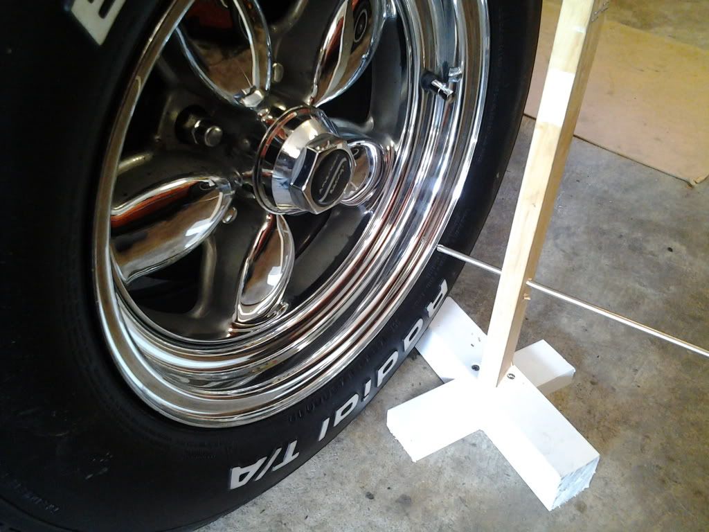

    I wish I knew of a place like this where I live now. If there is an issue with the tire then I would expect replacements as they are new. Its difficult to say what the cause of the vibration is because of all the variables in play here. As for the hub centric rings, I have a set coming as early as tomorrow and I plan on trying them, if anything just for the sake of eliminating that as a cause. Im about to set up a little rig that I can set next to each wheel and with a spin, check for any imperfection in the wheel or tire. I will post a pic. Thanks again everyone.

    I made my little jig and tested all four wheels and tires. Its very primtive but it gave me some good information. when tested on the lipof the wheel, all four wheels seemed consistant and straight. When tested on the tire tread, it showed flat spots on all four tires, some worse than others. Here is a pic of the jig. Im also uploading a short video of my test.

  13. mercgt73
    Like mentioned, I think you should take the wheels and tires to a shop that can do a road force measurement.
    There is a difference between an unbalanced wheel/tire and one that produces a vibration while driving. You can balance a rotating square... but it will still give you a vibration while driving.
