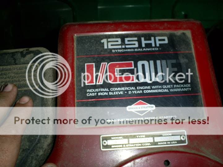

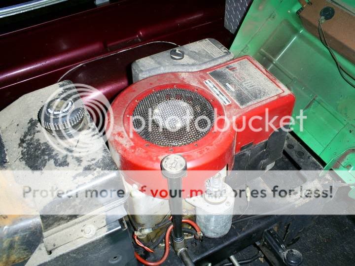

    Those are nice, but it's kind of hard to justify spending $1,000+ for an engine to put on a tractor that MIGHT be worth $400.
    So, it'll be getting this engine, which is $0, because we already have it, and it runs excellent. :D

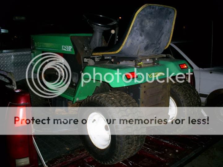

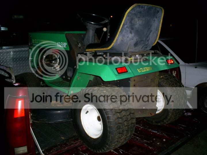

    The parts mower, which has a messed up transaxel:
    It'll also be donating it's front tires (and wheels, if the axle diameter is the same), and newish looking battery and cables. We'll have to get new rear tires, because these aren't the right size.

    Anyway, engine is out of the Rally, going to have to swap the pulleys around on the engines. Pulley came right off the 12.5 horse, the old 8 horse pulley is giving me a hard time, so I soaked it in PB Blaster and called it a night. I'll soak it again when I head out for work in the morning, and hopefully a few good whacks with a rubber mallet will get it off tomorrow afternoon. Hopefully will be able to get the engine on and running, and get the electrical stuff sorted out tomorrow evening as well.

    Engine is in and the electrical seems to be all working, though I haven't tried to start it yet because it got to late and don't want to piss the neighbors off. Traced the electrical to a bad safety switch that is designed to not allow the tractor to start with the PTO engaged. The switch is corroded up, no continuity through it. Bypassed it and the thing came to life and the engine cranks over. Need to get a new muffler, rework the oil drain tube so that it clears the clutch pedal, clean the gas tank out, new fuel line and filter, new spark plug and clean and oil the air filter. Hopefully get it to move under it's own power tomorrow. It's going back to Terry Friday and the only thing it should need at that point is tires and a new belt for the deck.
