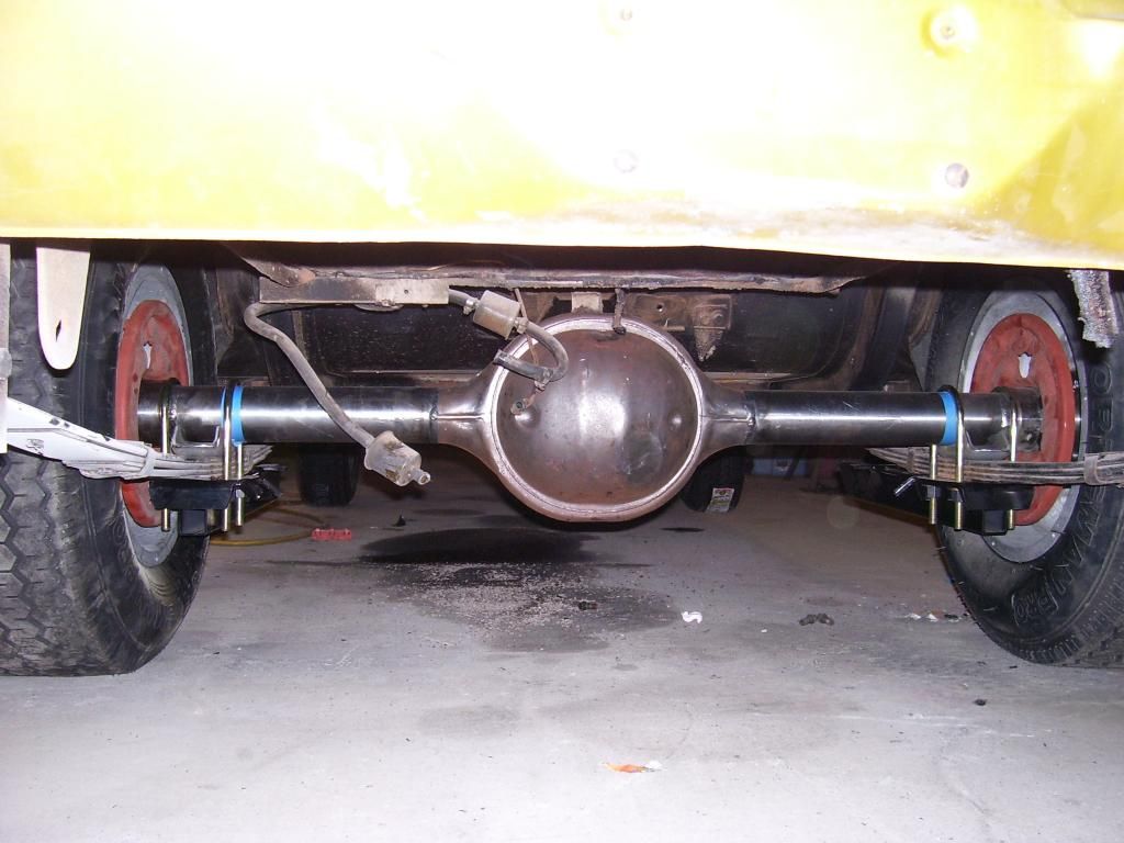

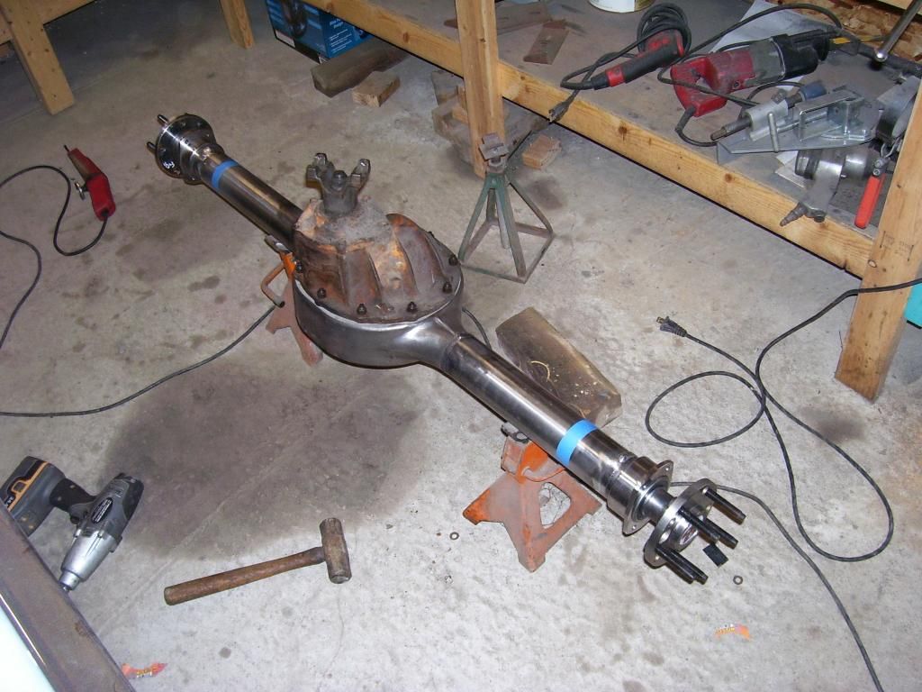

    I've used Quick Performance for years, since before they had magazine advertising! I've had Doug and the boys do a lot of rearend work thru the years. He will do them any way you want them, any spline, any width.
    Here's the QP custom made 9" under mine. 55.5" wide, centered pinion, 31 spline Moser axles, 4.5 and 4.75 bolt patterns, screw-in studs, 1/4" moly axle tubes, billet big bearing ends. I had the spring pads left off so I could put pinion angle where I wanted it.
