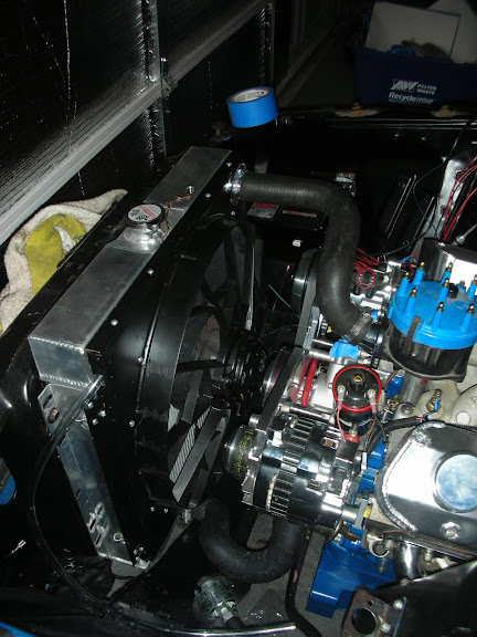

    Yeah, there are pluses to either design. Smooth welds and polished it would look sweet. I like the cut corners a little better because it seems to match the contour of the core support better, like in this pic from this thread http://mmb.maverick.to/showthread.php?t=49098&highlight=aluminum+radiator&page=2 :

    I found a couple of pics...
    Looks like mine is also taller. Them cut corners are growing on me.

    Humm... Maybe if you dropped yours down one notch it wouldn't look as tall. Or did you have to mount it on that slot for clearance below? I don't know if that one would even fit under my hood... :16suspect

    Won't mount up going to any other holes. I think being that it's a Comet, the hood has more clearance, but not sure. I crawled under neath and looked at the space between the hood and the top of the radiator and there isn't any. I was worried about that and closed the hood gently and checked before clicking it all the way. I think I have about 1/2" between the cap and the hood.

    Thanks for the info. I'm ruling that one out for me. I guess what I need to look for is a 2 row, cut corner one. Thanks for the help, Blu!
