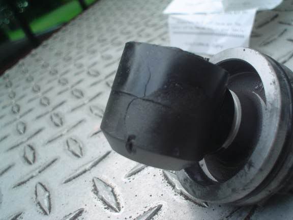

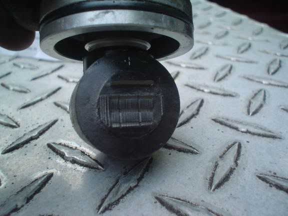

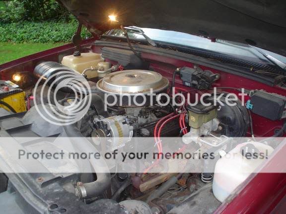

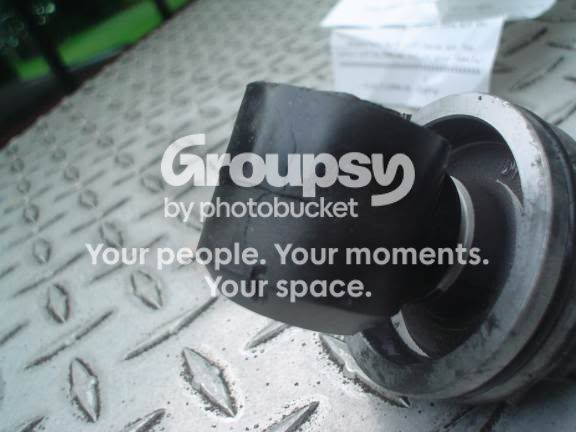

    I just replaced the speed sensor on the tail shaft of the trans. The old one was cracked and messed up, but I don't see any damage to the teeth up inside the trans (it's a magnetic pick up). The speedometer now works pretty steady at low speeds, but once you get up to speed it's still bouncing around. I'll try unplugging the ABS module next. I need to try and get this thing fixed tonight, because I need to drive it to NC tomorrow.
    Anyway, here's a few pics of the truck. I'll be changing the wheels, but it's not a bad looking old truck. I drove it to work today, and several guys were trying to buy it off me.
    I can't help but keep thinking a 351w would fit real nice in here: :D

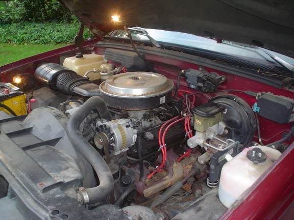

    Here is what I believe is the ABS module?
    The messed up speed sensor:
  2. Joe Dirt
    nice truck you can unplug the abs computer and the light will stop flashing

    I'm beginning to think the wires and/or plug going to the speed sensor aren't getting a good connection. I pulled into an empty parking lot at a closed down grocery store and drove it around at 15 mph. The speedometer worked intermittently. I came to a complete stop and it bounced up to 10 mph randomly a few times. I got out and shook the wiring and plug going to the speed sensor, drove around the parking lot again and it worked perfect for a minute or so and then quit working again. The wires feel old and soft.
  4. Mavman72
    Try to snug up the spades in the plug so they grab the pins nice and tight.Look for the usual...fraying...burnt insulation on the harness.
    Yes that is a pic of the ABS module.Sounds like you have narrowed down Jamie...Good luck.

    As suspected, the wiring was part of the problem. I checked the continuity from the plug to up further in the harness, and as I flexed the wire around it was loosing connection. Fixed that and discovered the cluster itself was also getting a bad connection, it was still acting up some after fixing the wire. I used the very technical, ASE certified method of slapping the s#!t out of the top of the dash and all is perfect now. :D I'm up in NC now on the wonderful dial up internet connection, but it made it up here fine, 70 mph with the cruise control on and A/C blasting most of the way.
