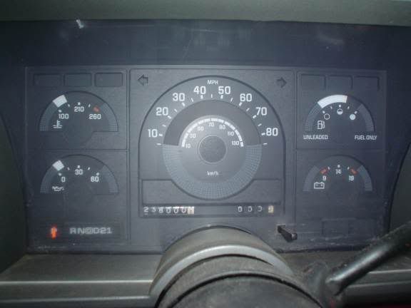

    So, I was at Pull-A-Part the other day, taking a walk through the newest set of cash for clunkers vehicles, when I came across a beat to hell '92 Blazer. I mean, if there was ever a vehicle that deserved to die by sodium silicate, it was this thing. Papers I found inside of it said it was from Michigan, it was rusted out and beat to death, 325,000 miles. I looked inside, and noticed the dash was identical to the dash in my truck. Then hey, look at that gauge cluster! Has a newer looking cluster with built in tach that fits in my dash! So I ripped that bad boy out and headed home.
    After a few hours of pouring over wiring diagrams, splicing the '92 harness connector and control module in to my '89 harness (all soldered and heat shrink covered splices), I managed to get 'er done.
    Out with old "half moons":
    In with the, well, slightly less old:
    I love it. The older clusters are notorious for problems. Every time you drove the truck, you had to pound on the top of the dash to get the speedometer working right. So far the new cluster has been working excellent for the past few days. Only issue is the trip odometer is messed up, the mechanism that makes it work is broke. So I'll have to keep an eye out for another one of these cluster in the junk yard to swipe a trip odometer out of. But the regular odometer works great, was showing 325,465 when I put the cluster in. The one in the old cluster had been stuck at 238,000 for quite a while. No doubt the mileage on the new cluster is probably in the right ball park for the truck.
