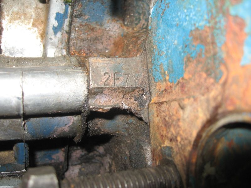

    Near the C8OE should be a three or four digit date code, consisting of a number, letter and one or two more numbers... Also on front where timing cover mates will be a stamped date of engine assembly... Guessing since there is no partial VIN it is a early '68 model year engine which could still have been in a Shelby...
    the 2E11 on my Comet means block was cast May 11 1972... (date for 1967 would start with 7, codes repeated each decade)
    2F7 is June 7 1972 which is actual day of engine assembly... (Ignore Y, is a inspectors mark)...

  8. alaskamaverick
    alaskamaverick Member
    May 15, 2011
    400
    17
    138
    Spokane, WA
  9. Krazy Comet
    7,793
    2,478
    Unless it was a warranty replacement engine(which could be why there is no stamp on top of block) it's never seen a '68 Shelby, 9E20 is May 20 1969...

    Sorry for bad news but a engine block that was cast in May of '69 could only be a replacement or someone stuck it in a Shelby... In this application originality is paramount, a non orig 1969 302 isn't worth any more than one from any other '69 model(GT-350 used 351 in '69)...
