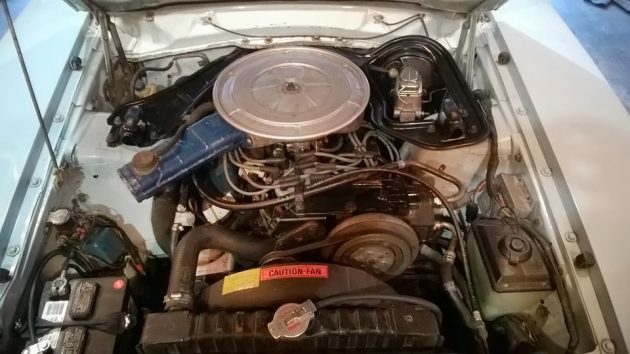

    I'm new here but not new to classic cars. A neighbor had a 72 comet in his barn at a price I couldn't say no to. So now it's in my driveway. Parts for most of the usual issues are either installed or on their way. I'm leaving the L6 I nit for now until I get the usual electrical and suspension bugs worked out of her. As I'm buying parts I'm keeping the crate 302 planned for next year in mind. I'll also be adding disk breaks all the way round, a 9" rear end, some fiberglass to make her stand out, updated lights..... lots of goodies. Since I've been a long time Mopar guy and avoided all things Ford like they are sacrilegious I've got lots of questions before I start throwing money down this most recent hole.
    1: Are there a set of front spindles that are factory bolt in for the disk brake swap or a kit that doesn't require machining. Alternatively, does anybody know someone around Knoxville Tn that could do the machining. I'm sure I could manage it myself, but I've got several business to run and my wife will be the one driving most.
    2: Master cylinder and booster suggestions that will fit into the crowded bay after a 302 gets shoe horned into it.
    3: rear springs suggestions, concerns and general no goes for the 9" swap.
    4: wheel spacing concerns after the disk brake swap. I want shiny things and there is a potential analysis paralysis of choices out there before I've got things installed to measure. I'd prefer to stay away from any known issues at the beginning of the build.
    Im sure Ill have more questions down the line, but I'm looking forward to hearing from people. even if its to have you tell me to use the search function to answer my own questions.
