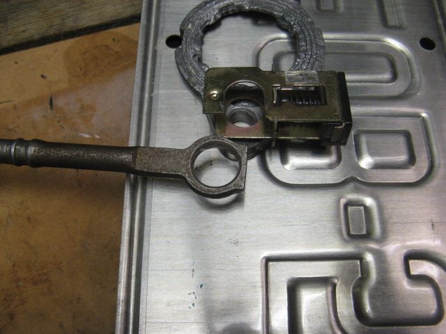

    It mounts like this(left side view) ... Not shown there should be a small nylon spacer placed on pedal stud first, followed by the M/C rod with a bushing inside the opening and switch placed on stud at same time(yeah can be a PITA)... Finally there is another spacer, followed by retainer pin...
    Here are parts with a extra switch and retainer pin...

    KC, Thank you for taking the time to mock that up! Awesome example and explanation...
    I have the same switch (because I just bought it) but the pinning hole on the MC rod is a yoke thats just the width of the pedal, and it slides around both sides, then pins through. The pin is small, I'm not sure about the pedal hole yet, I'll check when I get home. There is no plastic bushings or washers. The switch fits around the pedal nicely, but it doesnt fit between the yoke and pedal. I dont know...maybe I'll just stretch it wider and try again.

    I've not used a rod with rounded end, the Ford rod is flat and can move slightly so it closes the switch contact...

    That looks like a custom rod that someone cobbled together. You will want to get a factory style Rod if you want to use the factory brake switch. FYI the manual and power assist rods are different, with the power one being longer.

    Comparing KC's and Paul's pictures to what I have, I am thinking someone converted my car to power brakes. Maybe my pedal and all is just different. I don't have the stud on the side of my pedal like in Paul's photo, mine is a pin all the way through. It doesn't look like a torch cut the stud off, so the pedal must be from a donor. Maybe this is why the old switch was jerry-rigged under the dash.
    I'm still going to try to install the factory switch and see if it functions, but if not, I guess I'll have to figure out another solution.
