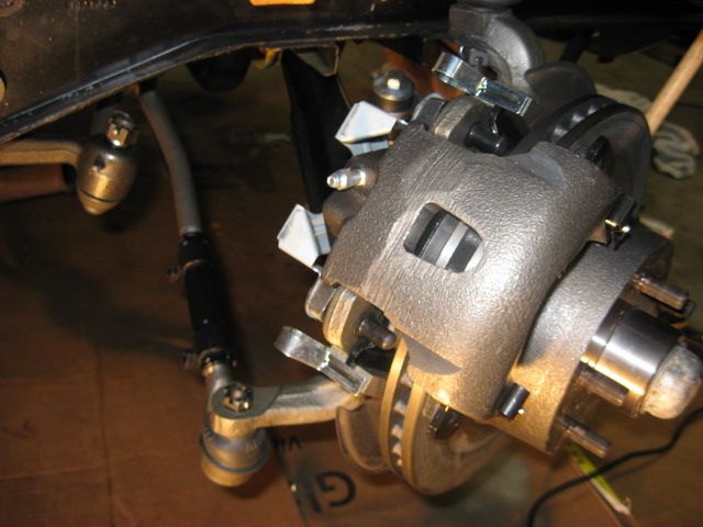

    So I figured out the drums on my own, but has anyone ever used mustang front brakes? Because mustang parts are so much easier for me to get, so would the discs, and calipers from a mustang work with a maverick?
  7. Krazy Comet
    7,791
    2,476
    I have '69 Torino brakes on my '72, are basically same from '68-'71 and '68-'73 on Stangs... Wheel bearings and tie rod pin size changed from '69 to '70 but otherwise are identical...

    So your saying 68-73 calipers and rotors will just bolt right up with a ball joint change?

    I'm going with the Grenada set up on mine after all the research it is the easiest way to go about rhis
