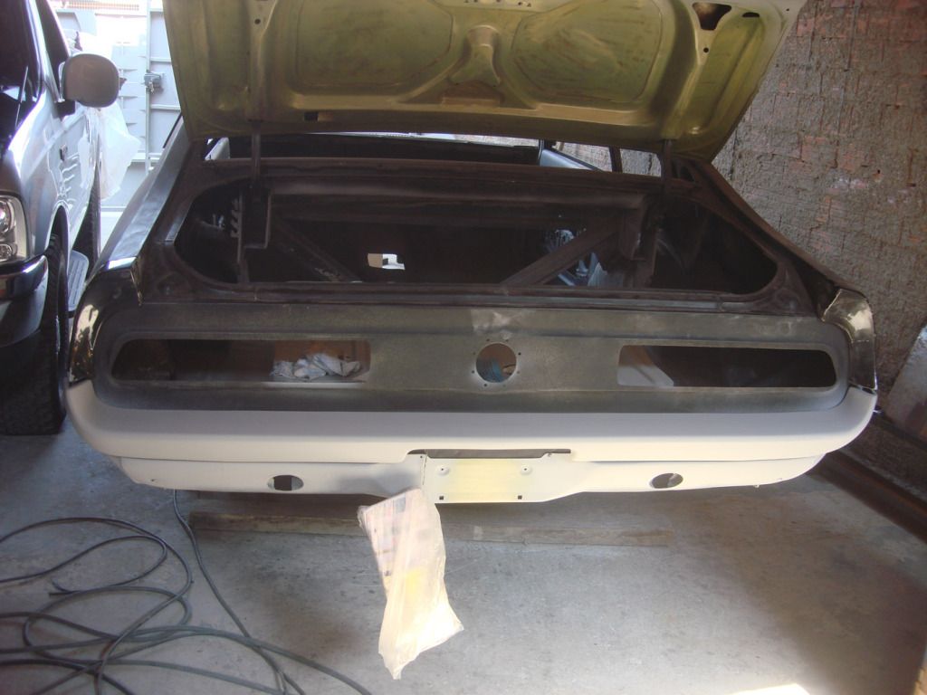

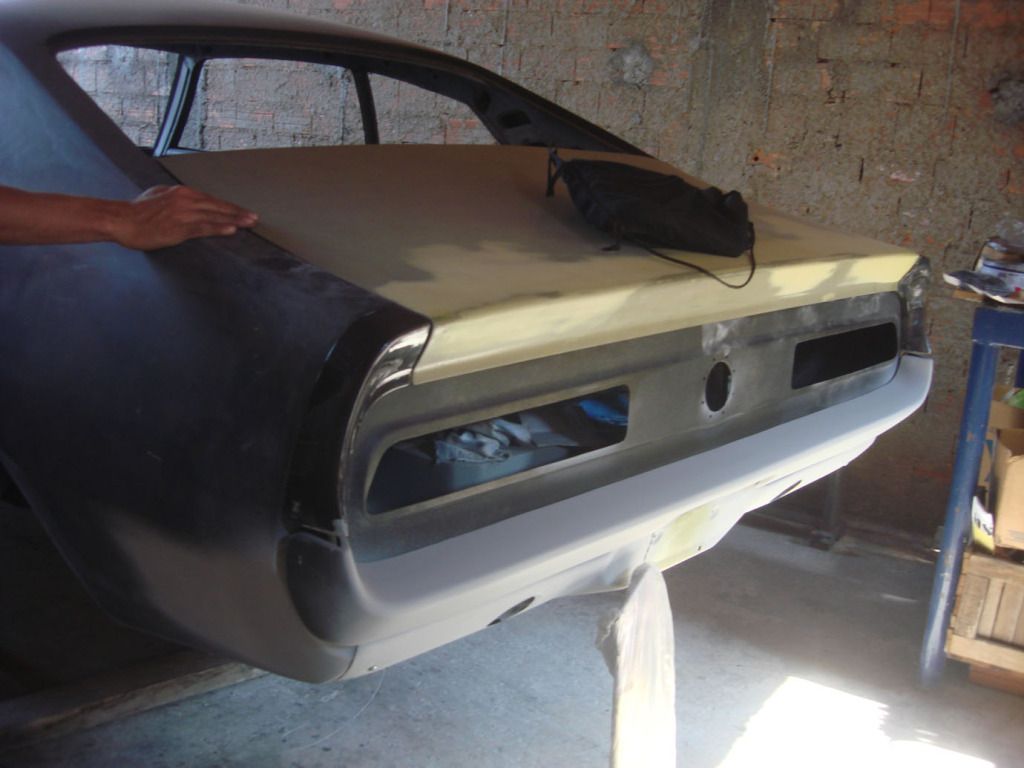

    I wanted to know if you just cut a hole in the existing tail panel or did you weld in portions of a 1969 camaro tail panel so you had the lip that was stock on the 1969 camaro. I also wanted to know how you attached the tail light lens and housing to the tail panel on the car? Did you graft in the existing mounting bracket that was on the 1969 camaro tail panel?
    I was just hoping I could pick your brain on how you made it work.
  2. topolino
    topolino Member
    Sep 21, 2011
    487
    Brazil
    in fact, the initial idea was to use parts of a camaro rear panel.Inclusive got to buy the parts but the person who sold me, took forever to deliver the parts, then,to not delay the building ,I decided to cut the rear panel existing in Mav.
    Then I soldered some screws directly on the panel and is done! easy easy :clap:a piece of cake!

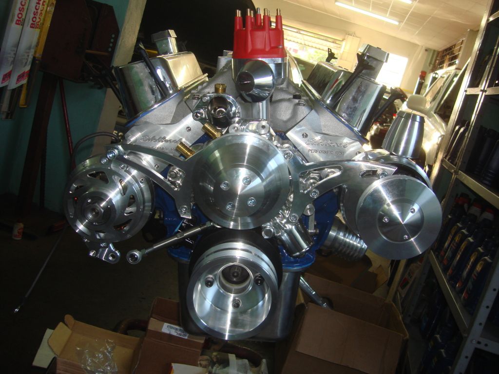

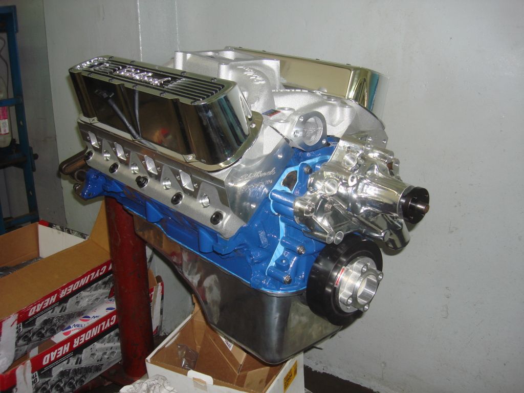

    Love the pictures, motor is looking tops! :thumbs2:

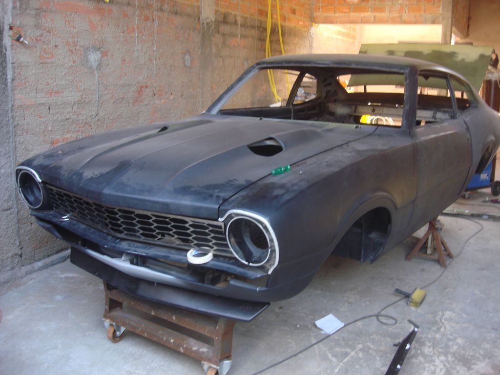

  13. JDixon
    JDixon Member
    Jul 29, 2012
    Greenbrier, AR
    77 Maverick

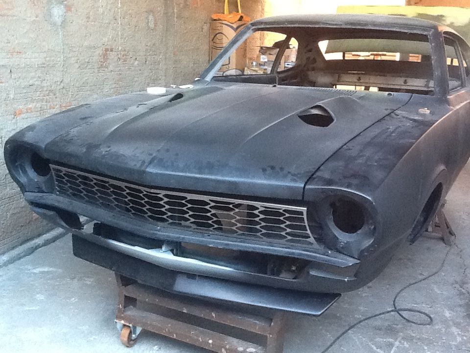

    Really digging everything you're doing up till the grille. Course it doesn't matter what I think, it's your car..(y) I think the holes are just too big.
  14. topolino
    topolino Member
    Sep 21, 2011
    487
    Brazil
    :thumbs2::thumbs2::thumbs2: thanks man!! all opinions are welcome!!
