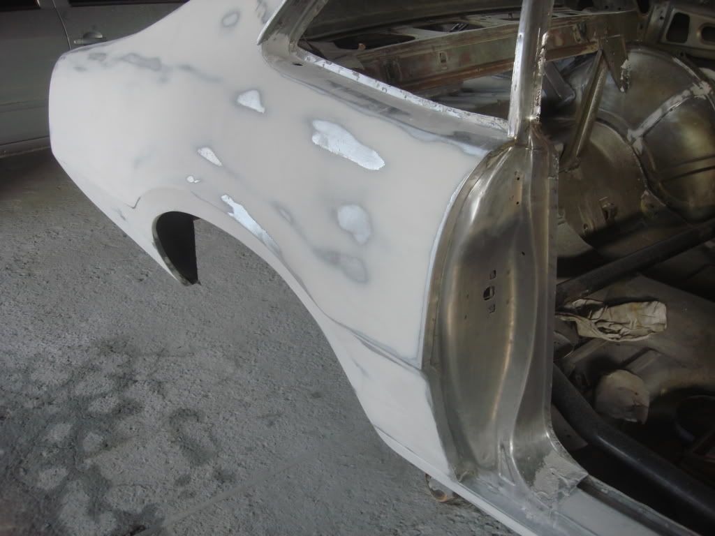

    LOL...I'm crazy .. I know that .. :oops: but not so crazy as to let go of my black maverick! only after I die!:thumbs2:
    I wanted to build and sell .. but 15 minutes after I buy the car, I changed my mind! she is in very good shape! of course I'm not going to spend that much in the orange,will be way simple, but I will leave it well cute;)
    so..I will stay with the 2! I'm also finishing a challenger 73 440 pretty nervous :dancing:

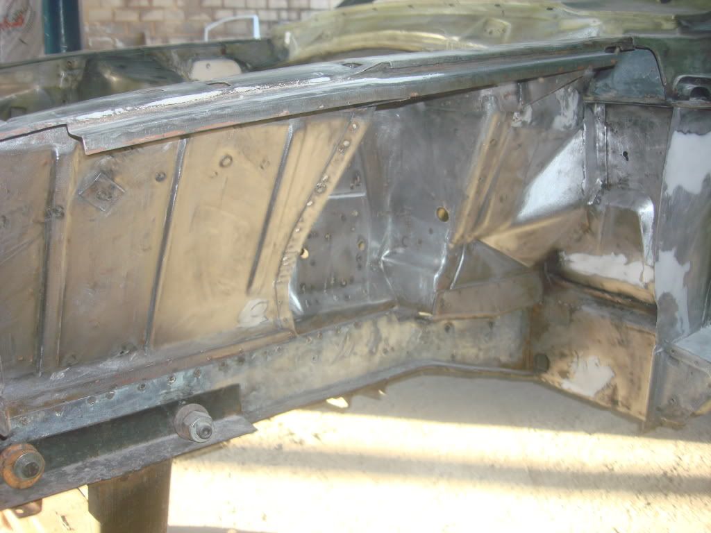

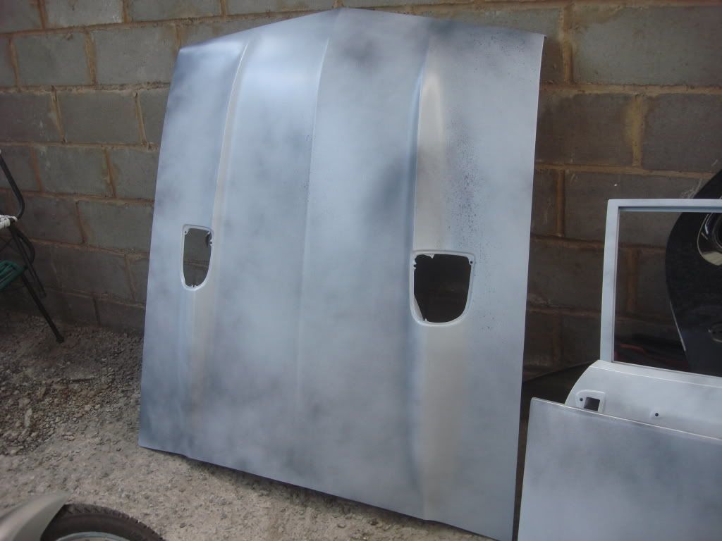

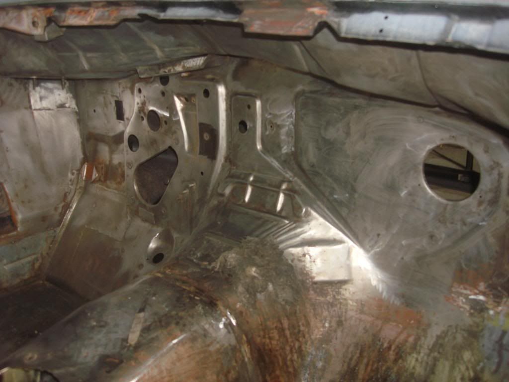

    so..here we go again!! wash primer off...

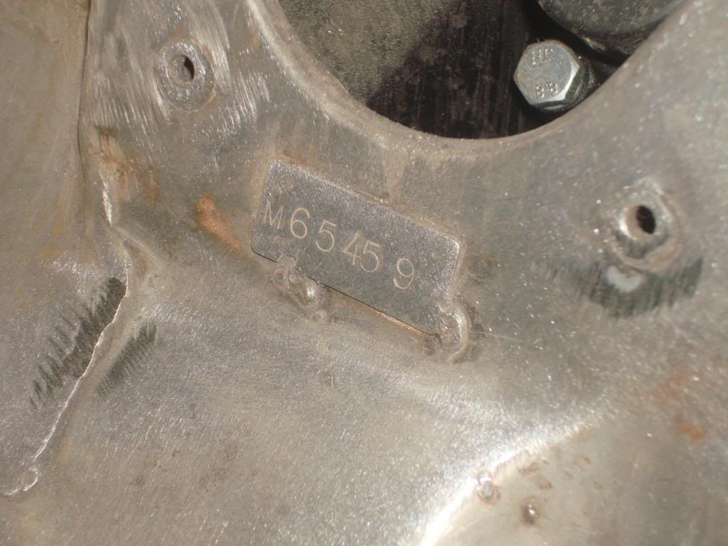

  2. mav1970

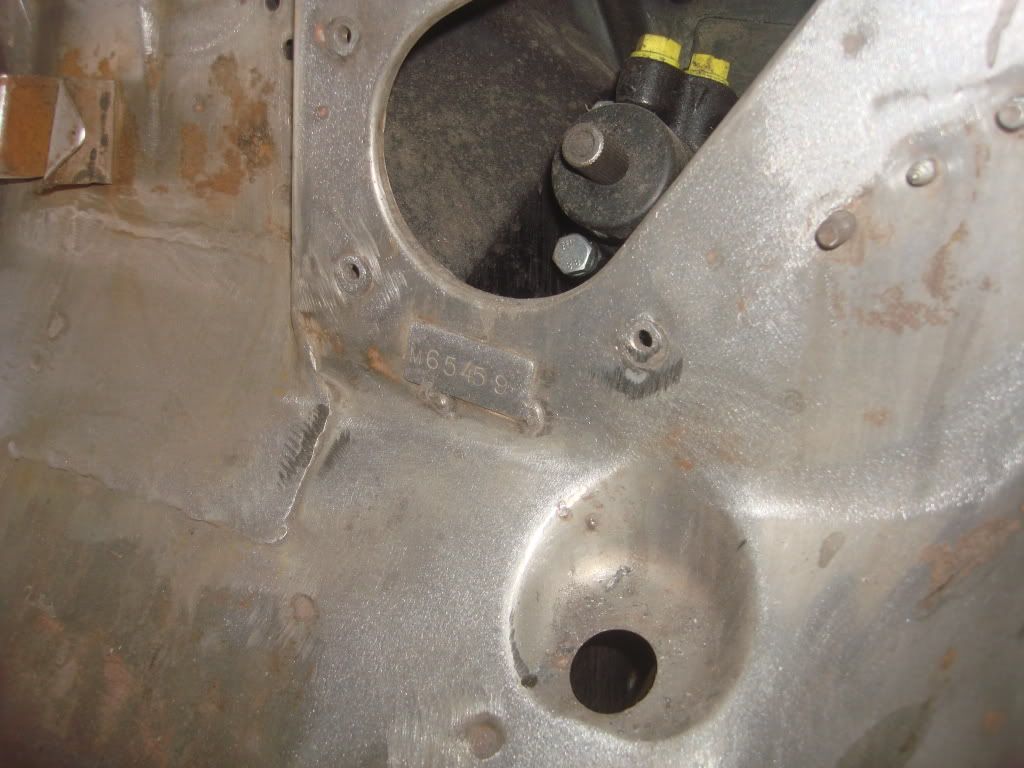

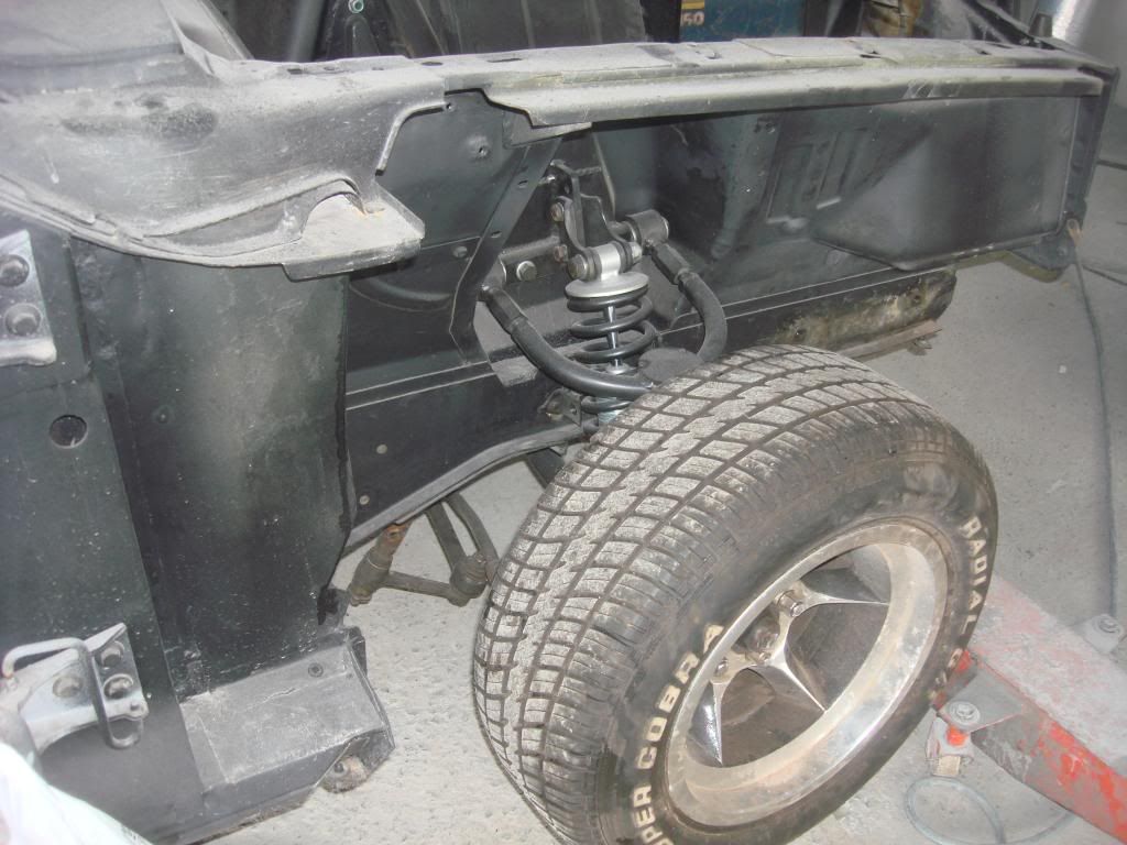

    Where is this number plate welded on your car and what do the numbers mean?
  3. topolino
    topolino Member
    Sep 21, 2011
    487
    Brazil
    this number is close to steering wheel column hole,and I have no idea what is :cry: and not match with any number of car

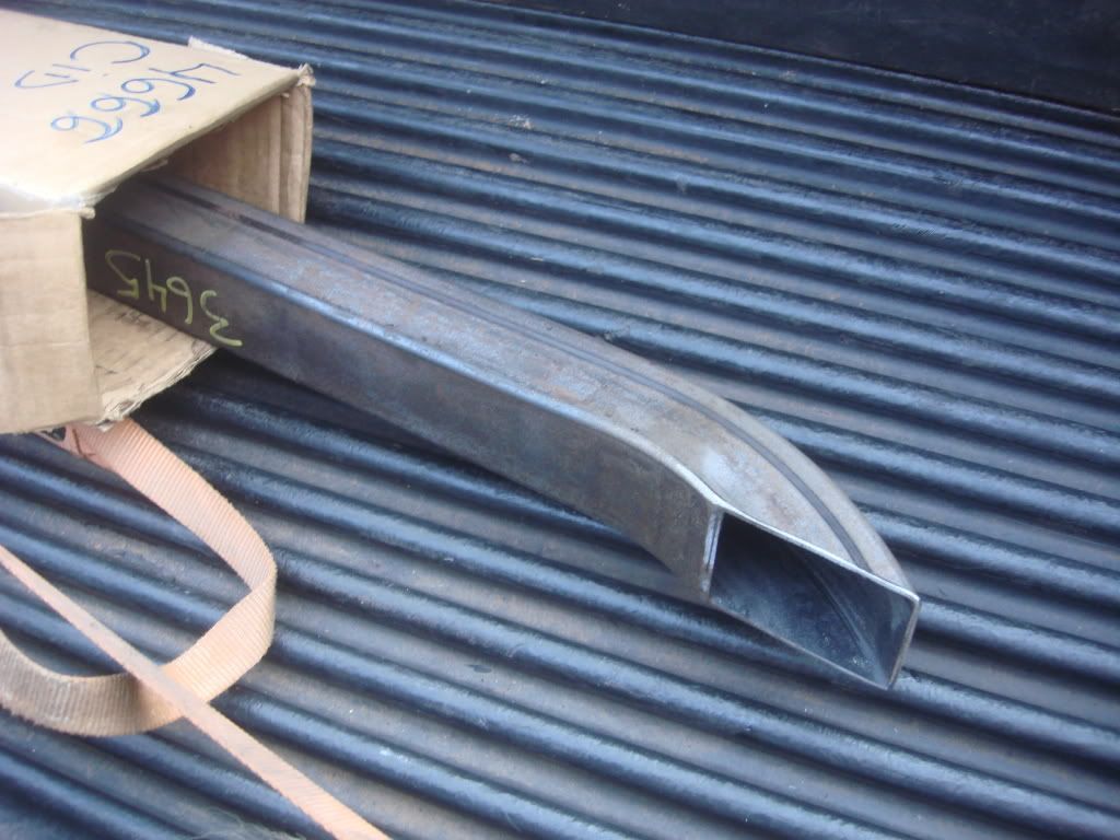

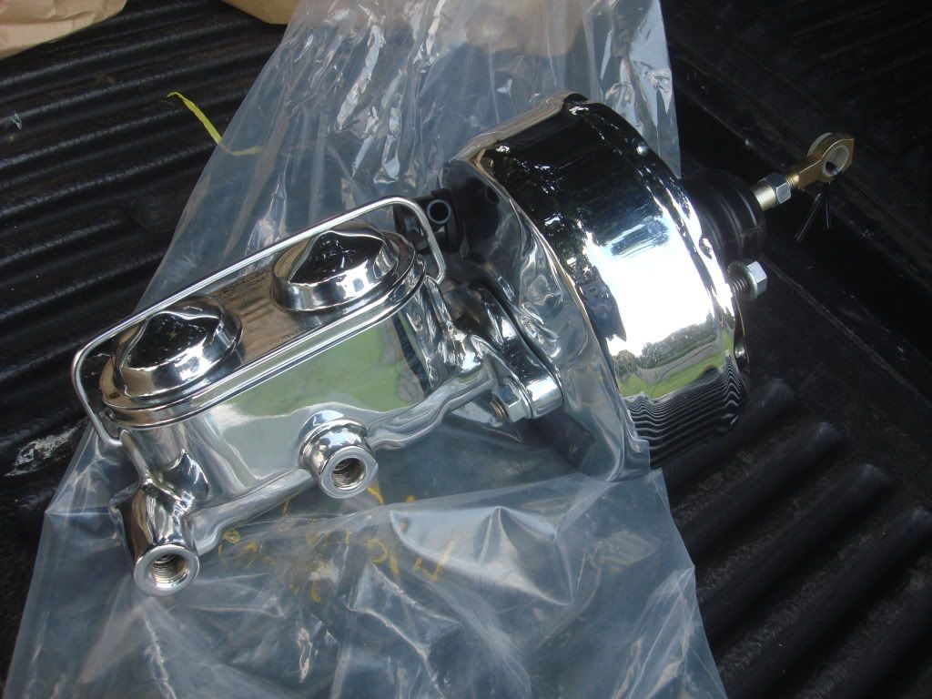

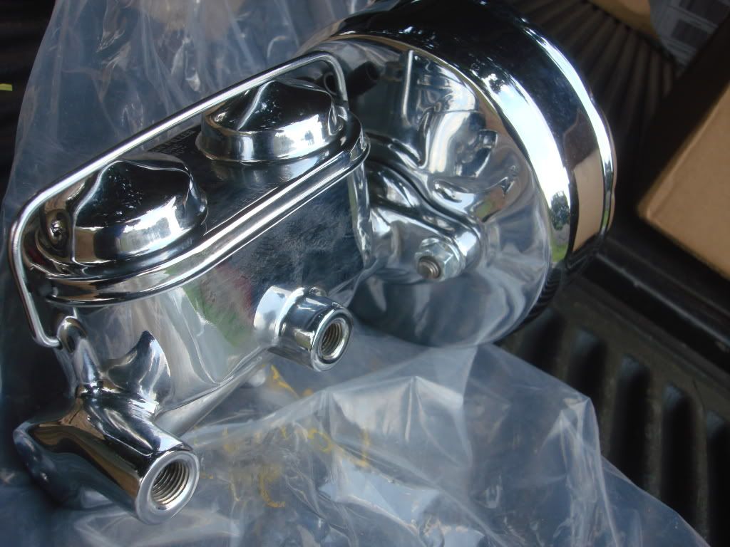

    Finally!!! a power brake !! that was hard to find!! looks great also :bananaman:bananaman:bananaman:bananaman
    THE BOOSTER SIZE IS 6" WIDE BY 9" LONG IT WILL CLEAR THE TALL VALVE COVERS. AND IT FEATURES A ADJUSTABLE ROD THIS WAY YOU CAN CHOOSE THE BRAKE PEDAL HEIGHT.

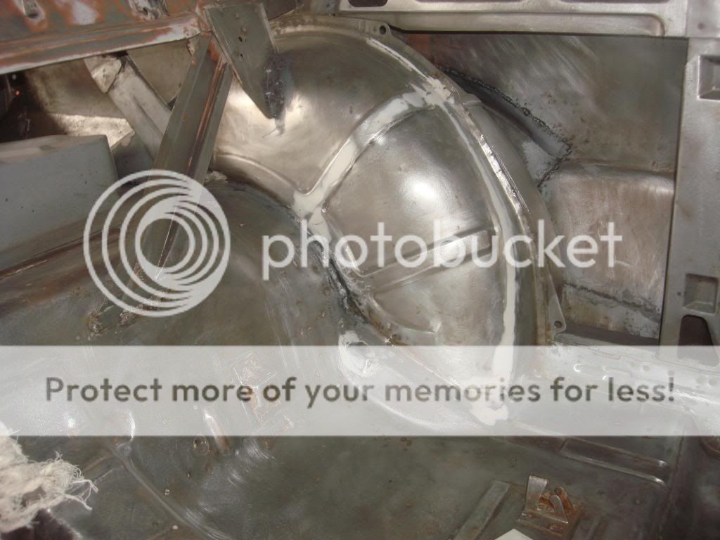

  6. GrabberGT
    GrabberGT Chris
    Sep 22, 2003
    1,626
    167
    Fort Worth Texas
    72 Grabber 302

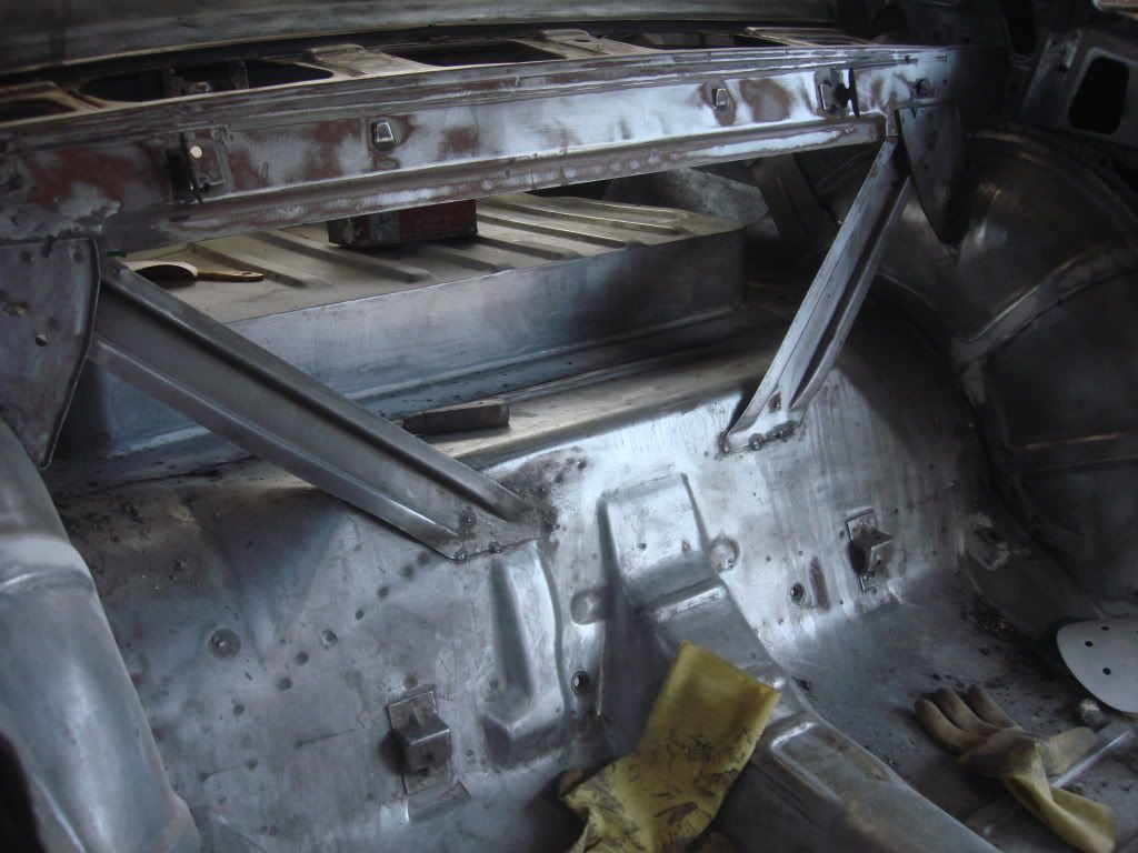

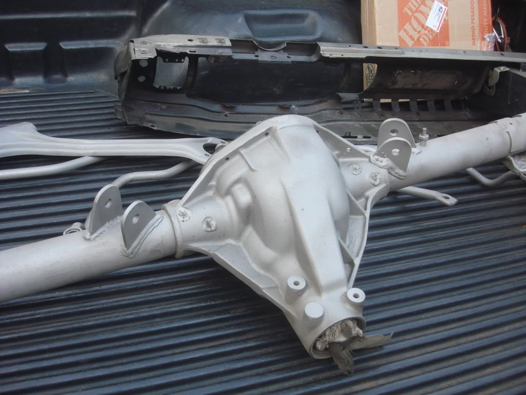

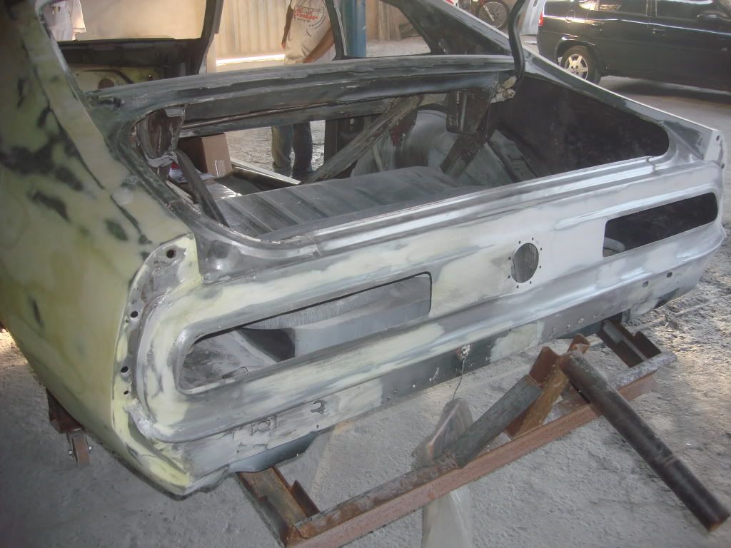

    I must have missed it. Whats up with the raised floor in the trunk?
  7. topolino
    topolino Member
    Sep 21, 2011
    487
    Brazil

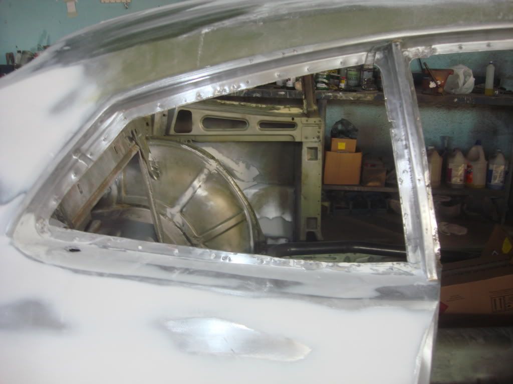

    you mean this?
    I raised the floor of the trunk so the gas tank does not stand in front of the differential and suspension, when you look at behind the car. (y)
    in other words,just to show the diff and sus
    here is the gas tank in place

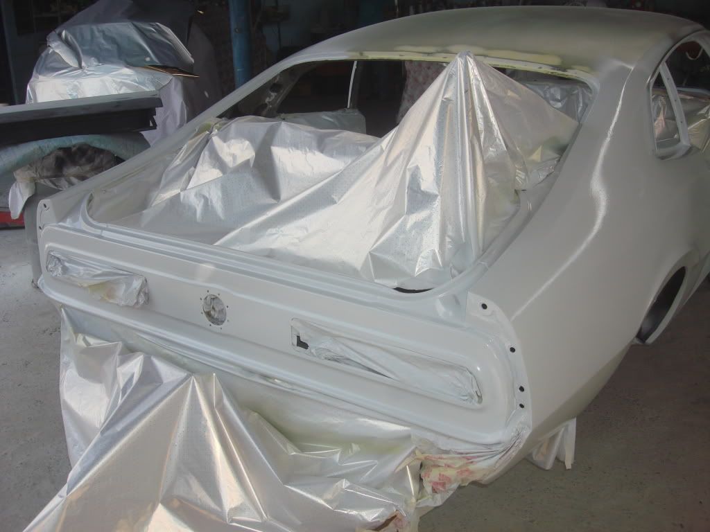

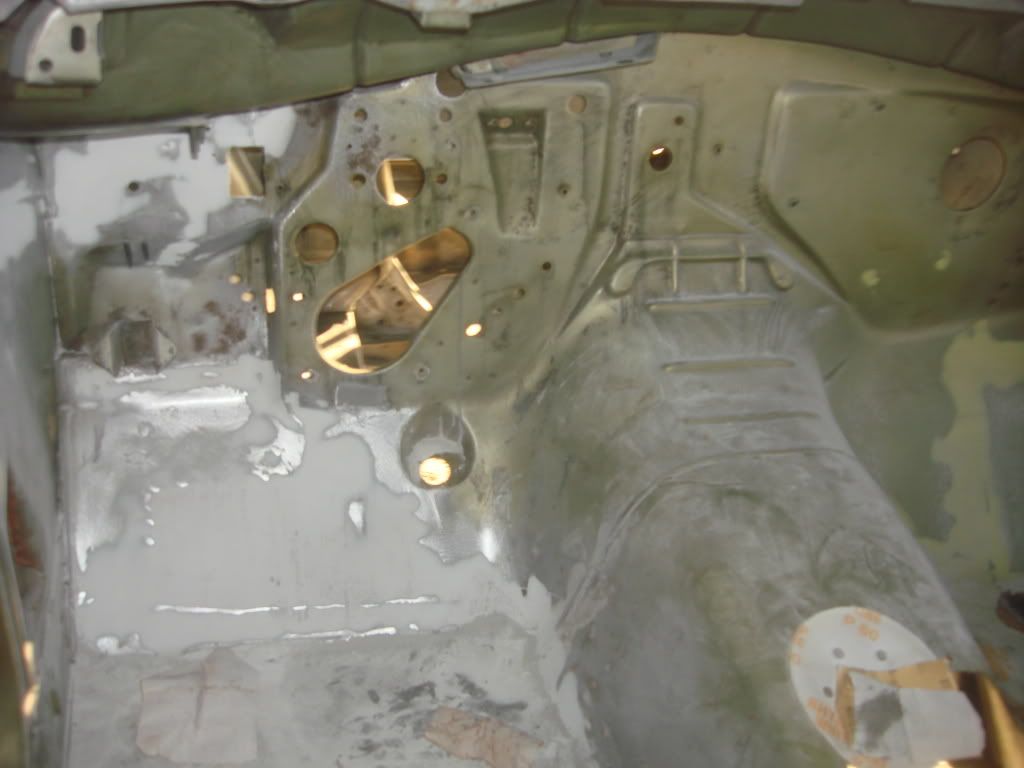

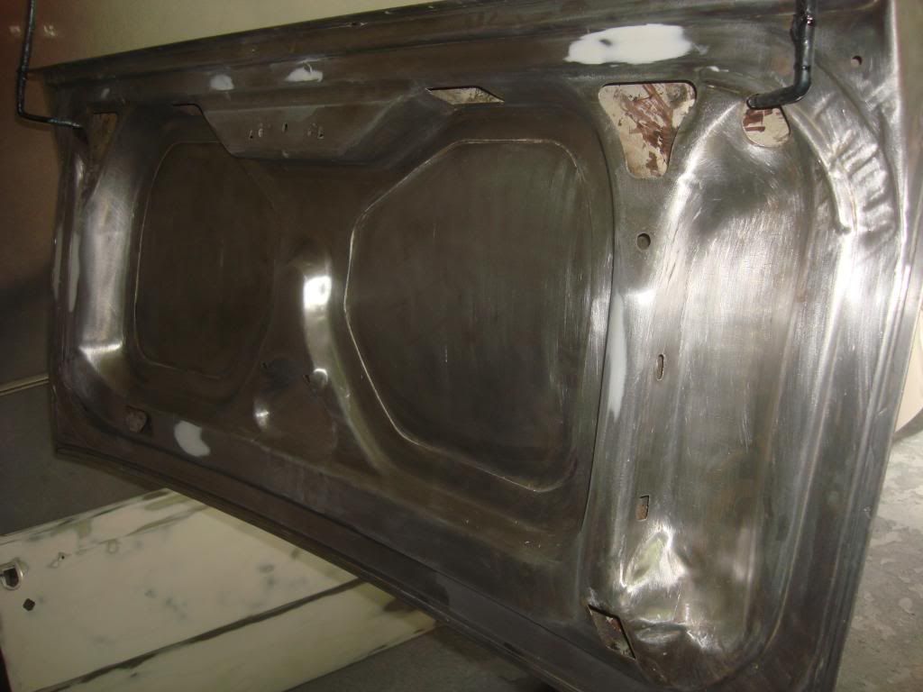

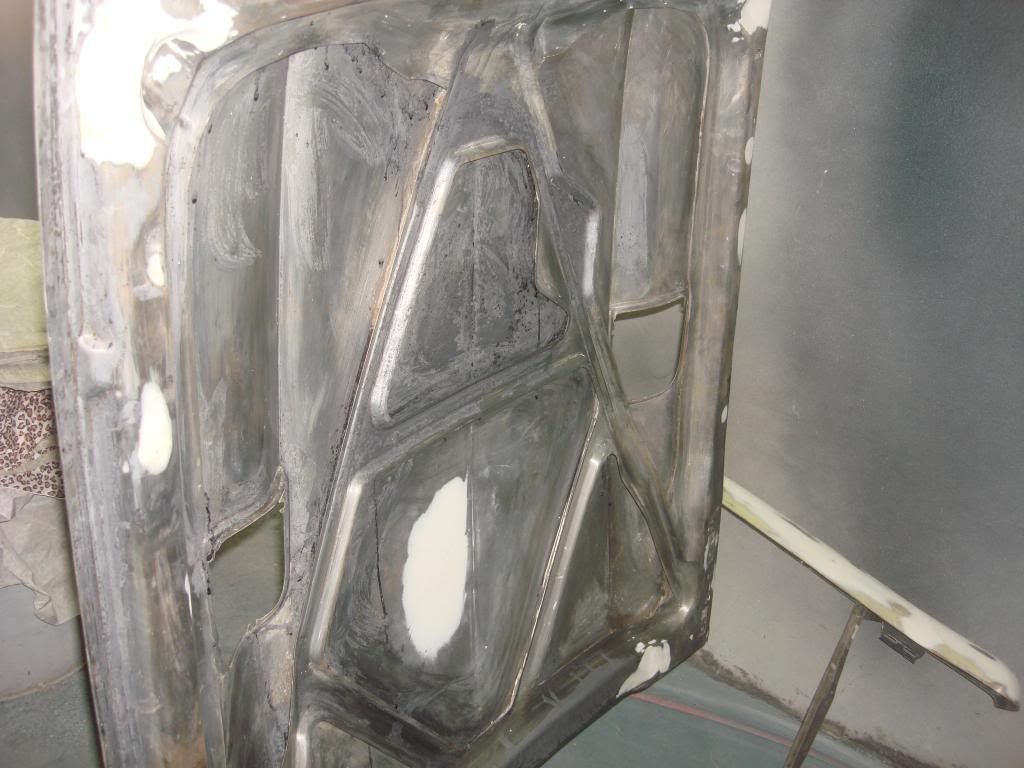

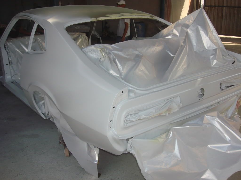

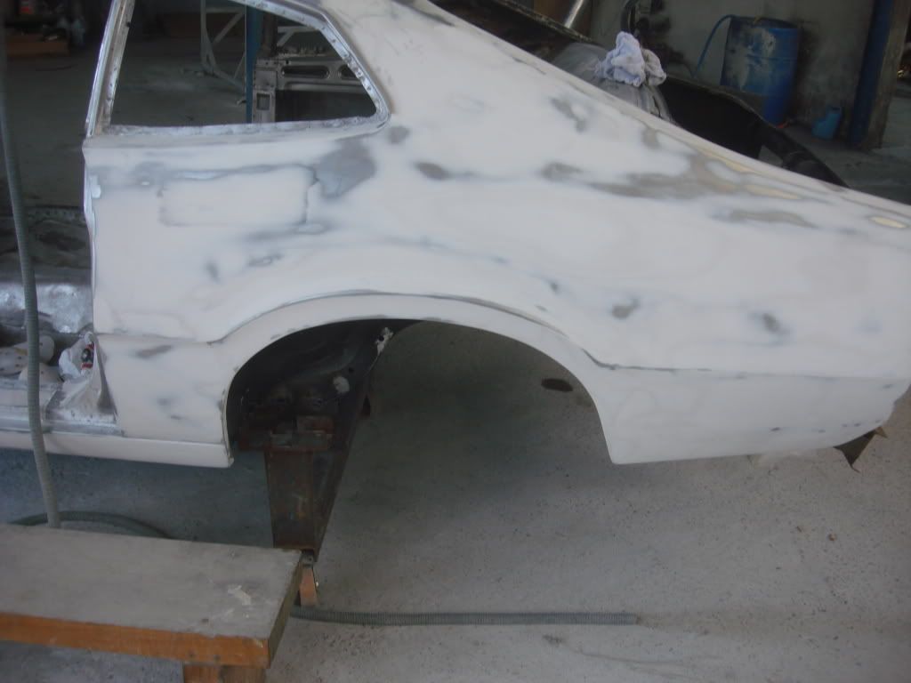

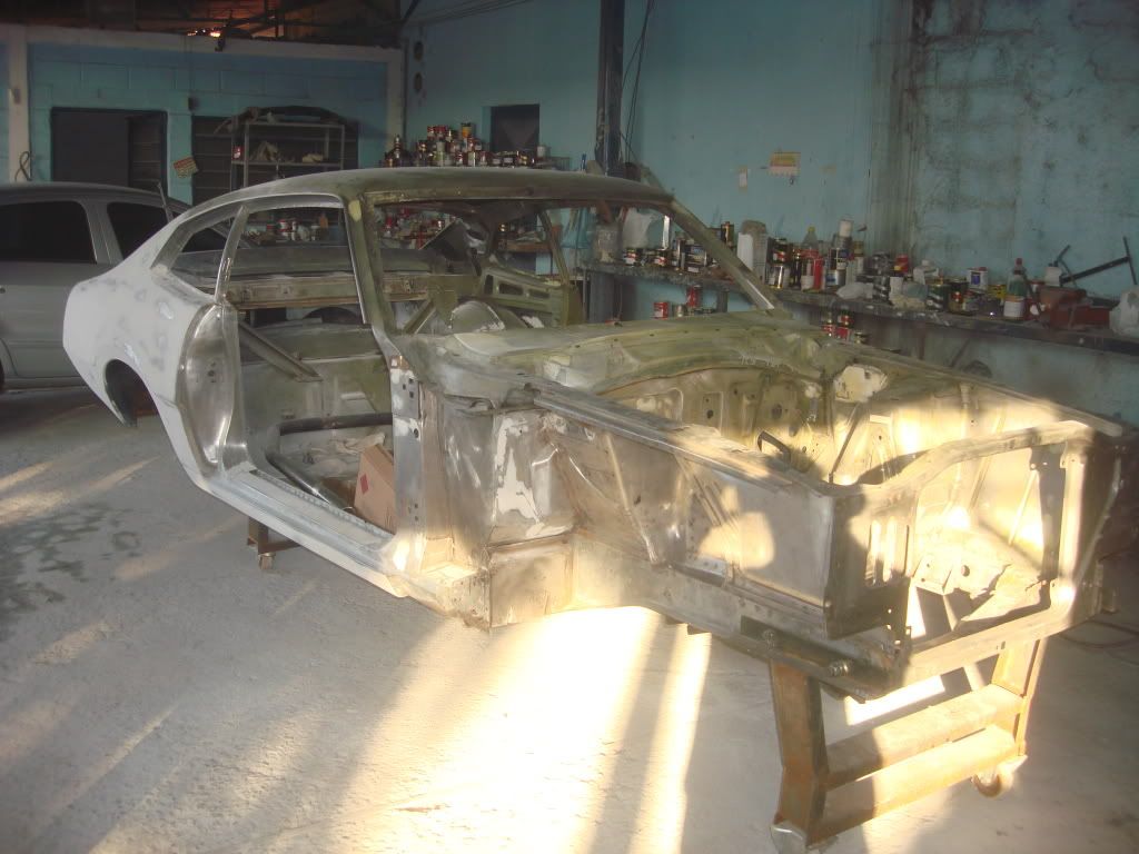

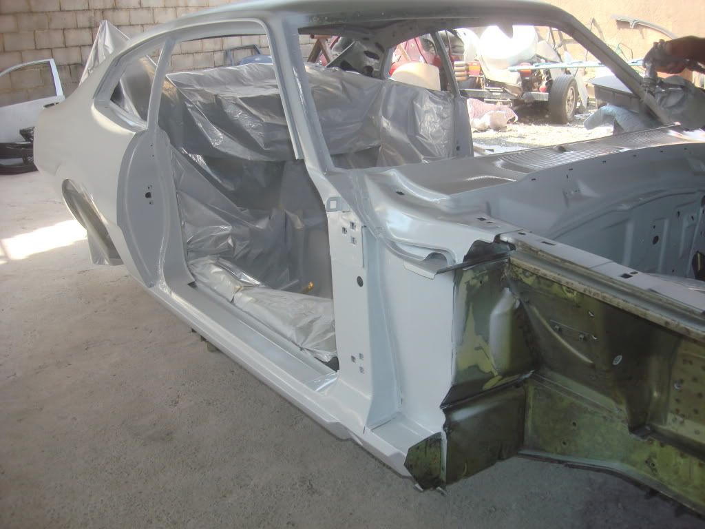

    the body is almost finish .....:bouncy::bouncy: I guess next week will be painted :yahoo:

  11. Paul Masson
    4,123
    752
    1971 Grabber
    That looks so awesome! :bowdown:
    How come the roof isn't primed? Are you just painting in stages?
    Keep up the good work! This thread is full of WIN!
  12. topolino
    topolino Member
    Sep 21, 2011
    487
    Brazil
    Thank you my friend!:thumbs2::thumbs2:

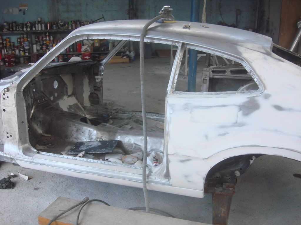

    the roof has not yet Primed because I took the photo at the exact moment that Primer was being applied, note the second photo the paint gun in action.
    cheers!

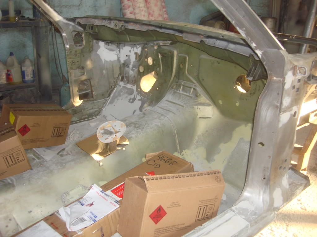

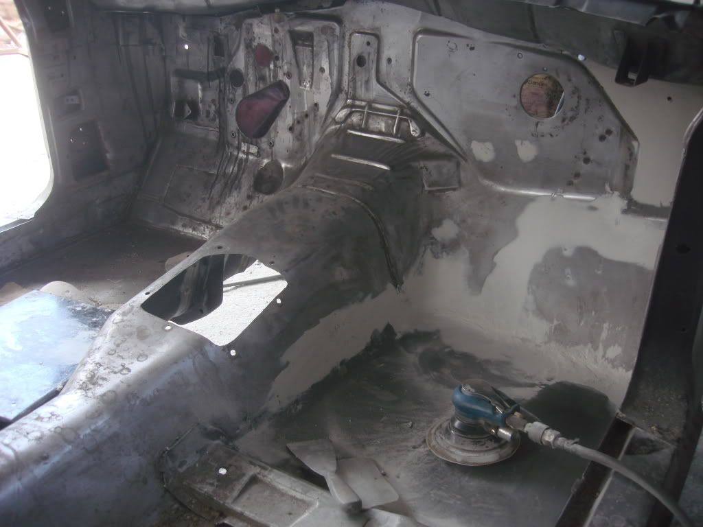

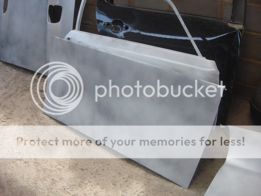

  13. John B
    John B Member
    Mar 28, 2002
    622
    187
    Ontario, Canada
    '73 Mav

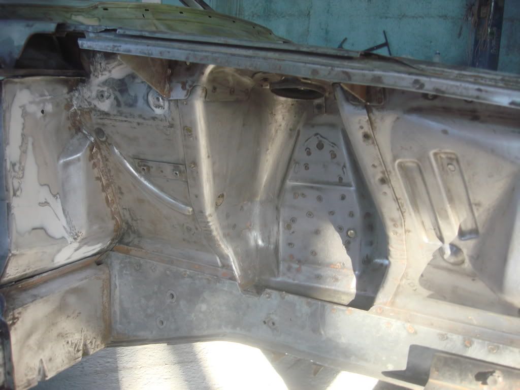

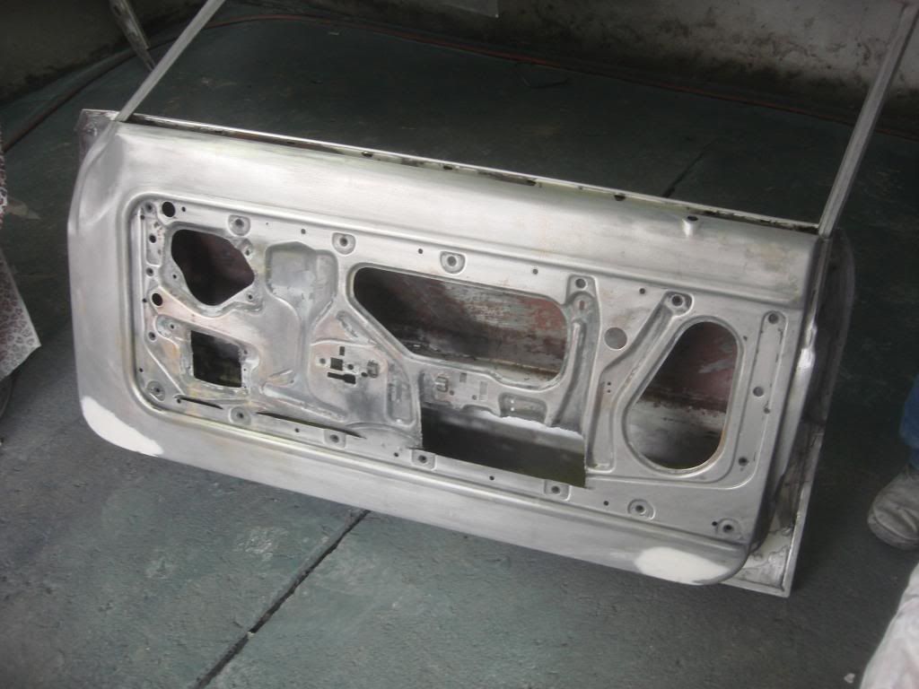

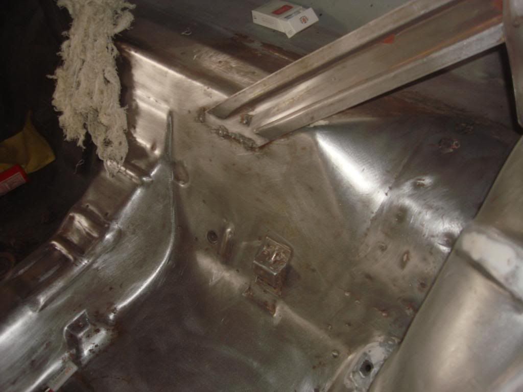

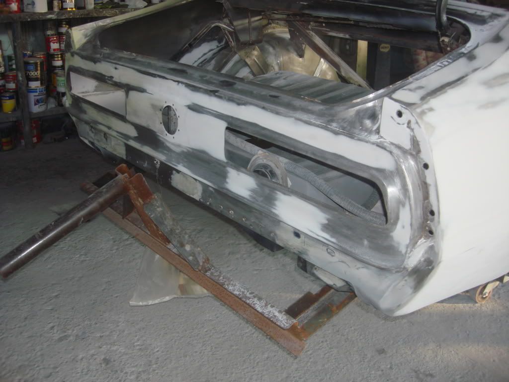

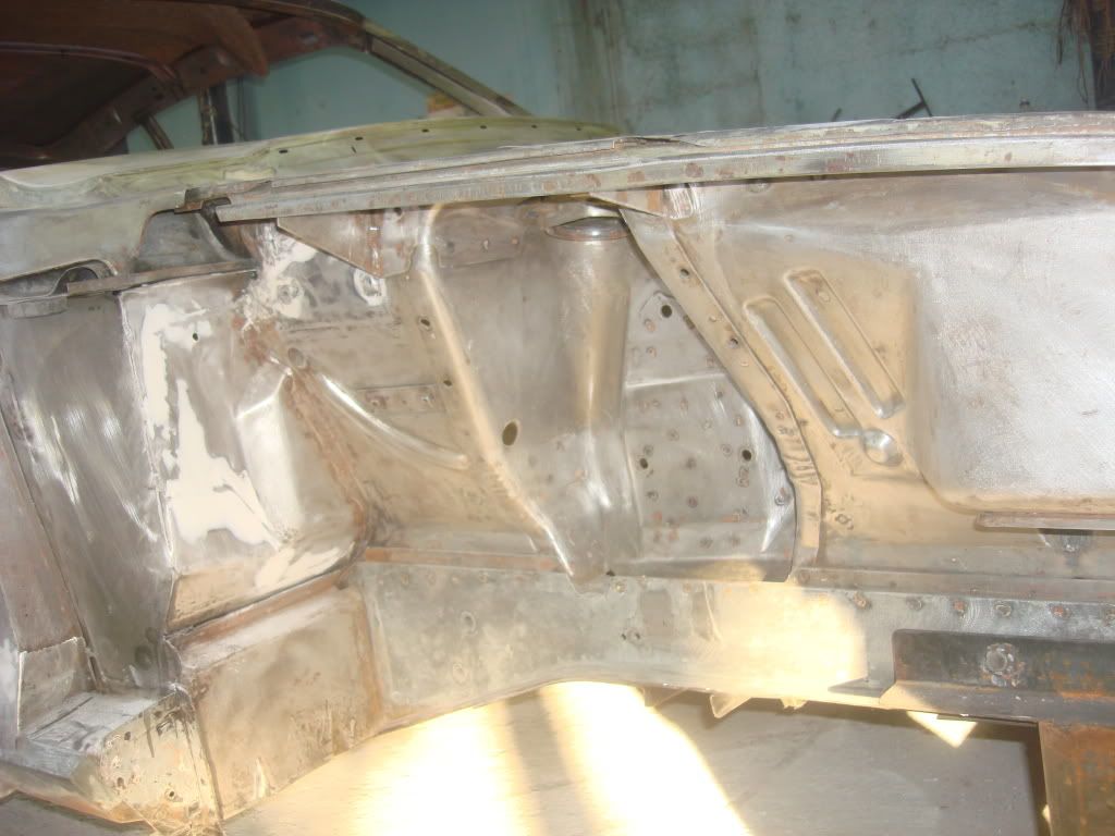

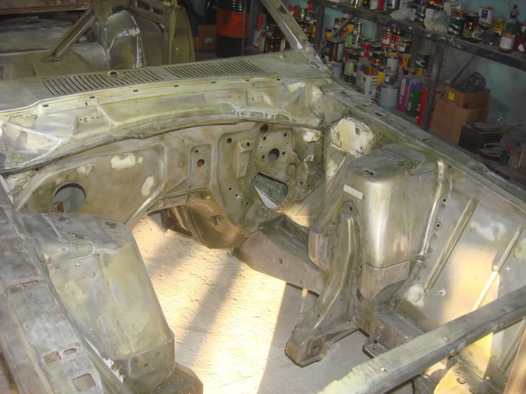

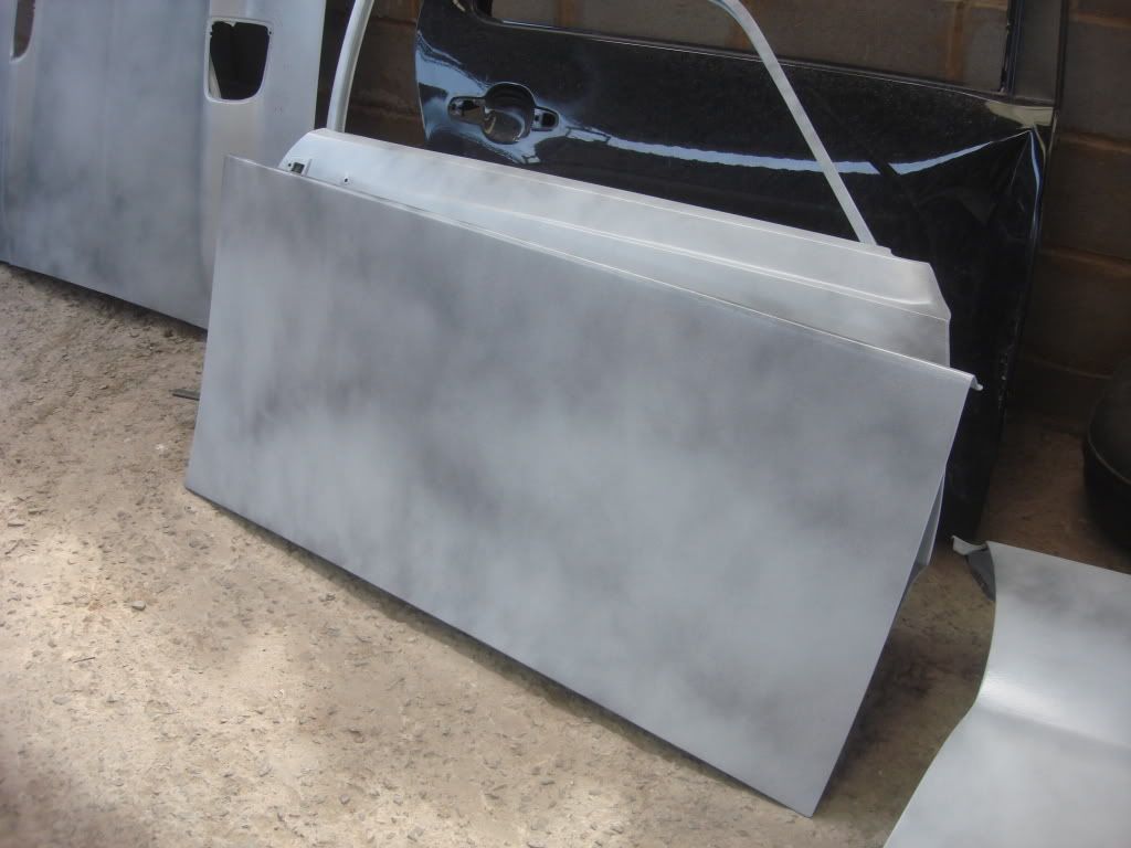

    I've read through your thread and didn't come across an answer to this. If I missed it, I apologize, but I was wondering what process you used to strip your body and metal panels to bare metal? Were chemical strippers part of the job? Thanks. An amazing build! John B
  14. topolino
    topolino Member
    Sep 21, 2011
    487
    Brazil
    Hey Man!!
    Yes,To remove the paint in the beginning of the bodywork, we use chemical. we leave the body in bare metal.
    then a coat of Washprimer to prevent rust.
    Now, in the paintshop, 'to remove Washprimer, we just use sandpaper! no chemistry!
    3 people sanding all day for almost a week! the entire body!!
    then a coat of epoxy seal, then a coat of primer ... more sanding and finally painting!
    then more sanding, paint, 6 coats of varnish with sanding in between.
    PPG everything! :thumbs2::thumbs2::thumbs2:
