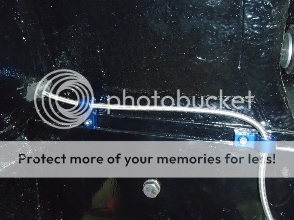

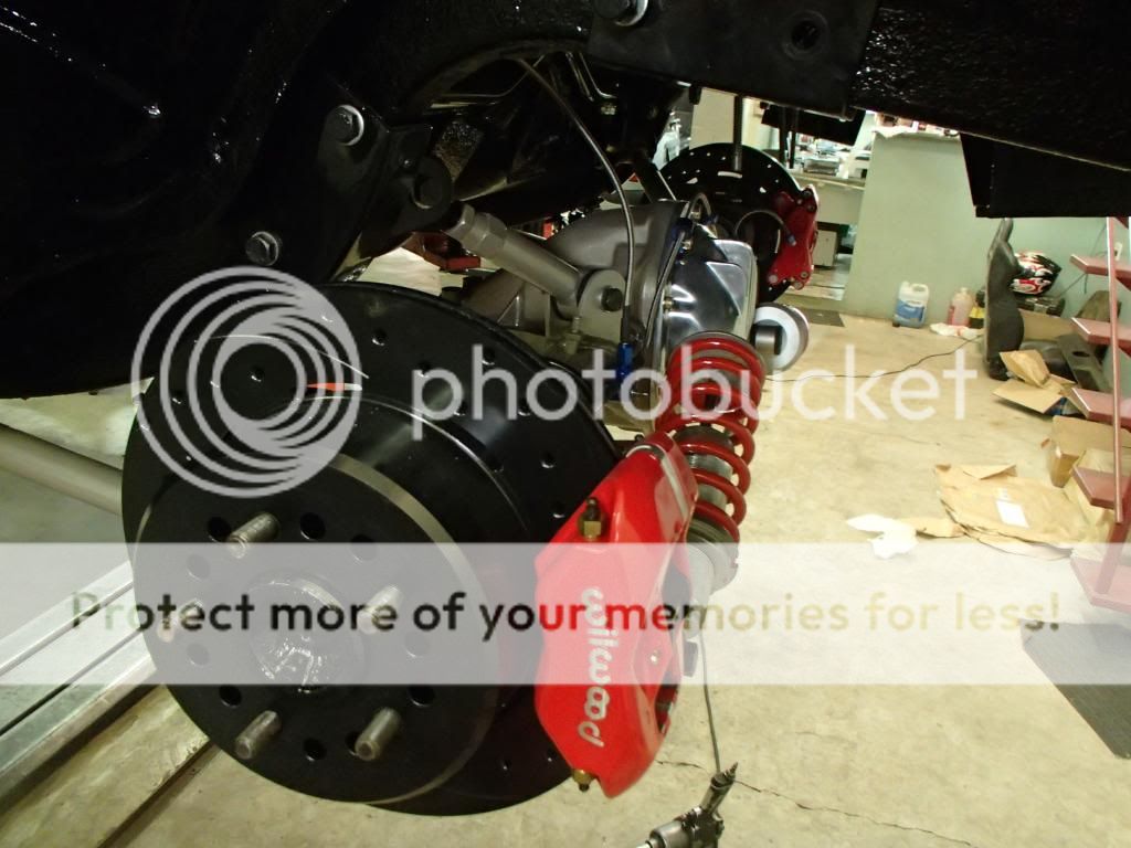

Great work on the car so far this is a really outstanding build! One word of caution be careful using a lot of braided line for you brake lines it may result in a spongy pedal. I know Wilwood recommends hard line for the rear and as short a hose as possible to go from the chassis to the rear. Again outstanding build I can’t wait to see it completed.

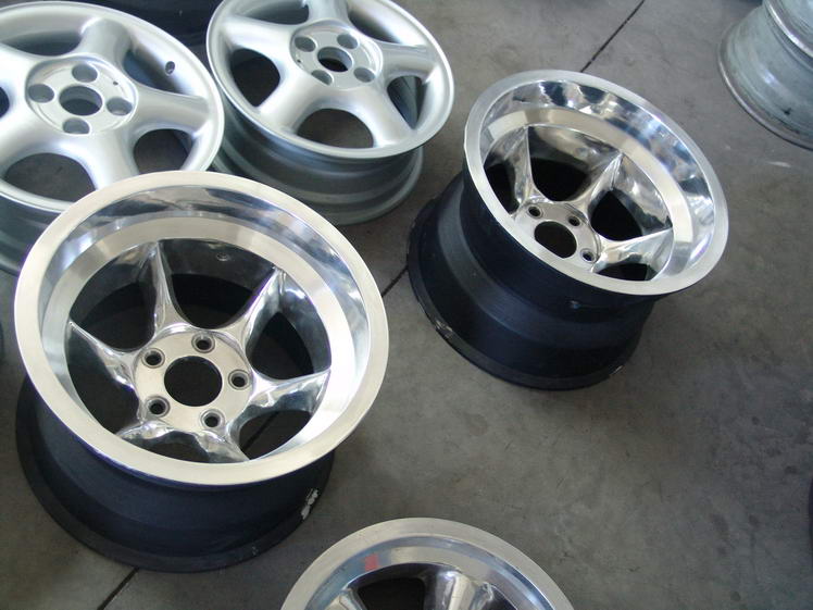

the wheel is "gaucha" .. They are for the Brazilians as the American Racing are for Americans .. model is an very old, traditional, and always equipped the Mavericks, etc. .. and still is fabricated. http://www.hiboost.com.br/hiboost/lucifer/rodas_alemao_3.JPG
