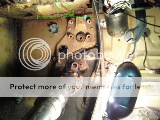

    Well, I made some good progress today. Ripped everything out to give myself some room to work with. Pulled the pedal support bracket off, cleaned it up and painted it, then went to work test fitting the pedals. The cowl floor has to be clearenced a bit, but not much. A little "massaging" with a body hammer to lift it about 1/8"-1/4" and the quadrant clears fine now. All thats left to do for the pedal is drill the hole for the cable, and fab up a firewall brace. Hopefully I can get that done on Friday. At some point I intend to do a writeup on the install, assuming everything goes as planned.
    [​IMG][​IMG]
