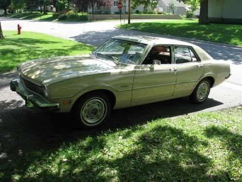

    You have large bumpers. Small bumpers are very thin, and well, small. lol.
