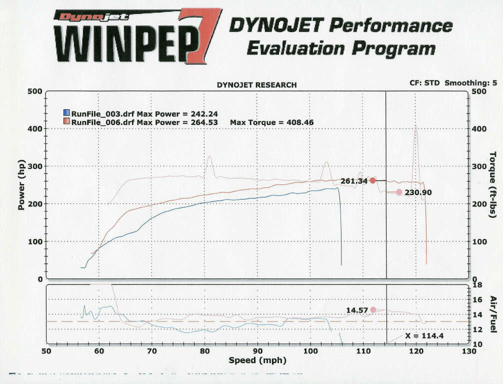

    Mine is a VERY fun 265 hp at the wheels at 5000 rpms, 280 ft/lbs from 3500 on up to 6000 (on a dyno with video to prove it )
    So my estimate is 350-ish hp on the engine. Those are electrical hiccups on the torque curve, so ignore them.

    You lost 85 hp through the drivetrain?

    Isn't 25% loss about right? 350X.75=262.5

    You don't lose "25%" through the drivetrain. If that were true, a 1000 horsepower engine would lose 250 horsepower while a 100 horsepower engine would lose only 25 horsepower.
    There is definitely a loss between the crankshaft and the rear wheels, but to put a specific percentage on it that applies to all cars is totally inaccurate.

    Hmmm. Good point, Crazy Larry.
    Any ideas how much power a 3.80 and C4 consume?
