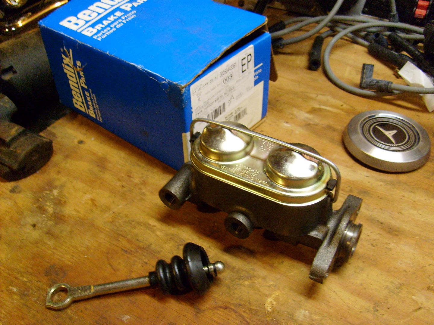

  4. predfan2001
    Got the master cylinder on and brakes bled. I ran into 2 issues with the master cylinder. The first was that it came with 2 push rods and a loose tag in the box that said "Use the rod for Mustangs and Cougars only", but which one? I did some reading here and found where many have removed the master cylinder push rods by twisting and pulling it out...that worked fine on getting my old one out. I compared the lengths and mine was different that the ones that came with the new master cylinder so I reused the original one. Next there were no bench bleeding fittings so it took a little longer to get the brakes bled.
    Then I was finally able to drive it around a little for the first time with brakes. Felt pretty neat. The Craigslist bought 250 seems fairly peppy. Trans seems to shift good other than I noticed a 2-3 shift flair once. The brakes stopped good and straight. I'd say the only issue I found was that I could feel something loose in the steering when I went over bumps. I have new outer tie rod ends already but I need to get under it and check the rest of the stg. I suspect the idler arm is worn.

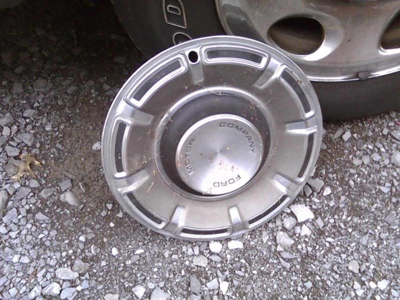

  13. predfan2001
    Not much of an update...but I was at my dads house today and he asked me what I did with the original hubcaps off of the Maverick. I said I probably threw them away in the 80s...then he handed me one of them. It looks like NOS...I hope he finds the other 3. Not that I would use them, just cool to have...they are UGLY!!!! lol
