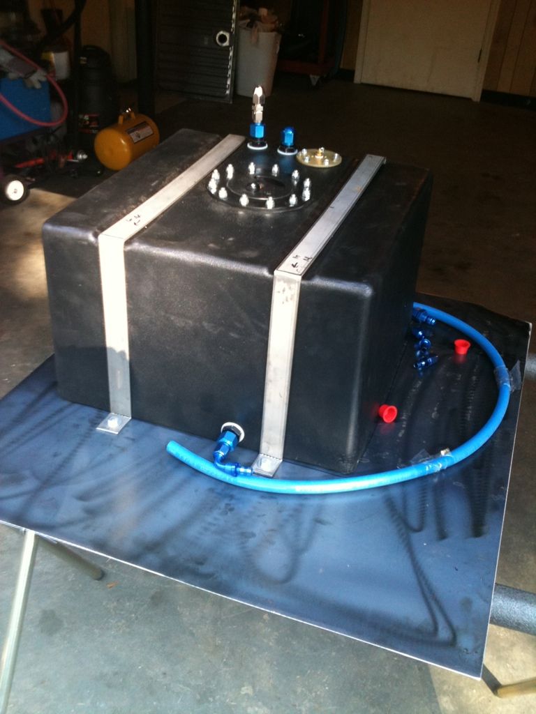

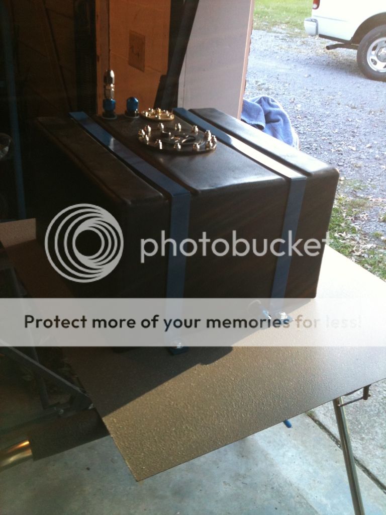

    Got this in today. RCI Pro Street fuel cell. It has a flat bottom. Now I need to get a piece of sheet metal cut to replace where my old tank went and mount this to it. This one has the GM 0-90 ohm sending unit so I will add an aftermarket fuel gauge later. I'll also make a rear firewall behind the seat when I do the interior.

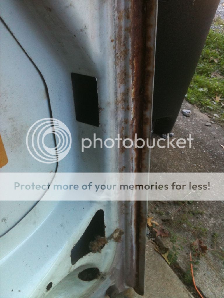

    I also made a deal on a solid deck lid. Mine is fairly rusty at the lip from mouse pee. Gotta keep motivated!

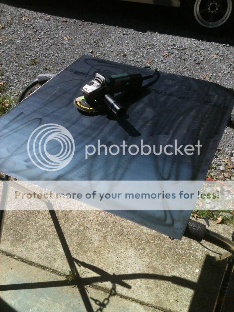

    Got all of the AN fittings and hose ordered to hook up the fuel cell. I'm going today to get a piece of 16 gauge sheet metal sheered to bolt in the trunk floor where the old tank went.

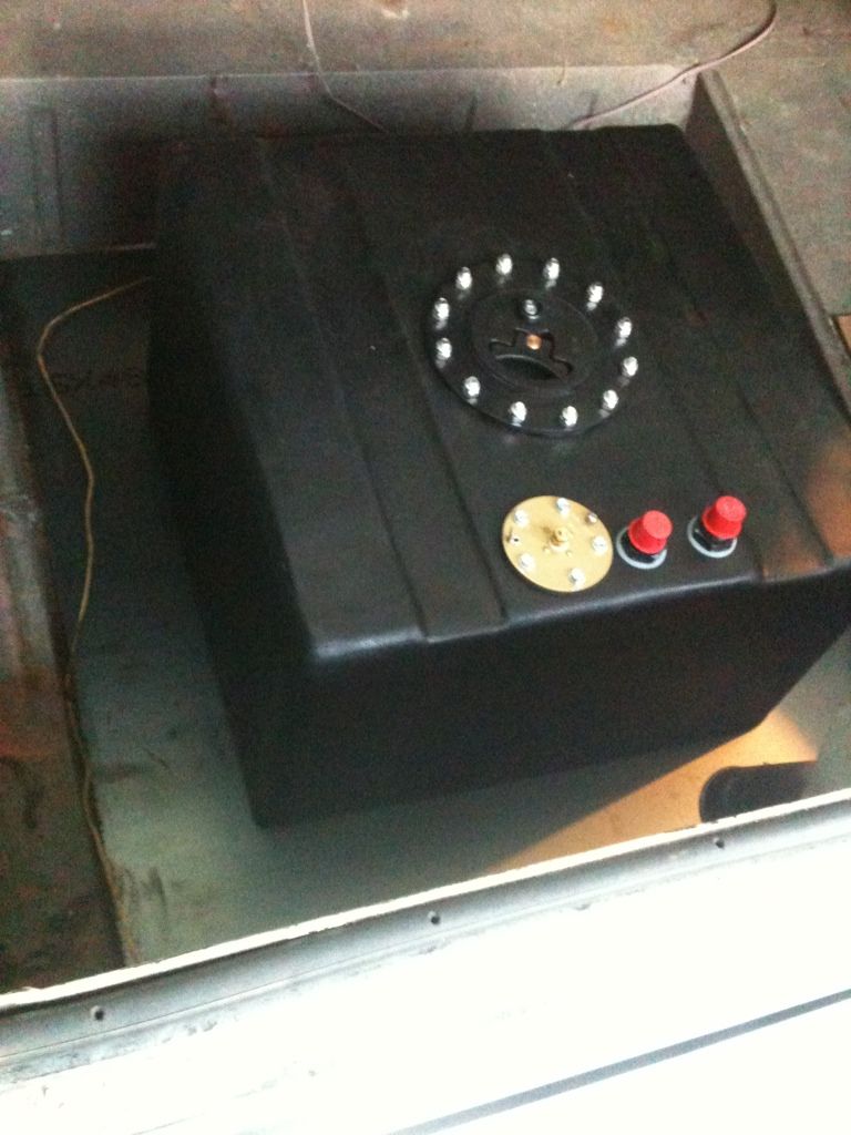

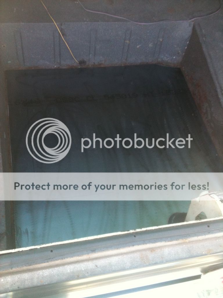

    The metal is going to need some trimming but this gives an idea of the set up. Got the strap metal to make the brackets at Lowes.

    Gonna try to get in a full day of work on the Maverick today. First thing I wanted to do was test fit the trunk I got from 289_4spd. I hate to replace original parts of my car, but I think fixing all of the rust thru along the outer lip of mine (due to mouse pee) would have been trouble than it was worth plus it's a good chance more would come thru later.
    Here's what the inner lip looked like. Not the worst but more rust than I wanted.

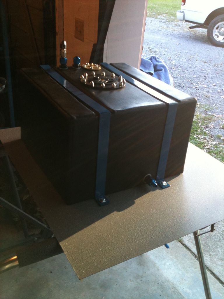

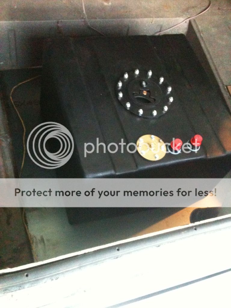

    On to the fuel cell install. I had to trim a notch in the rt leading edge of the insert to clear a place in the trunk floor.
    I marked where I wanted the cell to mount.
    I used a vise, square and a bmfh to bend the cell mounting braces.
    Sort of a mock up. A few things I need to tweak on but you get the idea.

    Nice job on fabbing those brackets, the fuel cell should stay put...

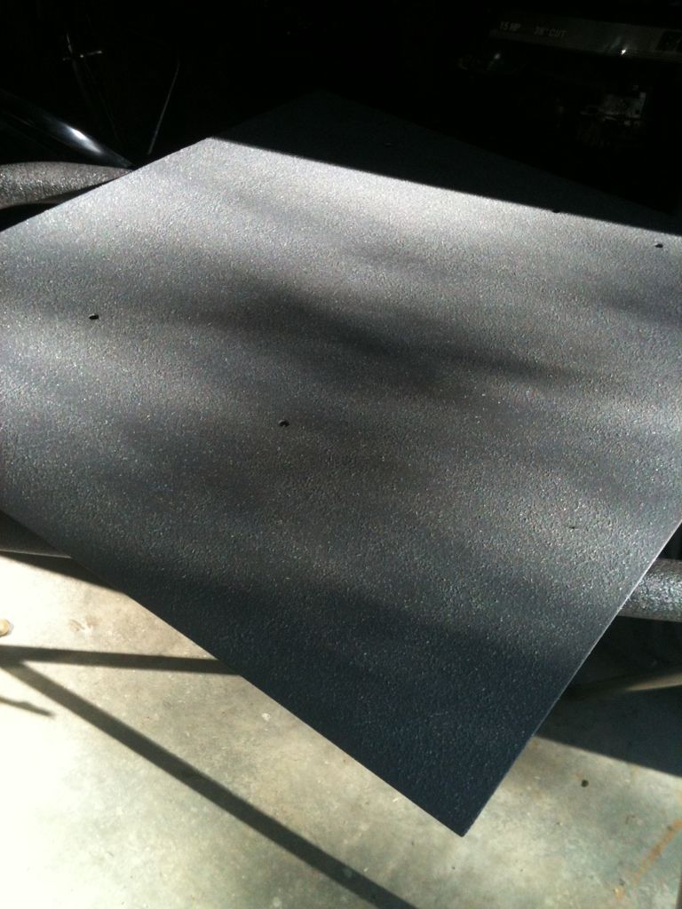

    The trunk filler got a coat of splatter paint. Turned out nice...the shadows are from the trees.
