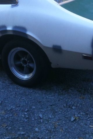

    I'm tired of looking at these rusty quarters so I'm getting ready to start with the worst area first. More mouse pee damage, but there was a nest in the bottom of this quarter and the bottom of the drop and most all of the bottom underside of the quarter is eat up.
    Rather than attempting to form sheet metal in the shape of the bottom of the quarter (where it attaches to the drop), I am going to start with a 69-70 Mustang quarter patch and go from there. It will require moding of course since a Mustang and Maverick have different shaped wheel openings, but since a patch is $24, it seems like a good place to start rather than a piece of flat sheet metal.

    I wish you good luck. I looked into using that piece....and it was just to far off in my opinion to work. I think you would be better off starting out with a flat piece of metal. Also.....3PG is supposed to be getting close on getting the repair panels done for a Maverick. Might want to wait for that (I have no idea how long that would be).

    Craig I recently emailed them and they basically told me there wasn't enough interest in them to start production at this time, but they will come one day. They said they would welcome input from the Maverick/Comet community. They also said the quarter patches would be out by now last year when they announced the floor drops...so I give up on them. I'm not waiting forever.
    As far as the patch, I'm really only wanting the contoured section on the underside. The rest I will fab. For the price it's worth a shot. No big loss if it don't work.

    If you want the lower section of the outside wheel house (inside the rear quarter behind the rear tire)....use the Mustang piece. I used them on my orange car and they fit very well. As far as the outside quarter panel...I think you can fab something that will be closer in shape than the Mustang quarter you had pictured.
