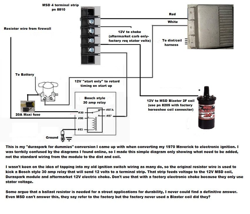

    Ordered a GM fuel gauge (0-90 ohm) today to mount under the dash next to my coolant temp gauge. Changed my mind about trying to modify a Ford sending unit and opted just used the sender that came in my fuel cell.
    Also ordered a MSD 12v coil and the rest of the parts I need to button up the Duraspark ignition conversion.

  3. predfan2001
