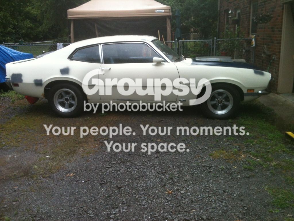

    Move it outside so I could clean up the garage a little. I think I'm sold on the hood scoop but not the chin spoiler.

    Looking good! I like it without the chin spoiler (y)
    If EVERYONE starts putting those on, wont be so unique anymore :bouncy:
