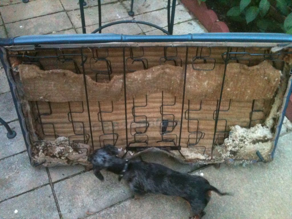

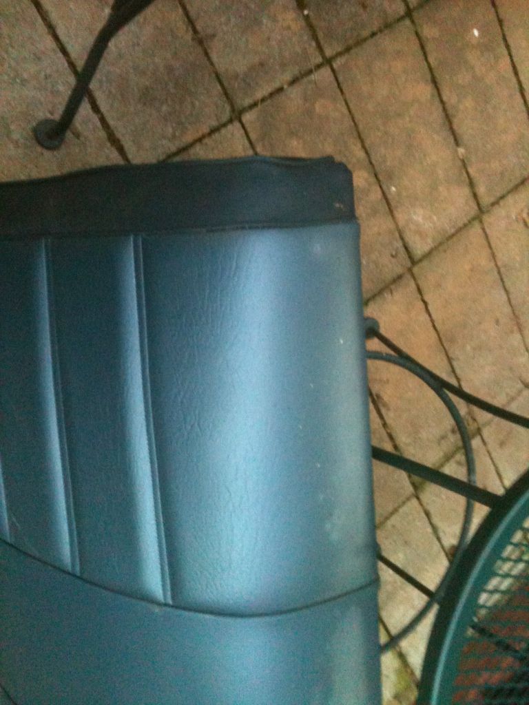

  2. predfan2001
    Since the interior freshen up will be next, I pulled the rear seat back out to send to the trim shop. When they made and installed inserts to mimic the 71 Mustang bucket covers in the frt back in the early 90s, they left they original vinyl on the sides. It didn't old up too well to the sun and heat over the years. I think the rest will be ok but I'm going to have them completely re-do the seat back....or at least the pieces they didn't replace the first time.
    Oh look, my dog found more mouse nests. :(

  4. predfan2001
    I told the trim shop that it's no rush on the seat back, but they called me today and said they'd have to completely recover the seat back (the material is too sun dried on the top) but they were having trouble finding what material 70 Mavericks had. So I had to explain what I had them do 15 years ago....recover the back seat to match my new 71 Mustang standard bucket seat covers in the frt. He said that makes it alot easier. Hopefully should get it back soon.

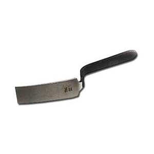

  5. predfan2001

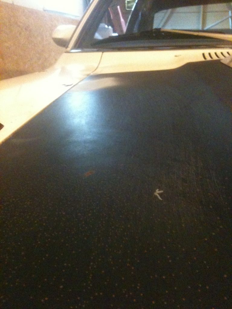

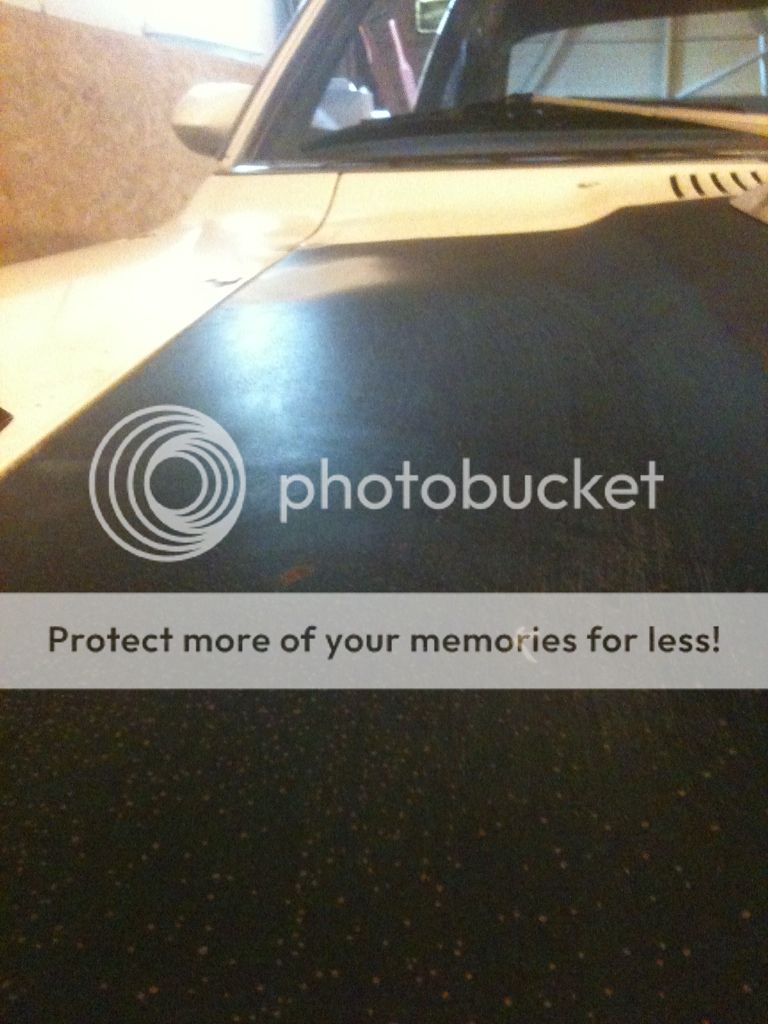

    My hood is rust free but it has a pretty nasty in/out dent on the passenger side (can be seen a few pics up ^^). I was worried about the metal stretching if I beat it with a body hammer so I went the old school direction and bought a spoon hammer...some call them a slap hammer or a dinging hammer.
    From what I've been told, there is little stretching and they may even shrink the metal somewhat. I bought one and gently started slapping the metal making sure to keep a flat contact point. It's a slow process but from what I see it did a nice job. The entire area is now 90% flat but it will need a little more finessing.

  7. predfan2001
    Picked up the seat back today. Looks great other than maybe a little too light. They used vinyl they had in stock, special order would've been quite a bit more. Close enough.

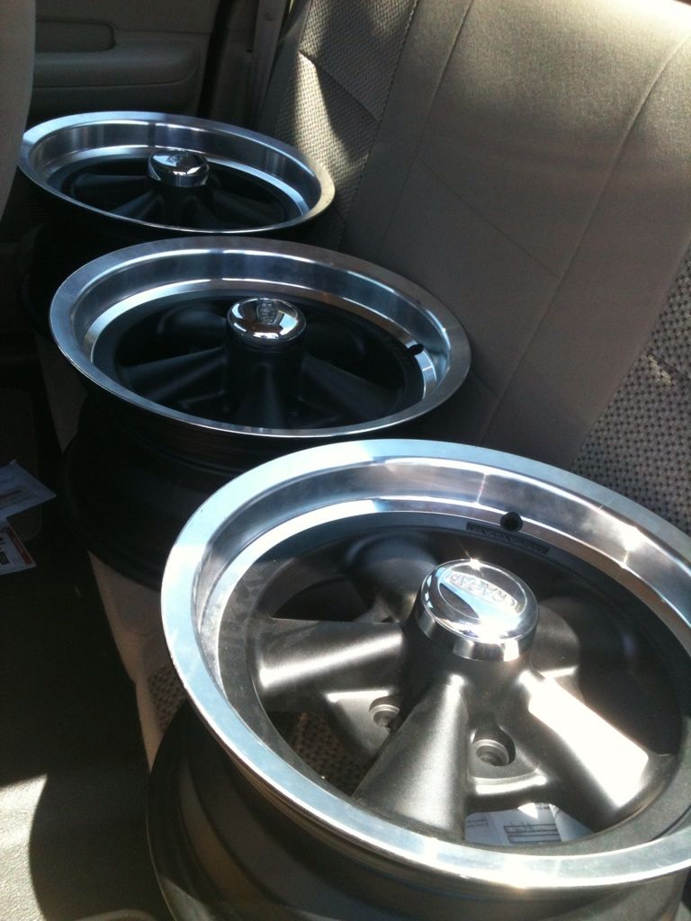

  8. predfan2001

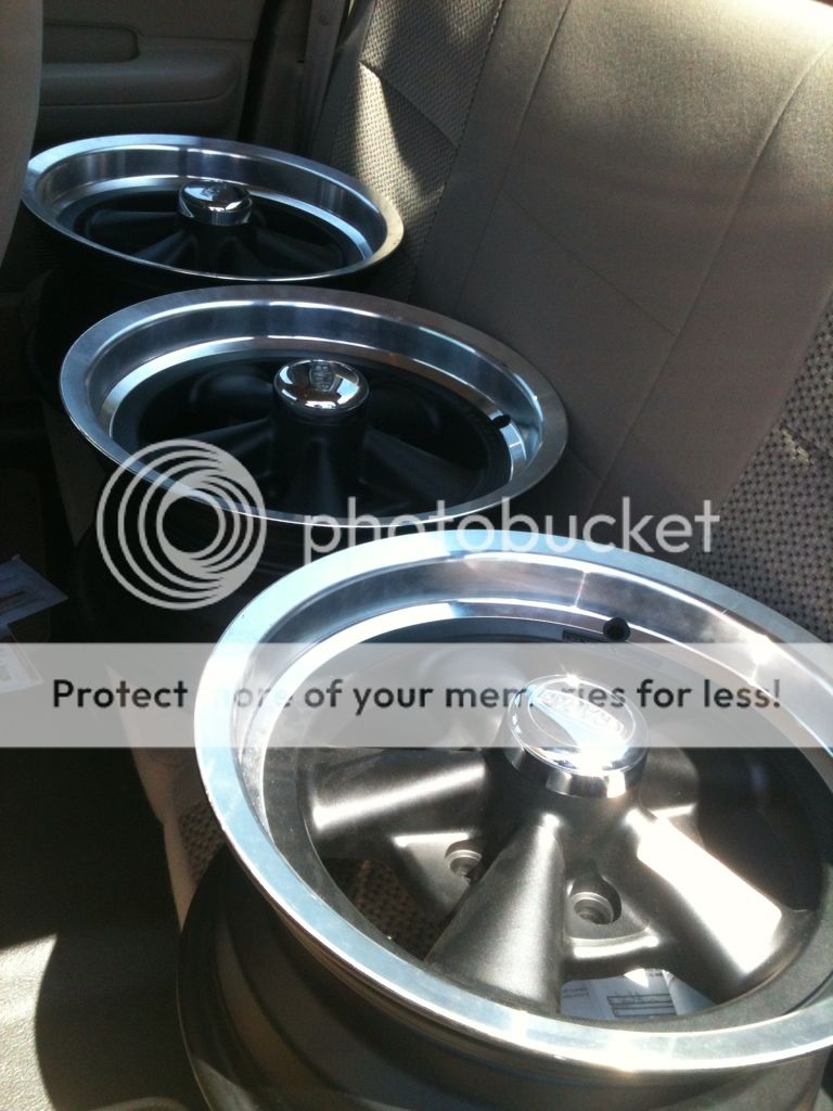

    No updates....too hot to get much done the past month but I did pick up some wheels. Not sure if I'll use them on the Maverick or not. $35 each at a local Essex wholesale outlet but they only had 3.
    15X7 4.5 one piece alloy Cragars.

    Nice wheels.....now to find another. You gonna paint them or polish them?
  10. predfan2001
    Thanks. The centers of these are black, but I'd paint them gray. These are actually the style wheels I ordered for my 68 Mustang to begin with but received these instead.
    These are 2 piece with a chrome steel rim an alloy center.

  13. injectedmav
    injectedmav Member
    Sep 15, 2006
    2,114
    Georgia
    Are you sure you have Ranger rotors? Both Rangers I've had 91, 04, have had 5-4.5 in bolt pattern.
  14. Derek 5oComet
    Derek 5oComet Tire burner
    Dec 4, 2005
    1,629
    Welland,Ontario,Canada
    Jack up the stang and try them on it.If they fit they are right,if they dont the other guy measured wrong.
